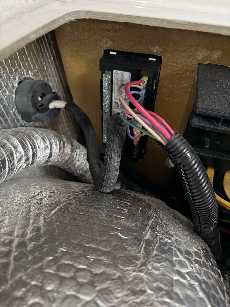

GeoffChapman Posted November 27, 2025 Author Posted November 27, 2025 Need some more guidance, please. I'm not very experienced at electricity, but I am game if it is safe. Forget the Jackery. Can I use one of my 12v lithiums instead? "With all other loads turned off (as to not overload the Jackery) just hook your Jackery neg to the ground buss with all the yellow wires, and the Jackery positive to the big red wire input of your 12 volt fuse panel . Your pump will then operate as normal. " Looking carefully - here's my shot at a safe 12v power disconnect the 120v land line take one of my lithium batteries, turned off and use a jumper cable, connecting the: negative to the 'ground buss with all the yellow wires' and positive to the naked bus on the far side of the 12 volt fuse panel? (left side of photo) turn lithium battery on turn off all 12v lights, etc turn on water pump and finish the winterizing Is this good? Corrections? Happy Thanksgiving!!! Geoff and Becca Chapman * Pittsburgh Legacy Elite 1 Hull #731 * TV 2024 Ford Ranger Turbo 2.7L Ecoboost V6

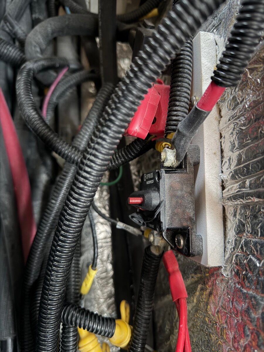

GeoffChapman Posted November 30, 2025 Author Posted November 30, 2025 (edited) What is this switch? Might it cut off the 12v system? Edited November 30, 2025 by GeoffChapman Geoff and Becca Chapman * Pittsburgh Legacy Elite 1 Hull #731 * TV 2024 Ford Ranger Turbo 2.7L Ecoboost V6
Moderators topgun2 Posted November 30, 2025 Moderators Posted November 30, 2025 52 minutes ago, GeoffChapman said: Is there a fuse I've thrown - or a switch on the inverter that needs to be pushed to make the 12v system come on? Yes, It is likely that you have "tripped" one (or both of the "breakers" that look exactly like the one in the picture you post right above this post. If either of the two of those are tripped then you should see a little yellow "flag" that will stick out the side of that black plastic. In order to reset it all you have to do is push the little yellow flag back in. Bill 1 2 2023 Ford F150 Lariat 3.5EB FX4 Max Towing, Max Payload, 2016 Oliver Elite II - Hull #117 "Twist" Near Asheville, NC
GeoffChapman Posted November 30, 2025 Author Posted November 30, 2025 (edited) Bill, thank you!! The fuse on the side of the battery compartment (not the one in the photo) had been tripped. Reset it and Success!! Pump and the rest of the 12v system came on. Winterization is now complete. Thank you all!!! Edited November 30, 2025 by GeoffChapman 1 2 Geoff and Becca Chapman * Pittsburgh Legacy Elite 1 Hull #731 * TV 2024 Ford Ranger Turbo 2.7L Ecoboost V6
