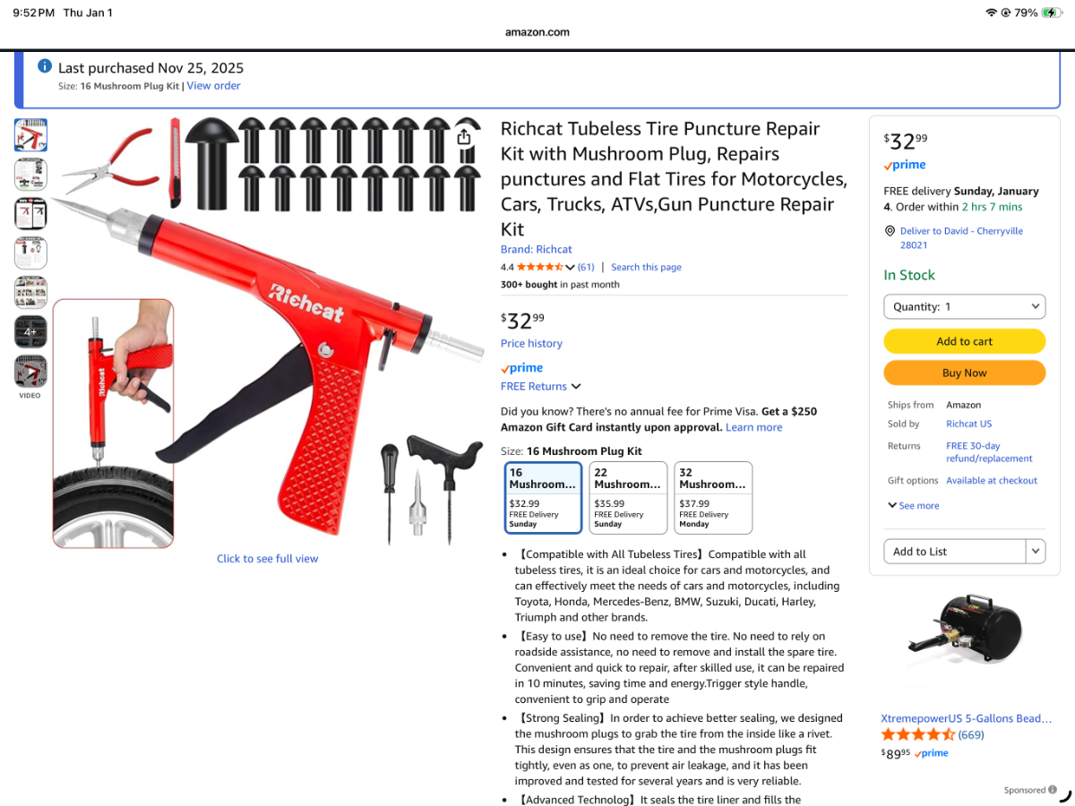

Used "The Stop & Go" Tire plugger with mushroom plugs like David uses. Plugged motorcycle and small trailer tires with it so far, worked well. Mine does not have the tool with pistol grip handle like David's kit, but they have them with or without pistol grip hand tool on Amazon.
Really like mushroom plugs.

I also have the mushroom plug kit.  I've never been able to make them work but may be bad technique on my part.
