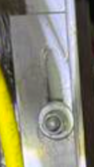

I suspect that the root cause is the slotted two piece stiff-leg that was utilized for installation & adjustment purposes.  I am concerned by several aspects of the picture:
  • All structural two-piece columns must utilize at least two GOOD bolt connections. Single Point of Failure Rule.
  • There does not appear to be sufficient aluminum angle to angle overlap.  A two piece structural column must have significant overlap to allow for both compression and angular deflections.
  • The slot appears to have been hacked into the angle, not milled.
  • Only having a single bolt.  This allows the connection to act like an "elbow".
Combined the above structural member could not effectively resist the battery and tray mass from moving out of the trailer.
If it were mine, I would take a magic marker and physically strike the top of the lower angle for use as a witness mark.  Then unload the batteries and determine at what height the support plate requires for proper elevation, flush alignment for the horizontal rivets, and to (hopefully) provide a slight slope to the outside for drainage.  I would also add 1/8" in height for grins.
Then of course add two bolts for permanent fitment.
GJ

After seeing this thread I decided to check my battery support this morning. I really didn't expect to see any problem, but I received a surprise. My battery box support had two holes with no bolts. After some searching I found the bolt heads peeking out from around the wiring harness and after getting those I lifted the wiring harness and found the nuts. The idea of using a small bottle jack in this thread worked for me. I was able to place a 4 ton jack in there and raised the bracket until the holes were aligned enough to start the bolts, but I could not get them to go all the way. The angle of the bracket was off. I chose to use a small c-clamp on the bracket going from curb side to street side, that allowed the bolts to go through enough to get the nuts started. Finished it up with some blue Loctite on the threads.  I have enclosed some photos of the repair.
Finding this on my one year old Oliver was not expected. I would encourage everyone to check this support bracket on your Oliver to prevent future problems.
David, excellent work and thank you for proving my hypothesis re the bottle jack and that some lift will be required to set the battery box straight.

Some have reported missing nuts, or nuts falling off the bolts. (How does a Nylok nut fall off a bolt? It doesn't. It was likely laid there never threaded on. Go figure.)
For David and Gail's case, you nailed that one!
How?  My guess is it was a long week and on Friday late the installer laid the bolts on the floor with a "I'll get it Monday".
