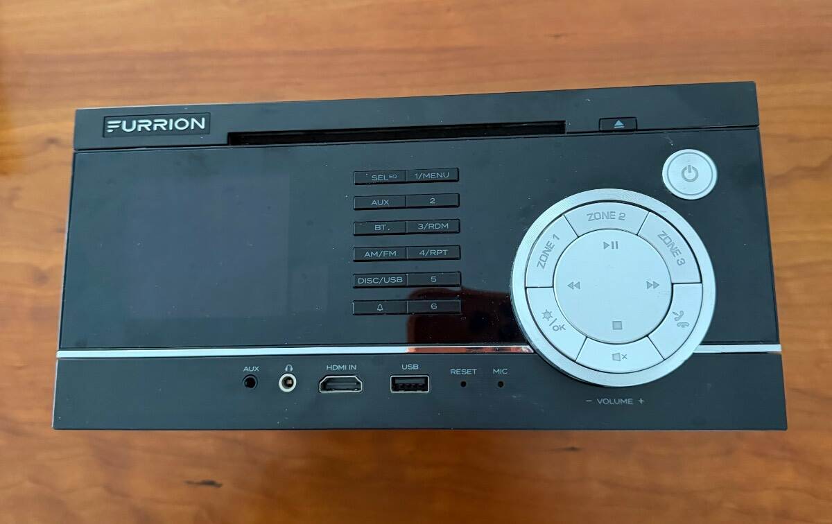

I’ve never liked the Furrion DV1230 entertainment center, it’s not user friendly and the front panel is difficult to read in low light. The tiny remote is absolutely terrible, and the larger upgrade remote isn't much better.  I usually control it with the phone app when I remember where to find it, for some reason they called it "ES Control,” and it constantly drops out.  The tech is outdated.
Iv’e wanted to upgrade it for years, but never found a unit that met my requirements and justified the expense:
  • Has to fit into the existing cutout (7-3/8" x 4")
  • Controls that are intuitive and easy-to-read
  • Decent remote control
  • HDMI ARC ports on front and back (not the cheap HDMI pass-through ports)
  • Current Bluetooth technology
  • Two speaker zones
  • Cost under $200
I found IRV Technology’s model IRV62 for a $180, and it had everything I wanted.   https://a.co/d/0dODdwBi  The controls couldn’t be simpler or easier to read.  It does have a few less features than the Furrion, but nothing that will be missed.  Like only 2 speaker zones compared to Furrion’s 3 and the Optical audio port that caused horrible sounding audio phasing issues between TV and stereo speakers.
The IVR62 was a close fit on paper.  But unfortunately Oliver had cut an oversized opening for the Furrion and miss-drilled extra mounting holes.  Consequently, the new faceplate didn’t quite cover the extra holes, and the new mounting holes were on the very edge of the cutout.  This was resolved with white JB weld on the edge of the oversized cutout to strengthen the screw holes, and I made a thin 3-D printed bezel that covers the extra holes.  It’s not even noticeable.  The print file is available if anyone has the same problem, or I made extra bezels if anyone needs one.
The rest of the installation was easy, although it took a minute to figure out how the Furrion was mounted.  There are 4 screws behind top and bottom trim pieces.  These trims have small notches on the ends where they can be popped off with a screwdriver.
It’s highly recommended to identify and mark each of the 4 speaker cables before cutting the connections.  Use the wire color code legend on the back of the Furrion case to identify the right rear, left rear, right front, and left front.   Also the IRV’s yellow “Bat” wire and the fused red “+12” wire are both connected to the Olivers hot wire, which was purple in my case.  Other than that, the wiring is straight forward.
The new stereo is so much easier to use, it works seamlessly with Bluetooth and the TV, and it sounds better too.  I’ll be using it more often now that I don’t need a flashlight and reading glasses to operate it.

Yesterday I was working in the Oliver, fixing a couple of drawers, replacing the Blum undermount drawer slide on one and new orange latching ends on another. Because of your post, I thought to fire up the Furrion, listen to a local FM station while working.
Yes, I needed the flashlight on my phone and it took me 5 minutes to figure out the interface! When we travel, Chris is usually the one to operate the Furrion stereo. She will pair it to her phone, or sometimes at dinner she will play a travel CD she burned for our trip. Kudos to her for learning to operate this crazy box.
Your IRV62 looks much better and you can just look at the front panel picture to see the simple buttons make sense, are intuitive. If they only made one in white or gray! When searching online for wall mount RV radios, you'll find nothing but BLACK! I did find a Jensen model that would fit the larger opening cut into our hull.
In our 3-zone system, Zone A are the front speakers, Zone B for the rears and Zone C is not wired to anything. Yep, for the 4-speaker Oliver configuration two zones is all you need. It would be nice if Zone C was wired to two exterior speakers.
But, the Oliver really needs a special zone! One that when eating dinner the speaker over my head is not powered on! Just bad placement. I would rather they had mounted both left and right front speakers above the closet. And sound from the rear speakers pointing down is lost in the bedding. Speakers left and right of the attic door would certainly produce better sound.
