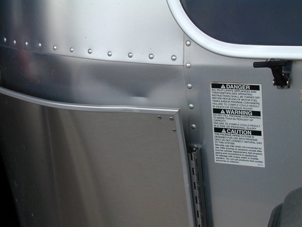

BoondockingAirstream Posted September 29, 2016 Posted September 29, 2016 The Tundra 5.7L is very capable and reliable tow vehicle. I have towed heavier trailers... but did not like the cargo capacity being at or exceeded once the trailer was loaded. Just something to mention. When I went from the smaller 2006 Tundra to a 2012 Tundra there was one small item not mentioned. The tail lights on the 2012 Tundra 'bulge out' and with the 'chain Equalizer' hitch at a sharp angle would make contact with the side of the trailer. At least with the Airstream. Learned the 'hard way', once and that was once too many. Even the tail gate can be an issue. I needed to rotate the Airstream hitch jack control box on top, so the post 2006 Tundra tail gate would clear. This may not be the case with an Oliver... but this may have been discussed on the Forum. A friend had an Arctic Fox 25 foot and discovered that the 2012 Tundra tail light broke through his fiber glass shell on a tight turn. When I told him about my experience... he admitted to his at the same time. We both felt... dumb, but his 2000 Tundra was his previous tow vehicle. Newer Tundra's, I do not know which year, changed to tail lights that did not bulge out. Someone may know. An Oliver may not be affected depending on the brand of hitch, but keep this in mind. My current Equalizer Hitch with the 1000# sway bars clear, with room to spare towing with the F350. Whew....
Overland Posted September 30, 2016 Posted September 30, 2016 The tail lights on the 2012 Tundra ‘bulge out’ and with the ‘chain Equalizer’ hitch at a sharp angle would make contact with the side of the trailer. I don't know what it is with the bug eye headlights and taillights on Toyotas these days. They're just asking to get busted up and frankly, who thinks that's a good look anyway?
