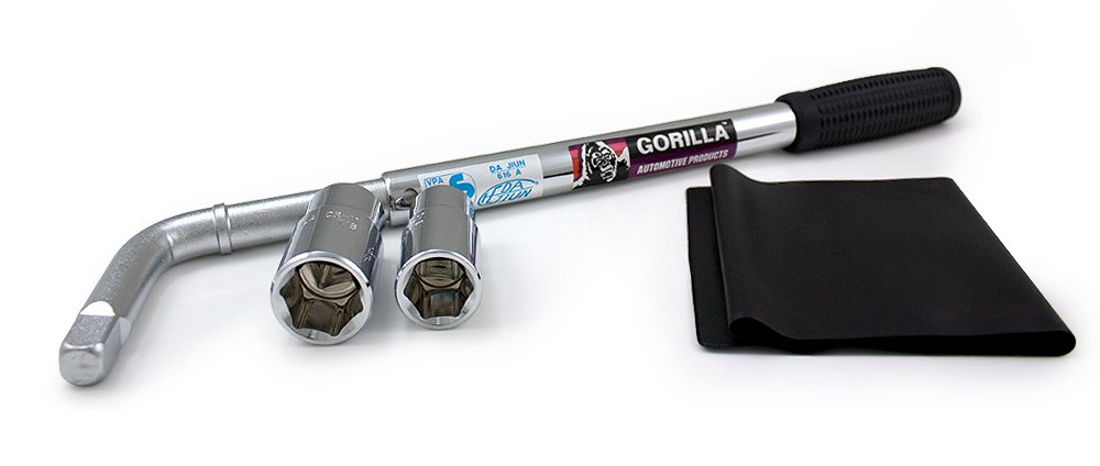

John E Davies Posted January 22, 2017 Posted January 22, 2017 Every vehicle I own has one of these in the trunk or where-ever. It is extremely stout at full length, but telescopes to a compact length for storage. I strongly recommend this, just be careful tightening so you don't over do it. A torqye wrench is advised for that. One of the four sockets included will fit your Oillie, I think. https://www.amazon.com/Gorilla-Automotive-1721-Telescoping-Wrench/dp/B000CMJ2KU John Davies Spokane WA 1 SOLD 07/23 "Mouse": 2017 Legacy Elite II Two Beds, Hull Number 218, See my HOW TO threads: Tow Vehicle: 2013 Land Cruiser 200, 32” LT tires, airbags, Safari snorkel, Maggiolina Grand Tour 360 Carbon RTT.

Raspy Posted January 22, 2017 Posted January 22, 2017 Every vehicle I own has one of these in the trunk or where-ever. It is extremely stout at full length, but telescopes to a compact length for storage. I strongly recommend this, just be careful tightening so you don’t over do it. A torqye wrench is advised for that. One of the four sockets included will fit your Oillie, I think. https://www.amazon.com/Gorilla-Automotive-1721-Telescoping-Wrench/dp/B000CMJ2KU John Davies Spokane WA John, I have a couple of those Gorilla wrenches too. Nice. But be sure to check if the socket actually fits the Ollie decorative wheels nuts. Some cap nuts stick out enough to block that Gorilla shallow socket from engaging the hex. If so, just get a standard deep socket and drive it with the Gorilla wrench. John "I only exaggerate enough to compensate for being taken with a grain of salt." LE2 #92 (sold), Black Series HQ19
