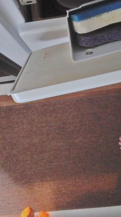

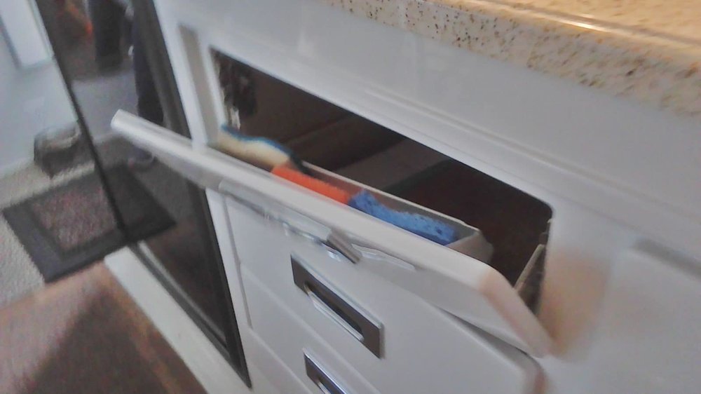

And now...
Karen went to open the sponge drawer and...
How the heck am I supposed to get screws back into that corner? This short screws in the cabinet issue, is really getting rediculous... I'm going to have to pull all of the drawers, then play gymnast, to try and getto these to put it back together...
Where's the quality we paid so much money for?
