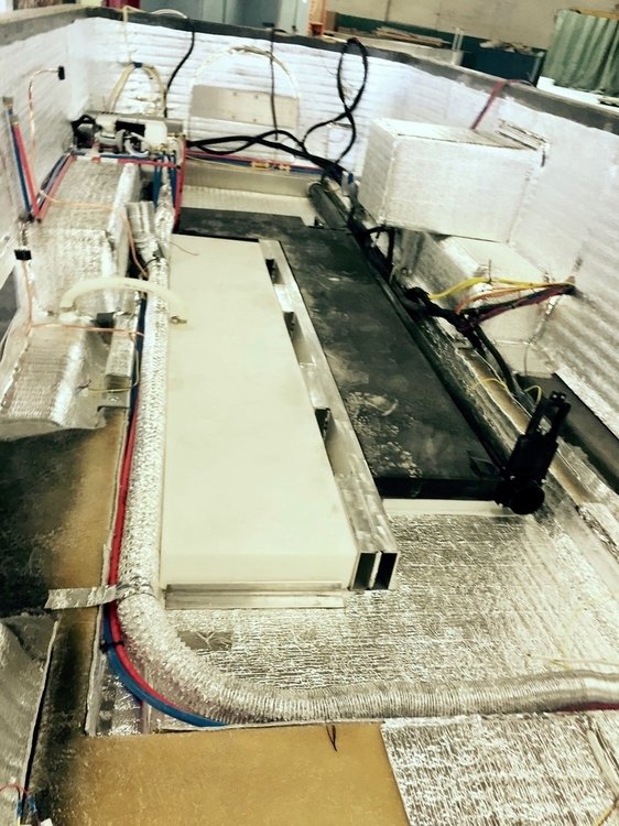

Overland Posted April 27, 2017 Posted April 27, 2017 John, here's a picture of the vent. You can see that it makes a simple bend and exits in front of the wheel well. I don't know what sort of screening is on it. Until Reed mentioned it, I hadn't thought about losing water, but as part of my effort to make the lower hull more water tight, I had planned to make some sort of cap for the vent to prevent possible contamination in the case of a water crossing, and/or perhaps moving it to a higher location on the side wall. You could also potentially lengthen the hose to give it a deeper bend. 4

rideandfly Posted April 27, 2017 Posted April 27, 2017 Can a boat drain plug be used temporarily to save water? Believe this is the vent: 2015 LE2 #75 / 2024 F-150/STX/5.0L

Overland Posted April 27, 2017 Posted April 27, 2017 For most people and most trips it shouldn't be an issue, but if you arrive in the middle of nowhere with a day's less water than you'd planned, then John is correct - it would be a big deal. That's pretty much our reserve when we camp. Capping or plugging the vent likewise shouldn't be a problem in most situations, but it is something to keep in mind if you're someplace with large temperature swings, in which case you might want to make sure that you vent it once or twice a day as you would with unvented fuel cans. I suppose leaving a tap open would accomplish the same thing. From Bill's pic is looks like a plug might do the trick, maybe fixed with a chain so that it isn't lost. I don't see a screen at all - all the more reason to filter your drinking water I suppose.

Raspy Posted April 27, 2017 Posted April 27, 2017 That overflow hose is just forward of the sink cabinet. If you could reach it and extend it up under the sink with a vented loop, as high as you could, under the sink, and then back down to the outside it would make a big difference. Maybe it can be reached through the outside louver behind the refrigerator. Plugging it is a bad idea because sooner or later you'll forget the plug and pressurize the tank. Also, if it had a spring check valve at the outlet no dirt or bugs could ever go back up the pipe to the tank and the vented loop would let in air to allow the tank to drain. The vented loop is simple sailboat hardware. Adding a vacuum breaker to the loop would make sure no water ever burped out of the loop. I haven't noticed any loss of water, but I guess it might be worth a test. Fill the tank completely, go on a rough road, and before using any water, re-fill the tank to see what was lost. That vent system shown in the picture looks like it would allow some loss. 2 John "I only exaggerate enough to compensate for being taken with a grain of salt." LE2 #92 (sold), Black Series HQ19
Try2Relax Posted April 28, 2017 Posted April 28, 2017 Maybe it can be reached through the outside louver behind the refrigerator. The floor in the fridge area is solid front to back, there is no access to below area. So I would not recommend dismantling how well sealed that area is for proper fridge heat venting and isolation. You can cut an access hole in the bottom of the kitchen drawer area all the way to the left about 6" back. This is actually a good idea as that is where everything under there passes by water, heat, propane, electrical, etc. 1 Randy One Life Live It Enjoyably 2017 F350 6.7L SRW CC LB 2015 Oliver Elite II Hull #69
rideandfly Posted April 28, 2017 Posted April 28, 2017 Raspy wrote: Maybe it can be reached through the outside louver behind the refrigerator. The floor in the fridge area is solid front to back, there is no access to below area. So I would not recommend dismantling how well sealed that area is for proper fridge heat venting and isolation. You can cut an access hole in the bottom of the kitchen drawer area all the way to the left about 6″ back. This is actually a good idea as that is where everything under there passes by water, heat, propane, electrical, etc. Fine ideas! 2015 LE2 #75 / 2024 F-150/STX/5.0L
Overland Posted April 28, 2017 Posted April 28, 2017 The floor in the fridge area is solid front to back, there is no access to below area. So I would not recommend dismantling how well sealed that area is for proper fridge heat venting and isolation. You can cut an access hole in the bottom of the kitchen drawer area all the way to the left about 6″ back. This is actually a good idea as that is where everything under there passes by water, heat, propane, electrical, etc. Not a bad idea at all to have that access panel. I'm curious where that photo was taken. Do you have a team of camera equipped mice working for you? 1
