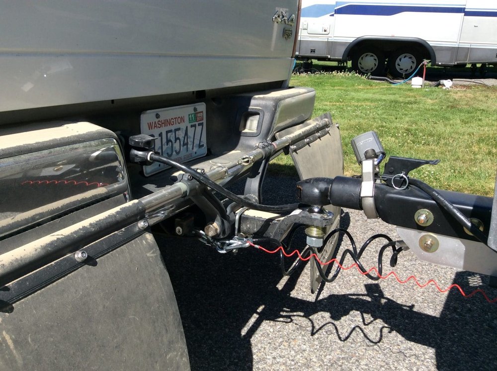

1 - You don’t need a WD hitch, any HD pickup will be fine with a regular 7500 pound rated, 2 inch ball with an appropriate drop to give you about a 24 inch height with a normal load in the bed. There are many folks here towing with big trucks and dead weight hitches. I towed with a Ram 3500 and it did not really notice the tongue weight. No noise either, but I used a clamp-on hitch quieter thing, to eliminate all the play in the receiver hole.
Notice that I used an extended shank ball, intended to go through a bumper, and I added a stack of Grade 8 washers. I thought I might want to fine tune the tongue height by rearranging them, but in this instance it wasn’t needed. It is nice to be able to adjust the ball in approximately 1/8 inch increments to get it dialed in 100%... Don’t use plain washers, they need to be hardened.
