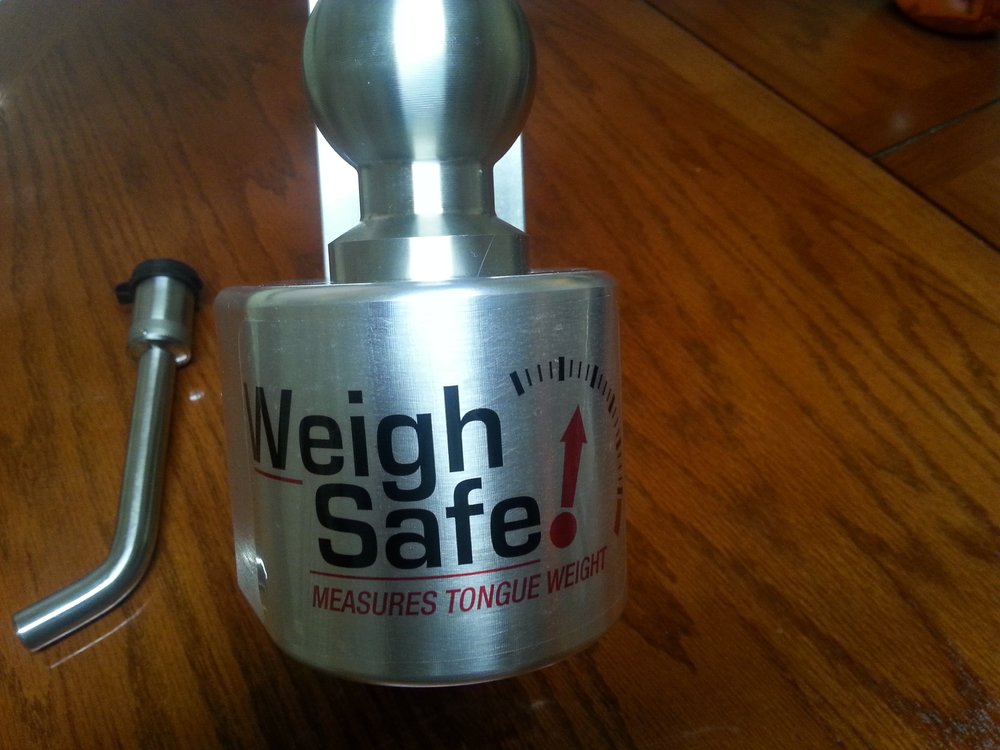

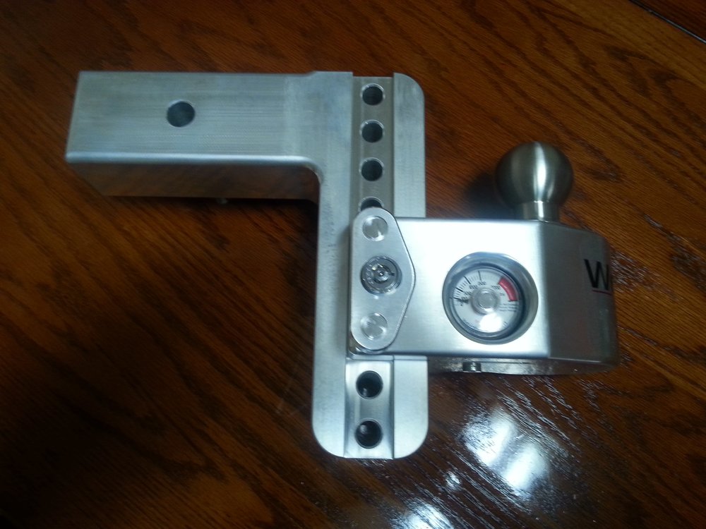

MrBig1 Posted November 17, 2017 Share Posted November 17, 2017 I've been searching the internet looking for a hitch to tow my soon to be Oliver. I wanted something tough, adjustable and I only wanted to buy one. My TV has a 2 1/2" hitch receiver so I also wanted one that size. My thinking on that was, I had really never seen a 2 1/2" hitch system so I figured that may keep down theft, I don't know. I've read about and experienced the hassles of properly weighing my rig and determining tongue weight of a RV. Well I stumbled across a unit made by a company called Weigh-Safe and was intrigued. It turns out that they sell a heavy-duty hitch with a built in hitch scale. I bought my unit from e-trailer it arrived in just a few days and I am very pleased with its construction. I'll post a few pictures cause I think its cool. I also bought the keyed alike hitch positioner and lock. 6 2 Ray and Betty Jo Bayless Our two pups Muffinz and Maddie 2018 Chevy Silverado 2500 Duramax 6.6 liter 4WD Crew 2018 Oliver LE2 Twin Bed, Hull #322, Our Igloo on Wheels Link to comment Share on other sites More sharing options...
Moderator+ ScubaRx Posted November 17, 2017 Moderator+ Share Posted November 17, 2017 For your build, you should specify the bulldog coupler #028462. This one is exactly like the standard Oliver hitch except it is made for a 2 5/16” ball. I’m going to buy this same ball mount and swap my hitch out. It appears you got the 6” drop? Did your truck need that much? 1 Steve, Tali and our dog Rocky plus our beloved Storm, Maggie, Lucy and Reacher (all waiting at the Rainbow Bridge) 2008 Legacy Elite I - Outlaw Oliver, Hull #026 | 2014 Legacy Elite II - Outlaw Oliver, Hull #050 | 2022 Silverado High Country 3500HD SRW Diesel 4x4 Link to comment Share on other sites More sharing options...
John E Davies Posted November 17, 2017 Share Posted November 17, 2017 What are the warranty terms for the scale part, and can you buy that part separately (or the orings) when it starts to leak hydraulic fluid? I would be really worried that having the coupler come down with a bang could wreck it. The ones that are not built-in like yours are known to be a little fragile (the gage itself, not the plunger and housing), and sometimes sticky operating after storage. Do you tow other heavy trailers? If so your hitch should be a very useful addition. For an Ollie, not so much. Do they offer a smaller version with a 1000 pound scale? I really like the appearance of a forged and polished aluminum hitch, like yours and my Anderson, but I don’t expect them to look very pretty after years of use (especially in winter), and you can’t just recoat them with spray paint. There are a lot of specialty hitches and couplers that appear with claims of revolutionizing towing, and many of the makers fold after a few years. It is really hard to tell when a new design is going to be a success.... please post a towing report and a few long term followups. You are rightfully concerned to be wary of theft. That is a gorgeous hitch, and you should always remove it from the truck when not in use! John Davies Spokane WA 2 SOLD 07/23 "Mouse": 2017 Legacy Elite II Two Beds, Hull Number 218, See my HOW TO threads: Tow Vehicle: 2013 Land Cruiser 200, 32” LT tires, airbags, Safari snorkel, Maggiolina Grand Tour 360 Carbon RTT. Link to comment Share on other sites More sharing options...
John E Davies Posted November 17, 2017 Share Posted November 17, 2017 Found the warrant terms. One year on the gage (“accurate to 50 pounds”), lifetime for the rest. They do not mention ball wear, but I bet it is not covered. https://www.weigh-safe.com/warranty/ Like the Anderson, they require you to pay shipping and send it in for evaluarion. If you are mid-journey and have an issue, you are screwed for a week or more. If you have a HD truck, it would be smart to have a standby steel hitch and ball in case your super duper one fails. Otherwise you might be parked for a while while it gets resolved by the maker. Just saying.... FYI a 1000 hitch scale is accurate to 20 pounds. John Davies Spokane WA 1 SOLD 07/23 "Mouse": 2017 Legacy Elite II Two Beds, Hull Number 218, See my HOW TO threads: Tow Vehicle: 2013 Land Cruiser 200, 32” LT tires, airbags, Safari snorkel, Maggiolina Grand Tour 360 Carbon RTT. Link to comment Share on other sites More sharing options...
