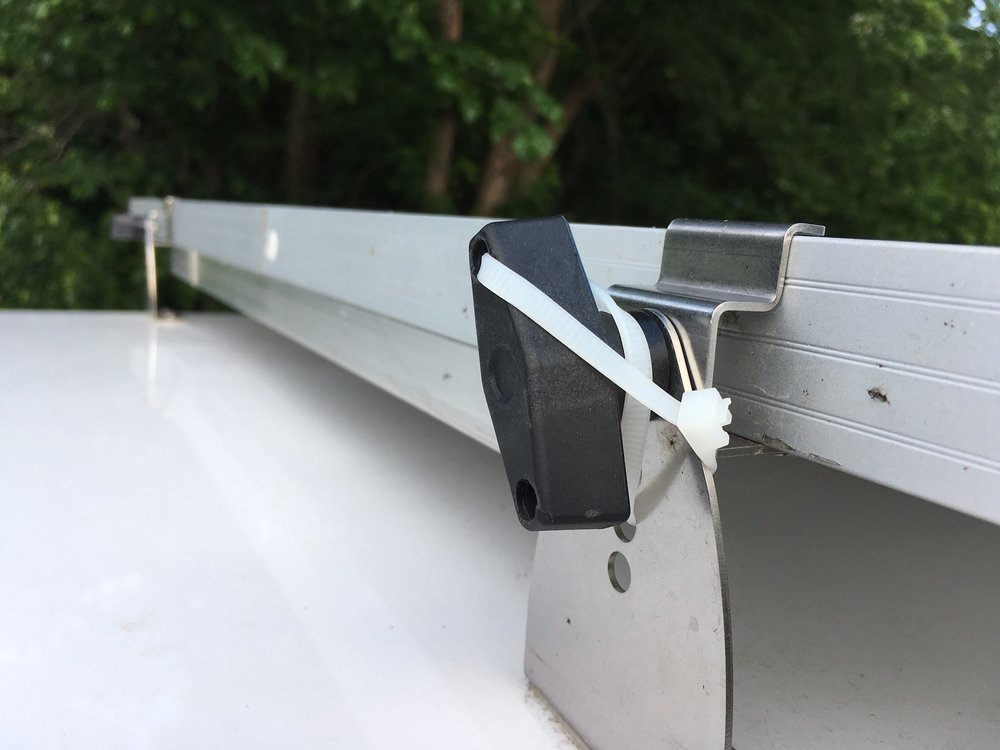

Try2Relax Posted December 12, 2017 Posted December 12, 2017 The panels are made for the outdoors and can withstand quite a bit, there are many in sand wind storms, your cleaning show off will not scratch them to a point of concern. My concern is that the mount points are actually quite small and the extra weight over the coverage of the entire panel can add a lot to those points. There is micro cracking around them on my trailer (I forget what it's called) If leaving flat and level, I would clean them off if more than 4-6 inches. If you tilt one side up, I would think they'll clean themselves easy enough. The panels are dark so any sun on them will cause them to heat up, so even if you only clean what you can reach easily, the rest will melt faster. I haven't yet, but I'll clean off after today is finished. (They're flat) Randy One Life Live It Enjoyably 2017 F350 6.7L SRW CC LB 2015 Oliver Elite II Hull #69
