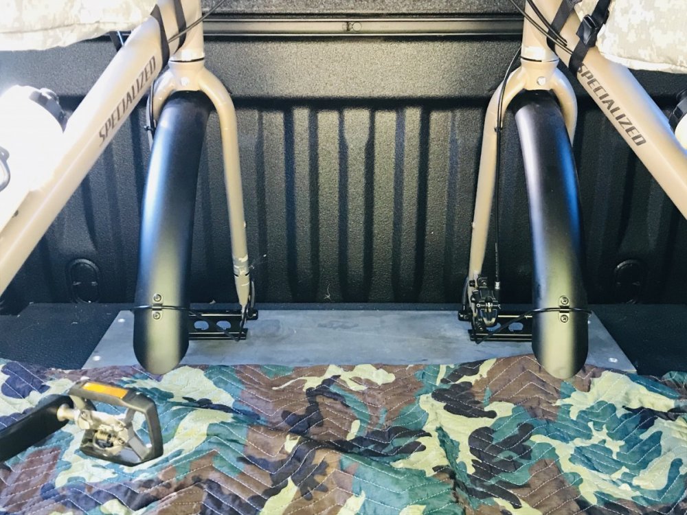

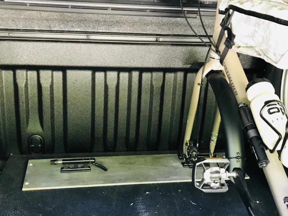

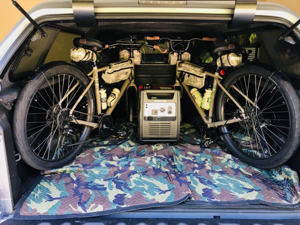

Not a bicycle rack for the back receiver hitch of an Ollie, but one I configured for our Tundra bed. Just an alternative thought here. This set up works great and keeps our bicycles secure, out of sight, and most of all clean. It has kept the bikes secured in location with no issues. The Aluminum plate is mounted to a rubber horse stall mat. (Tractor supply). Hope this might help someone wanting to carry bikes in your pickup bed rather than the back of the Ollie. Our Tundra has an ARE Z series topper.
Edited by Patriot

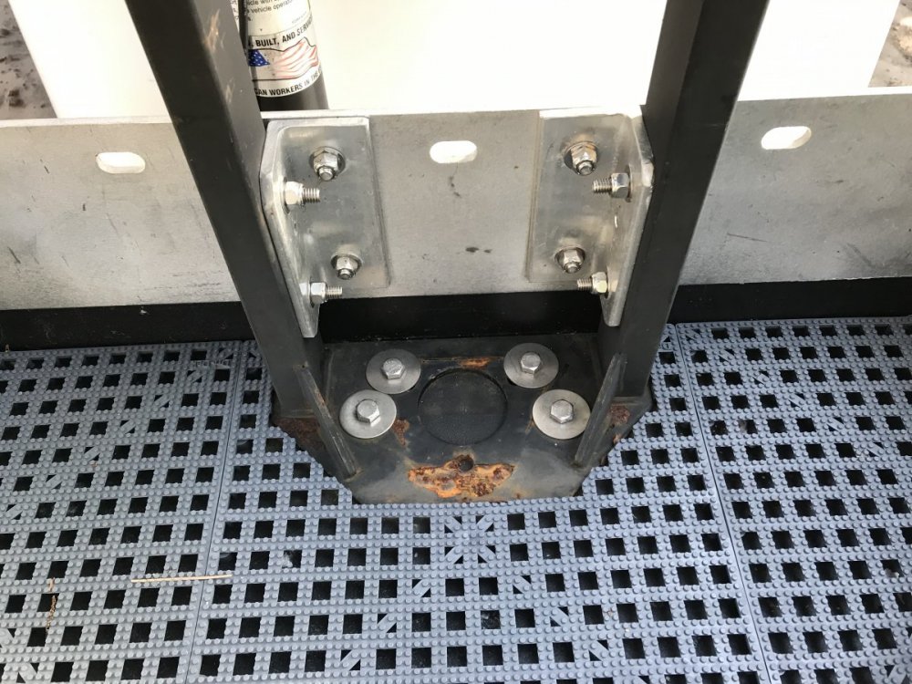

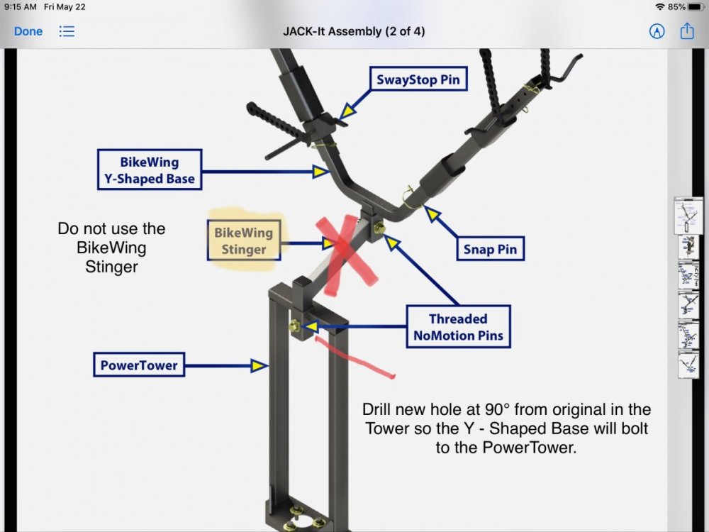

I mounted the tower in the stock Oliver tray so it it centered on the trailer instead of offset like the jack.  There is a 1/4" stainless steel plate below the trailer A-Frame that the 4 bolts pass through, clamping the PowerTower and storage tray together.
And to make a long story longer, this is the 3rd bike rack I have put on the Ollie.  The first 2 attempts used bike racks I already owned.  One was mounted on the back and interfered with opening the rear bumper and the second utilized Thule wheel trays mounted to the front cargo tray.
I was searching for a used Jack-it rack during these experiments and finally found one at a price that allowed me to fearlessly modify it.  As you can see from the rust in the picture, the tower was mounted under a jack by the previous owner.
I eliminated the Bike Wing Stinger and drilled a new hole 90° from original to mount the Y - Shaped Base.  I had to drill from both sides because I didn’t have a 90° drill attachment at that time.  Now the bikes sit directly above the PowerTower.
After nearly 4000 miles, I can say that it works well.
If you have any questions or need more pictures, just let me know.
Mossemi
