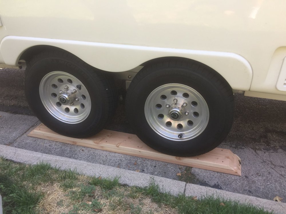

I have the exact same problem Rumline describes. I get the trailer out of storage, park it in front of our house, and fill the tank. Our street has a very steep slope to the curb. When we get to our destination and level the trailer we have 60-65% full tank.
My solution is based on a post I saw several years ago (See Tip number 4), of using boards for leveling. I cut angles on 2 x 8 boards and put drive the trailer up on them. The only photo I have is of two boards under the curbside wheels.
Two boards was not enough, so I tried three boards, and I am now using four boards which seems to level the trailer. That should be about six inches. Like I said, my street has a steep slope.
I used long wood screws to attach the boards together. Although the original post suggested carrying these boards for leveling at campsites, I do not. The boards stay at home.

Thanks for the replies. I hadn't considered the importance of being level laterally, or even slightly higher on the curb side. And David thank you for reminding me of the board leveling method. I'd ruled out such a solution for traveling but just keeping them in the garage at home wouldn't be much of a burden.
Un-hitching, leveling, and then re-hitching is a hassle I'd prefer to avoid, but for boondocking having a full water tank is more important.
Un-hitching, leveling, and then re-hitching is a hassle I’d prefer to avoid, but for boondocking having a full water tank is more important.
I don't unhitch when parked in front of my house. I pull the trailer on the boards, and leave the car hitched.
