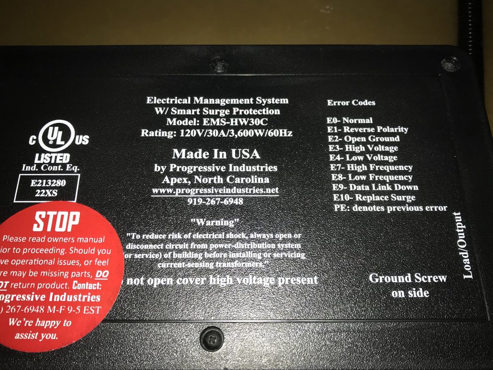

We had 30 amp servise installed for our Oliver Camper all seemed well for several weeks and then we noticed a shut down with a E9 error code on the surge protector Display. I hopped into the Progressive manual and it says in its definition Data Link Down contact Tech Support. Which i did and was advise it was most likely a faulty Display monitor or cable. OK then i asked would that stop 30 amp service from being utilized . Answer was I don't know. Has anyone experienced this?.....Yukon

I get the same error code (E9) when I use my Honda EU2200i generator. That blocks power from the generator from being used. When using the generator I use the remote switch to by-pass the surge suppressor protection as I feel power from the generator is good. The surge suppressor works fine (E0) when connected to shore power. It seems something in the power from the generator is causing the error code. I remember reading in another post about issues with ground bonds between neutral and ground for certain generators. I’m posting this info for you because you may be having a similar type issue going on with your shore power. You may also try using your 115v adapter and see if you get the same error when plugged in to another circuit.

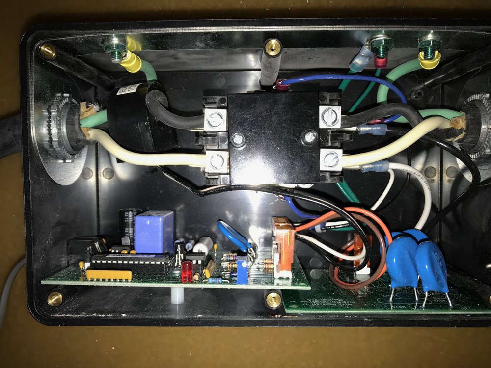

Update, Had to bring in a RV tech person to trouble shoot the Electrical system from Shore tie and then out. Turns out the Remote display and Data cable appear not to be the issue ,even though the E9 error code points in this direction. The surge Protector main unit has at some point overheated.  The Tech person recommended i establish another protection EMS right out of the shore tie box,  He is concerned the power transfer box is susceptible to damage as well. Once I receive the
remote EMS and plug in for a week  i should have my answer.

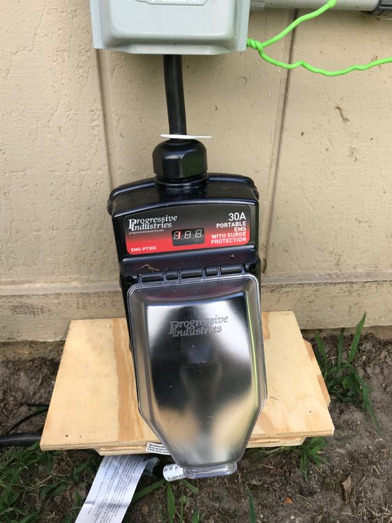

Thanks for that Bill, I have check the batteries, not educated enough to see how that would come into play but not surprised . The E9 code could mean bad remote display, bad data cable , bad main surge protector box and now from you a lose batt connection .  The RV tech i hired checked everything from the shore tie to the surge protector. And he feels it is important to place a remote EMS at the shore tie box. He says it will protect transfer switch and fwd.  I did order a EMS and will install and give it a week and see what happens...... thanks for the info.

Ok think i can put this problem to bed. The problem was the main surge protector unit. Figuring this all out was a real PIA . So if you run into this''' this is what i think you need  to consider. First get a good Electrician that is educated in Campground  power supply installation only'' . 2. Don't rely on Progressive to figure out your issues'' they are Code directed from readings from the remote monitor. 3. Progressive tech support changes out parts'' thats it! 4. A portable EMS is the first defense against any bad issues thrown your way and the built in Oliver EMS has no issue with this Portable EMS being in line ahead of it. 5. A portable EMS is easy to change out'' just unplug. (Caution I hear people like to steal them).  And last the Power Cord supplied by Oliver will not fully fit in Remote EMS I purchased '' the pull handle interferes with the WX cover. Thanks to all that helped with this issue.......Yukon

Did you remove the built-in unit? We have a portable Progressive and have been pleased with the electrical problems it has made us aware of. And we are made aware before we plug the camper in. With a portable you don't have to go inside to see the results. It does have fancy "dancing lights" while plugged in, so we use a pistol cable lock to secure it to the pedestal post so it doesn't get "borrowed". Probably a good bike lock would work too..

Yes i did file a warranty claim to replace the new main box , directed to do so via Progressive. And no''I did not remove the Oliver installed hard wired unit. As for the reason i had to go through all of this BS was i would lose power  and show error code E9 via the remote Monitor . Why I went with a portable EMS was it was recommended by a RV Tech '' his reason was the transfer switch was in line before the built in Progressive Surge Protector . And the cost of replacement of the transfer  switch would exceed the cost of a portable EMS. I also agree that the remote EMS and its data displayed is better than lifting the bed up to monitor data. The two units like each other so far, they show the same data.
