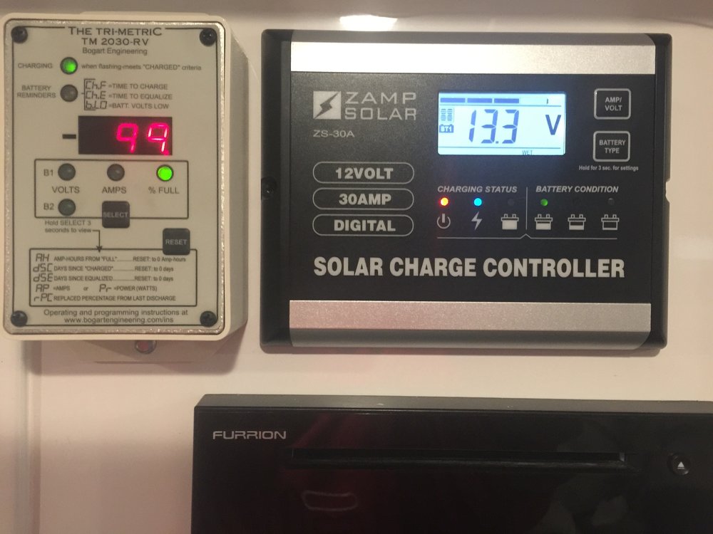

Installation difficulty will depend on where you want to install it.  I opted out of the factory stereo, so I had a good spot, though I had too much cabling to try to snake it down between the hulls, so I had to run it through the pantry.  Time consuming, but the cables are zip tied in the front corner and are out of sight enough that I forget they're there.  If you want to install the monitor like I did, you'll need a hole saw, some care, and a fearless disposition.  But it comes with a cover plate if you need to hide a reasonably sized mistake.
You might consider installing it somewhere hidden, perhaps right by the shunt or solar charge controller.  In hindsight, I should have done that since mine just repeats info that's easier to read on the Color Control.  But vs. bluetooth, there's a benefit of just being able to glance at it without having to pull out your phone, so consider your choices.
Here's where I installed both the shunt and monitor:
