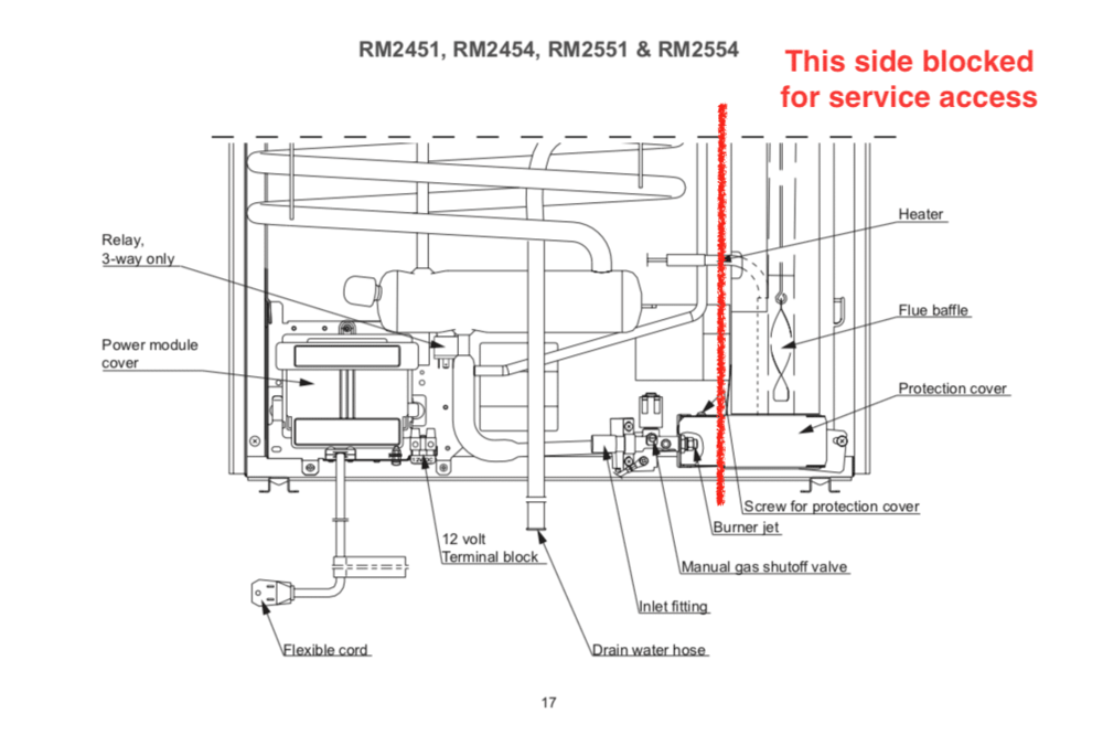

I have been putting off servicing my RM2454 fridge, but I have some issues. Here is what I submitted to the Service Dept.
1 - The cooling fan is bad, when it runs in hot weather the motor squeals loudly. It is located midway between the lower and upper coils, so removal of the fridge is required to reach it. I think the fan was added by Oliver, it is not shown in any of my fridge manuals. If this is an Oliver add-on, is there an access point where I can disconnect the power wire for the fan? And where is the fuse? I need a wiring diagram showing this circuit!
2 - The fridge appears to require complete removal for even routine servicing of the burner area; all I can reach from the outside is the gas jet and valve. Is the owner supposed to remove the entire unit annually to access the burner and flue? That seems very unreasonable. I bet most owners just ignore the maintenance completely until there is a failure. Why was there no thought given to better access from outside?

EDIT, added a pic and a video link. Here is a still from my borescope inspection.
[attachment file=Fridge fam Screen Cap.png]
Here is the video showing the insides of the fridge and the buried fan: ...
Found an EXCELLENT Diagnostic Manual here ....https://fourwheelcampers.com/NewDometicRefrigeratorManual.pdf
And here is what is visible from outside, everything to the left of the red line:
[attachment file=RM2554 Rear Equipment.png]

Most any camper you would have to pull the fridge to change a fan. On ours you can disconnect the ground wire at the terminal block and kill the fan. We had lots of problems with one of our Escape fridges and had to pull it 4 times. Its really not a big deal and is just a few wires, propane line and a few screws.
I am trying to establish if the fan is an Oliver add-on or if it comes with the fridge. My fridge manuals do not show this model as having one, and it isn't shown in the wiring charts. I would be fine with just disconnecting the circuit completely.
But if I have to pull the fridge out, it would be nice to be able to test the complete fridge operation with it standing on the driveway. I guess I could make a flexible gas hose extension and hook the 12 volt terminals to a battery and run it that way. I would like to be able to test the operation of the gas system, the replacement fan and temp switch before putting it all back into the trailer and re-taping the ducts. I would definitely remount the fan up high so it can be accessed from outside the hull next time.
