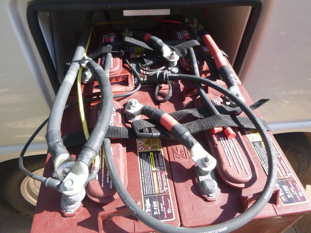

Moderators topgun2 Posted June 22, 2019 Moderators Share Posted June 22, 2019 Do these pics help you any? 2023 Ford F150 Lariat 3.5EB FX4 Max Towing, Max Payload, 2016 Oliver Elite II - Hull #117 "Twist" Near Asheville, NC Link to comment Share on other sites More sharing options...
Spike Posted June 22, 2019 Author Share Posted June 22, 2019 Bill, they just make me wonder what that cable with the loop at the end is in your compartment--something not in mine. Thanks, though. Onward through the Fog! EarthPicks of Cochise County Link to comment Share on other sites More sharing options...

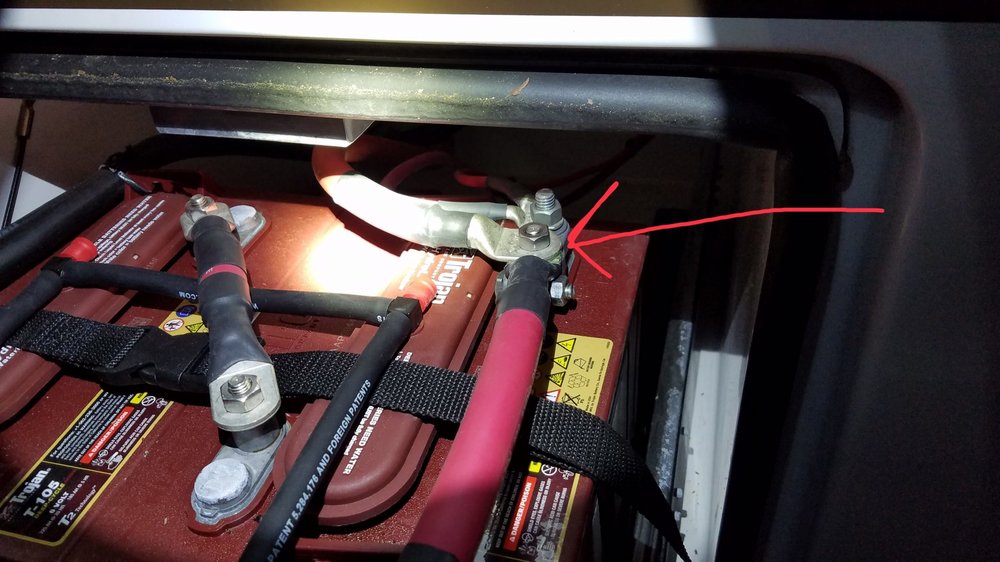

Spike Posted June 22, 2019 Author Share Posted June 22, 2019 From the looks of the terminal on the red cable, it has been connected to something. Can you take a picture with the battery tray pulled out so we can see all of the battery terminals? I could do that, but I can tell you that there are no terminals--I checked--where it could have been connected; they are all connected to other cables and the nuts are secure. OK, I just took that photo, which includes that loose cable. Onward through the Fog! EarthPicks of Cochise County Link to comment Share on other sites More sharing options...

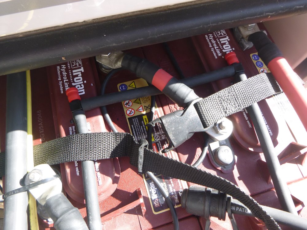

bhncb Posted June 22, 2019 Share Posted June 22, 2019 That cable is the positive feed to the inverter. The other end goes to the 250 amp ANL fuse located in the rear dinette access. Hard to see in the third picture of the batteries but it most likely should be on top of the other lug on the terminal just to the right as you're looking at the picture. Can you provide a broader view of this area. Also which battery option do you have. AGMs? Link to comment Share on other sites More sharing options...

bhncb Posted June 22, 2019 Share Posted June 22, 2019 Sorry for the post overlap. I see in your latest picture that they are AGMs. The cable should be on top of the short jumper going to the rear inner battery. Who worked on this last and why? 1 Link to comment Share on other sites More sharing options...

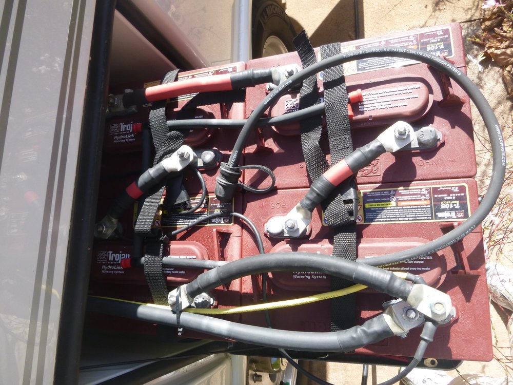

Moderators mossemi Posted June 22, 2019 Moderators Share Posted June 22, 2019 This is a picture of my lead acid batteries. The arrow point to where that cable is connected on my battery bank. 1 Mike and Krunch Lutz, FL 2017 LEII #193 “the dog house” Link to comment Share on other sites More sharing options...

Spike Posted June 22, 2019 Author Share Posted June 22, 2019 That cable is the positive feed to the inverter. The other end goes to the 250 amp ANL fuse located in the rear dinette access. Hard to see in the third picture of the batteries but it most likely should be on top of the other lug on the terminal just to the right as you’re looking at the picture. Can you provide a broader view of this area. Also which battery option do you have. AGMs? Well, if that indeed is the positive feed to the inverter, that would explain the situation. However, I see no indication that any of the terminals had this attached. Also, when the batteries, yes AGMs (see my original post), slide all the way out on the tray, the loose cable, if connected, would not reach the terminal that you mention. I think the attached photos are the best that I can get right now--one as a broader view, and the other more towards the back of the tray. I could, I suppose, attach this loose cable, but I am leery of doing so, for two reasons: 1) I don't want to damage something from my ignorance, and 2) it baffles me how it shows no sign (loose nuts, etc.) of ever having been attached. I will probably have to wait til Monday and have my RV repair guy take a look. Thanks so much for your input. Onward through the Fog! EarthPicks of Cochise County Link to comment Share on other sites More sharing options...

Spike Posted June 22, 2019 Author Share Posted June 22, 2019 The cable should be on top of the short jumper going to the rear inner battery. Who worked on this last and why? That loose cable being attached to the rear inner battery--without going back out now to look at the situation again--would make some sense, for as I mentioned above, if it were attached to the front battery, it would prevent the tray from sliding all the way forward. I have had no one do any work the battery compartment, and I certainly have not done anything in there myself, and no one has worked on the inverter. If that cable has been disconnected by someone, that would be one hell of a mystery. As I wrote above, I will have to end the investigation for the time being. Thanks much for your input. Onward through the Fog! EarthPicks of Cochise County Link to comment Share on other sites More sharing options...
bhncb Posted June 22, 2019 Share Posted June 22, 2019 One last for the night. It might have been attached to the inner battery terminal at the other end of the jumper. Same electrically. However, that jumper should be flipped over, or reversed end for end, so the upside-down lug is on the inner battery. Then your loose cable goes on top of that lug. 1 Link to comment Share on other sites More sharing options...
Spike Posted June 23, 2019 Author Share Posted June 23, 2019 Sunday Update on Inverter Problem and Mystery Cable--and Three More Questions Thanks to mountainoliver and bhncb, I have ascertained that the mystery loose cable is indeed the cable that should be connecting my batteries to my inverter. This may, in fact, be good news, as it would seem to indicate that perhaps my inverter is not fried and all I need to do is reconnect that cable. I am still baffled about how this cable became disconnected, as there is no evidence of a nut having secured it to any of the terminals. I have never done any work inside the battery compartment, nor have I had any work done by others in there. All I can figure is that it was never properly attached at the factory. Perhaps a worker had thought he or she would just temporarily attach it to test the inverter, thinking that he or she would attach it properly later--and then forgot all about it. It is nonetheless weird that the set-up would have worked for two years before failing. Because I know next to nothing about electrical systems, and because I want to avoid damage to the system and myself, before attaching the cable to any battery terminal, I want to make certain that I am attaching it to the correct one. Thus I seek further advice. I present here two photos of the back of the battery compartment. (I have previously ruled out the suggestion that I attach it to one in the front, as the cable, when the tray is open, does not reach that far.) Question number 1: Can someone tell me with certainty to which terminal I should connect the cable? Mountainoliver advised me to test for 12v on both sides of the fuse under the rear dinette seat before attaching the cable. I am unsure of why this may be important, but I used the voltage tester pictured below, and I get a weak "beep" and only two bars lighting up as I do when I test things like a USB cable in the trailer--as opposed to a much louder sound and all of the bars lighting up when I test the 110 outlet in my house. (I do wonder, if the cable is not connected to any battery, why I would get any signal at all.) Question number 2: Does this mean that I should go ahead with attaching the cable to one of the terminals? Question number 3: Are there further things to consider to make certain that I inflict no damage on the system or myself when reconnecting this cable? I apologize for what might seem to be my overcautiousness and perhaps inexcusable ignorance. I AM grateful, however, for folks patience and help with this issue. Thanks! Onward through the Fog! EarthPicks of Cochise County Link to comment Share on other sites More sharing options...
Moderator+ ScubaRx Posted June 23, 2019 Moderator+ Share Posted June 23, 2019 I suspect what you said is true about the cable never having been hooked up. That doesn’t explain how your inverter has been working for the past two years. It is obvious that it was attached at some time though. The reason that the cable appears too short is that there is too much inside the coach. Push some back into the battery compartment and it should easily reach the proper battery terminal. The red cable (positive) should be attached diagonally opposite the black cable (negative). This allows for all batteries to contribute equally to power needs. 1 Steve, Tali and our dog Rocky plus our beloved Storm, Maggie, Lucy and Reacher (all waiting at the Rainbow Bridge) 2008 Legacy Elite I - Outlaw Oliver, Hull #026 | 2014 Legacy Elite II - Outlaw Oliver, Hull #050 | 2022 Silverado High Country 3500HD SRW Diesel 4x4 Link to comment Share on other sites More sharing options...
Spike Posted June 23, 2019 Author Share Posted June 23, 2019 The red cable (positive) should be attached diagonally opposite the black cable (negative). Just to be clear then, are you telling me that the cable going to the inverter needs to be attached to the right-hand terminal closest to me as I open the compartment? (I have received differing opinions on this.) Also (I just checked), the cable that you suggest pushing further into the compartment will not be pushed or pulled; it is secured to the compartment wall with a fixture seemingly meant to do so. Onward through the Fog! EarthPicks of Cochise County Link to comment Share on other sites More sharing options...
bhncb Posted June 23, 2019 Share Posted June 23, 2019 First of all, that tester is for AC circuits and has not use for trouble shooting this problem. You need either a DC voltage meter or tester. The evidence of the loose cable having been previously connected is the ring around the hole on the lug, which is from the kerf nut serrations. Since the lug on the loose cable appears to be in a right-side-up orientation, it was previously installed either directly on a battery stud or on top of another lug that is orientated upside down like the one on the short jumper connected at the outer rear battery positive terminal. If you're not comfortable tackling this, by all means wait until tomorrow or whenever your RV specialist is available. If it were mine, I would reorient the short jumper between the positive posts of the two rear batteries so the upside-down lug is on the inner battery stud. Then stack the loose cable lug on top of it. Secure kerf nuts on both batteries. (100 in lb if possible) I sure hope the mystery gets resolved. 1 Link to comment Share on other sites More sharing options...
