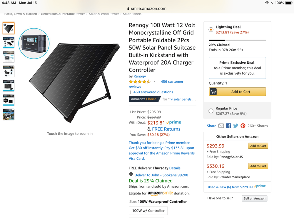

That is a heck of a sale price..... if you want one, buy Right Now. That is a today only price and they may sell out.... https://smile.amazon.com/dp/B079JVBVL3/?coliid=IQOA7UNUKCHSA&colid=1X5H11EH41351&psc=0&ref_=lv_ov_lig_dp_it

Ordered one of those...thanks for the tip.  Need to find a Zamp external plug as our pickup is in August.

We're buying Raspy's trailer, and he has one of these, 100w. Do you think we need another for short-term boondocking? I'm guessing we could daisy chain them together.

I called Renogy and got an answer on daisy chaining suitcase solar panels together. You can do it easily if they don't have a controller. If there's a controller, it will have to be removed, which will void the warranty.
