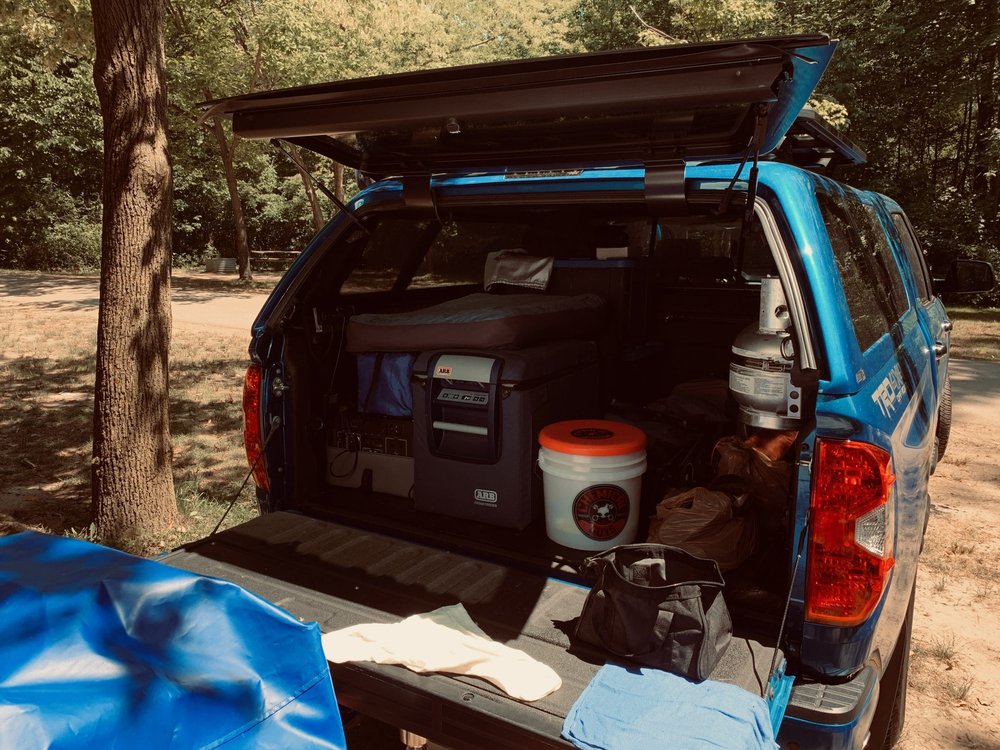

I use the Yeti 1400 to power my ARB fridge in my truck to supplement cold food storage and I usually keep it charged while driving with the TV alternator or I use portable solar panels to charge it while camped. The only time I need a propane generator for is to run the air conditioner... which is the only thing the Yeti 1400 or 3000 can't do I believe. So unless you install a larger inverter and bigger battery bank the propane gen is still needed for my use. I live in TN and AC is a must 24/7/365. I love the Yeti and Goal Zero products in general but they have very specific uses at home and on the road, although it could always be used for backup to run everything else. And for $3000 you could be well on your way to upgrading to a LFP battery bank. SO many options! I am sure you will get more feedback from the site, which is what makes this site so helpful.
Thank you for your reply.  Love your fridge/Yeti set up!  I dislike shopping for groceries, so being able to stock up for a couple of weeks would be nice.  You live in TN and need air conditioning 365 days???  I live in SE Louisiana near the Gulf and I don't need it all year!!  I would have thought TN has cooler winters.  I didn't know the Yeti could be charged in the vehicle.  Good to know.  Thanks!!

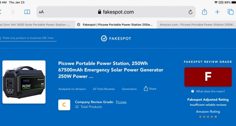

This appears to be spam post from a brand new member with no history, containing an indirect link to a Junk Chinese product on Amazon with fake reviews.

Thanks - in the future, please use the report function so that spam posts can be eliminated more quickly.
FYI, quoting the post merely doubles their SEO exposure, which is what they're after.
