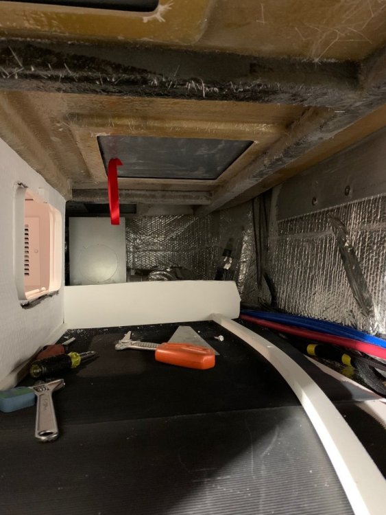

Moderators SeaDawg Posted October 25, 2020 Moderators Share Posted October 25, 2020 Thanks for finding that photo of an Elite II under construction. You can clearly see the ducting. And the reflectix insulation (which is not present in older 2008s like ours.) I'd love to see a new Elite I photo underway. The furnace in the smaller Elite moved to the small dinette area, but I don't know if it ducts to the bath, or anywhere else. Or, if it simply blows hot air from a single grate, as ours does, which is quite effective in heating the smaller cabin space. Maybe next time in Hohenwald I'll see one under construction. It's been awhile. 1 2008 Ram 1500 4 × 4 2008 Oliver Elite, Hull #12 Florida and Western North Carolina, or wherever the truck goes.... 400 watts solar. DC compressor fridge. No inverter. 2 x 105 ah agm batteries . Life is good. Link to comment Share on other sites More sharing options...

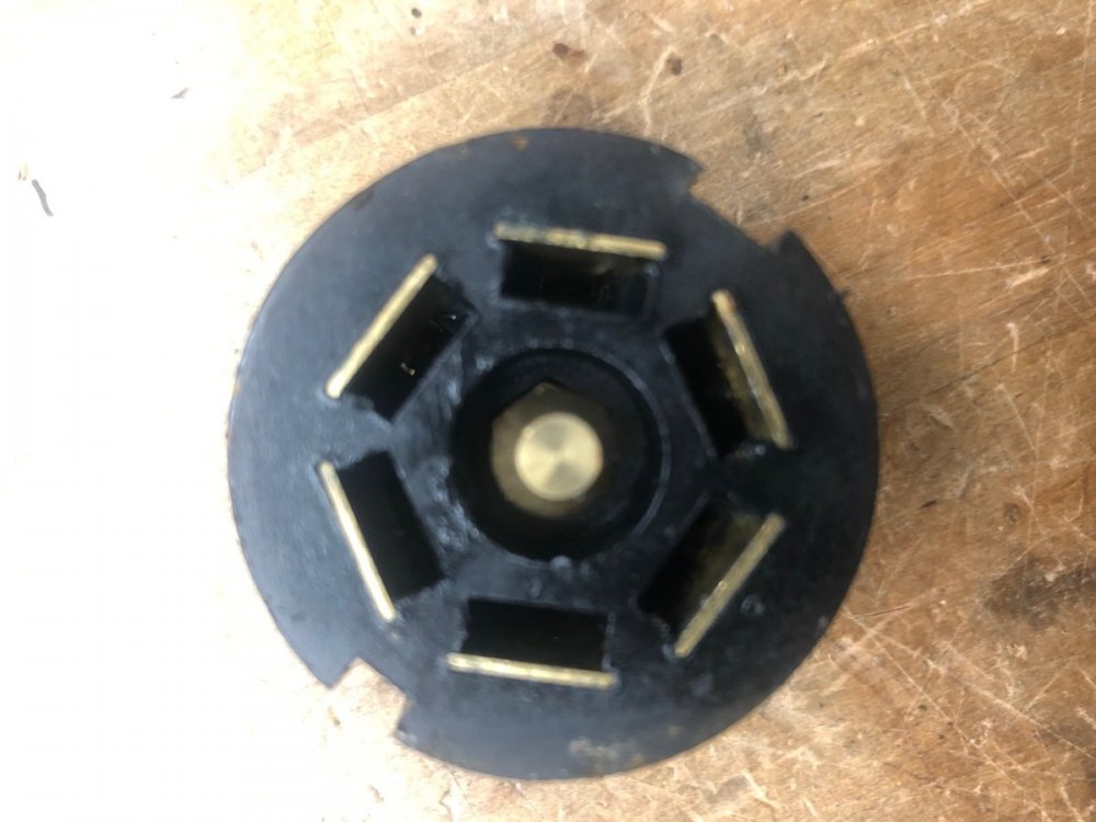

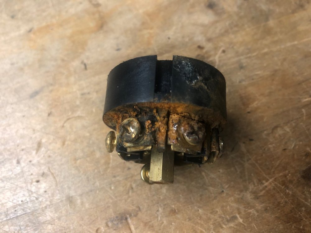

theOrca Posted November 21, 2020 Share Posted November 21, 2020 In late October this year I took my Elite II Oliver (Hull 615) to Republic, Washington for Elk hunting. There was 2 to 6 inches of snow on the ground and temperatures of 8 degrees F at night, and highs of 22 degrees F during the day. I stayed in an RV park so as to have AC power readily available. I have a 5 probe digital temperature system installed in my trailer. Probe #1 is near the propane tanks, #2 is under the forward dinette seat, #3 is under the drivers side bunk, #4 is under the passenger side bunk, and #5 is attached to the spare tire. (Note, numbers 2, 3, and 4 are as low is I could get them.) During my first night I noted that #2 temp was at 28 degrees, #3 was at 22 degrees and #4 was at 38 degrees. The "ducted" heat kept ONLY the starboard side of the trailer above freezing. I put small AC heaters under the dinette seat and under the port side bunk. After that, all internal temps stayed above freezing. The drivers side bunk area never got above 36 degrees, even with the 300 watt heater. Having foreknowledge of the expected temperatures, I pumped 8 oz of pink antifreeze into all 3 of the exterior water fittings. I then wrapped the fittings in pipe insulation. I believe that I had not done that, all three fittings would have frozen and cracked. I completely forgot about the exterior shower, but evidently lucked out as there has been no leak so far. I intend to purchase 3 each 100W DC heaters, and install one under the forward dinette and 2 under the drivers side bunk. There is a spare fuse for the drivers side awning which I will use to wire all three heaters through. Have not decided where to put the switches yet. NOTE: Pulling the Olly over salt covered roads can cause a real mess inside the RV 7 pin plug. Oliver service talked me through a very strange set of symptoms, but a set they knew quite well. Symptoms were - with trailer in a camp, no AC connected, occasionally the outside lamps of all 4 of the trailer running light/turn signal assemblies would come on (very dimly). The would stay on until late at night when the battery charge fell below 12.6V. Then they would go out. Service said "it is stray voltage from your 7 pin plug, take it apart, clean it and put some dielectric grease in there." When I took it apart it was so corroded that I replaced the 7 pin plug. Remember, this trailer was delivered to me last March (2020). Service told me that they have switched to a molded 7 pin plug to prevent recent trailers from experiencing this problem. The exterior of the plug looked pretty good, but the interior was a mess! 3 theOrca, 2020 Legacy Elite II, Twin, Hull 615 Tow Vehicle - 2016 Ram 1500, Hemi, 8 Speed with 1500# rear springs and Goodyear bags. Link to comment Share on other sites More sharing options...
Ray and Susan Huff Posted November 25, 2020 Share Posted November 25, 2020 We ordered a plug cover, hoping this will prevent corrosion such as pictured above. https://www.etrailer.com/Trailer-Plug-Covers/Optronics/ACP7B.html?feed=npn&gclid=CjwKCAiAnvj9BRA4EiwAuUMDf8n3IupBLlkaiKR7gn70_wBw_1R35JYFvGHSVDniWO0Th7U_FyU0HxoCdVgQAvD_BwE 1 1 Ray and Susan Huff Elite II Twin "Pearl" - Hull#699; delivered December 7, 2020 2013 F350 6.7l diesel Super Duty 4x4 long bed crew cab 1UP-USA Heavy-duty bike rack 2017 Leisure Travel Van Unity Twin Bed (sold) Link to comment Share on other sites More sharing options...

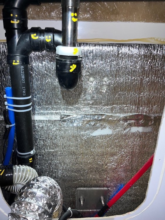

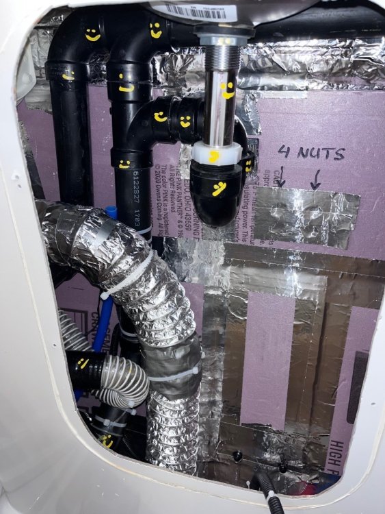

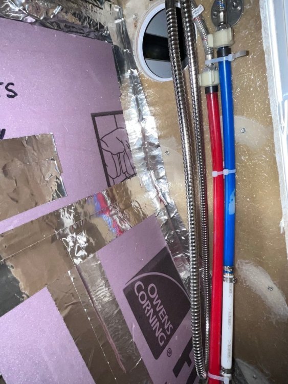

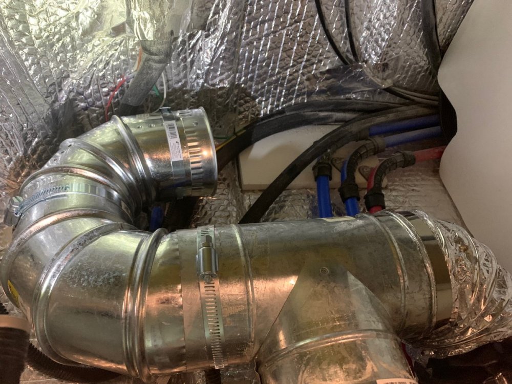

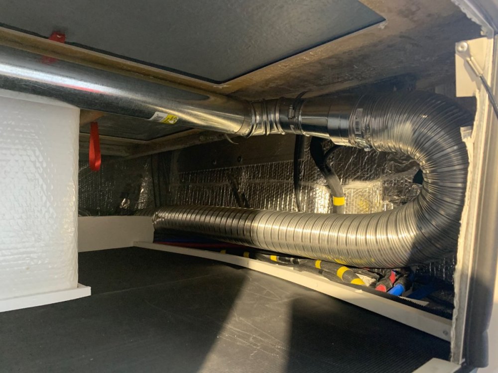

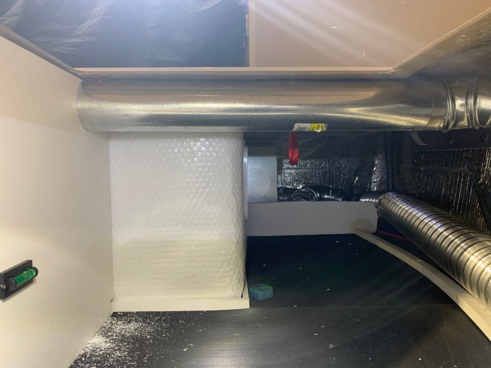

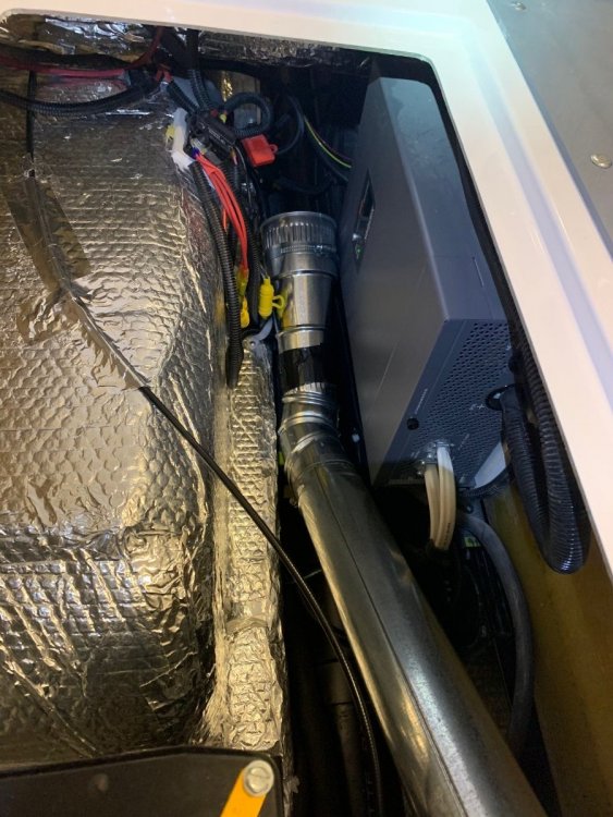

NCeagle Posted December 4, 2020 Share Posted December 4, 2020 Here's a propane-dependent solution I'm implementing to warm problem areas along the curb-side basement. I have found that by default, the street side basement runs about 10 degrees cooler than the curb-side basement when the furnace is on. The difference increases as the outside temp decreases. My simple goal is to balance the basements in order to protect the street-side plumbing. It's not particularly difficult to run another HVAC line down the curb-side and it takes advantage of the existing furnace. First, I just used a T connector on the back side of the furnace and tied into the line that goes up to the curb-side all the way to the bathroom. Here's a picture. I'm going to install a manual damper inline so I can restrict flow as needed. I then removed the flimsy plastic walls on the side and rear of the basement to make room. Here's the view looking into the basement from outside after removal: You can see the plumbing running along the back bumper area. This area runs a few degrees cooler than the street-side basement, so it's important to get some heat here as well to prevent freezing. I used 4" dryer duct to run along the back bumper plumbing. Then it's reduces down to a 3" solid duct that runs along the basement roof out of the way. Here goes the 3" duct through the basement wall (pvc board) into the street-side basement: Here's the final picture for now, looking from the back of the trailer towards the front (you can see the inverter on the right). I ran out of time yesterday so I just terminated the connection inside the street-side basement. It's super easy to finish running the 3" duct the rest of the way up the black tank drain pipe to where the footwell for the dinette is. I'm going to put some strategically placed holes along the duct now in order to balance out the temps on both sides at something reasonable. Still need an all-electric backup, but I feel like this is a good start. Easy, quick and takes advantage of the existing components. 3 3 2020 Elite II, Hull 688 --- 2021 Silverado 2500HD, 6.6L Duramax Diesel Link to comment Share on other sites More sharing options...
John E Davies Posted December 4, 2020 Share Posted December 4, 2020 (edited) This is quite cool (warm actually😬) but I have comments. Do you have concerns about crushing the overhead duct in the rear storage area? Up high is good, but I push 12” high milk crates loaded with hard items in and out of that spot. Could you use a different shaped duct that was more rectangular in cross section? Ideally Oliver would have a molded in place fiberglass warm air passage there in the roof of the compartment or along the water lines! It actually would not be too hard to manufacture a ‘glass duct that could be bonded to the ceiling there.... but that might overheat the mattress and its occupant. Could you make a big hole at the rear wall and run the air duct underneath the floor itself? I have never looked under that floor. Exposed steel in an electrical compartment probably violates RVIA codes, plus it is not good practice. Consider wrapping it in some non-conducting material in that location, maybe a layer of thin neoprene with self adhesive backing. You need to make sure the duct can easily be removed for wiring access there. You really do not want a sharp edge of steel to cut a wire! I personally would never do it your way. If you have the good toilet (AKA Natures Head) you could use the unused 3” black drain pipe as an air duct and eliminate the fragile steel one on that side of the trailer. And you could use the black tank as an air plenum to heat the bathroom floor and under the vanity (using the existing 1.5” tank vent). This also violates codes but at least it is in a non-conducting way. Thanks for your comments, I have been pondering a similar mod. My main hangup has been getting the warm air across the back of the trailer.... John Davies Spokane WA Edited December 4, 2020 by John E Davies 2 2 SOLD 07/23 "Mouse": 2017 Legacy Elite II Two Beds, Hull Number 218, See my HOW TO threads: Tow Vehicle: 2013 Land Cruiser 200, 32” LT tires, airbags, Safari snorkel, Maggiolina Grand Tour 360 Carbon RTT. Link to comment Share on other sites More sharing options...
