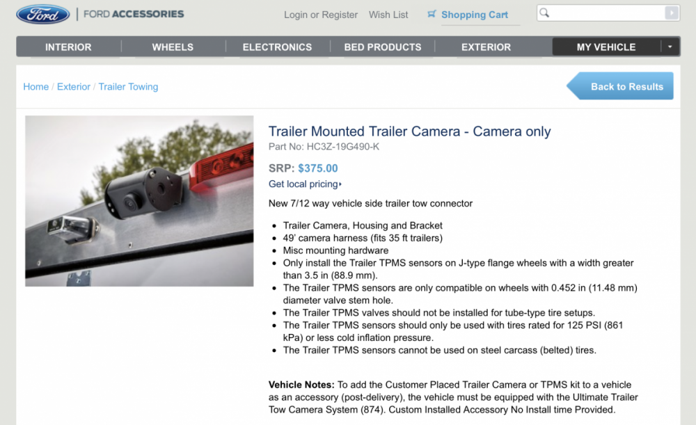

Saw this on the Ford Site.  It gives details on the backup camera and the TPMS requirements.
543700359_ScreenShot2020-01-16at6_37_21AM.thumb.png.1da076a1e315b88813e01b8382182ccc.png
