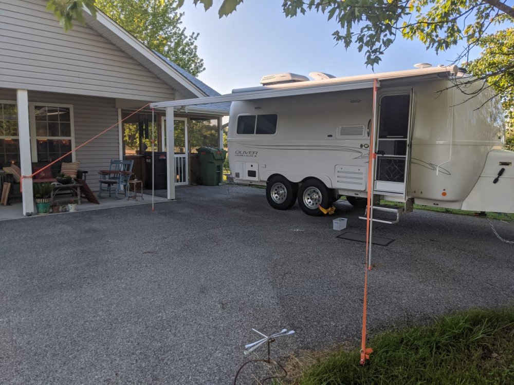

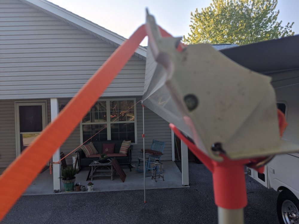

Not a busy morning and had my Ollie setting in the driveway. Here you go. Had it up in twenty mph wind but would still not go more than that. Straps seem to hold the awning down well. Not they circle over top of the awing.

A great looking Ollie, very partial to the silver swooshes.
Thanks for posting the support pole picks.

Thanks for the photos.  Did you cut out the notch for the cradle or does the Dometic(?) awning just have that?  Did you try it with the clip attachment?

I have had them up in a 20mph wind with gusts a little higher. Everything held steady. The fabric of the awning tried to raise but nothing moved. The notch is part of the design of the dometic awning. I make use of it to help hold the strips. I don't have a third support or rail. I have noticed any flex but will be watching closely next time I have it out. An may order. I think orange is good for visibility. Keeps me from tripping over them. I have a Clam and the original tied down strings were black. They have been replaced with bright blue with reflective silver piping for that same reason. 🙂
