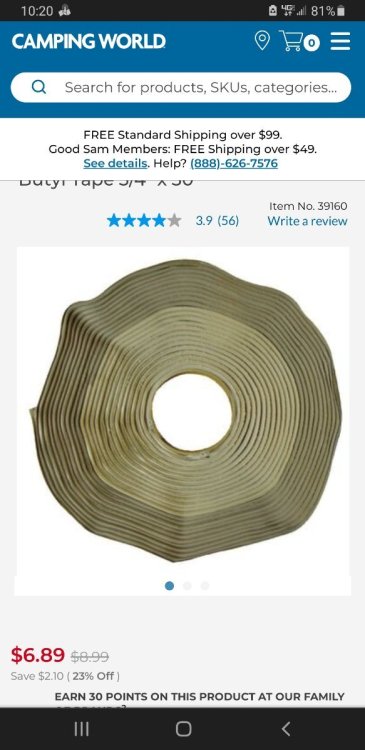

Townesw Posted October 29, 2021 Posted October 29, 2021 On 11/30/2020 at 8:35 AM, SeaDawg said: We bedded the van with grey butyl tape before Paul fastened the screws. He added some extra at the curve of the hull. @SeaDawgTell me about this butyl tape that you used to bed the fan. Bill and Martha 2018 LEII Hull 313 Original owners 3/14/2018 2019 Chevrolet 2500HD Duramax

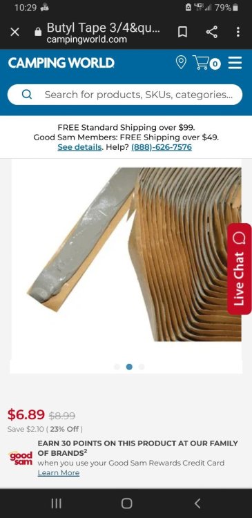

Moderators SeaDawg Posted October 29, 2021 Moderators Posted October 29, 2021 We use butyl "tape" for bedding windows, hatches, ports, and vents. It's butyl rubber, old school, but pretty much lasts forever, and creates a really strong seal. You can get it at camping world or amazon, in various widths, and grey or black. We only stock grey in the garage fridge. It's easier to work with cold, as it's pretty sticky and stretchy when warm. It's not really a "tape", per se, but comes in a roll with one side covered with waxed paper, that you take off after applying and pressing down on the first surface. If you decide to use it, make sure you buy real butyl tape, not putty tape, which isn't as good. Butyl is a great sealant, but not an adhesive, so it's used in combination with mechanical fasteners. Camping world sells dicor brand. 1 3 2008 Ram 1500 4 × 4 2008 Oliver Elite, Hull #12 Florida and Western North Carolina, or wherever the truck goes.... 400 watts solar. DC compressor fridge. No inverter. 2 x 105 ah agm batteries . Life is good.
