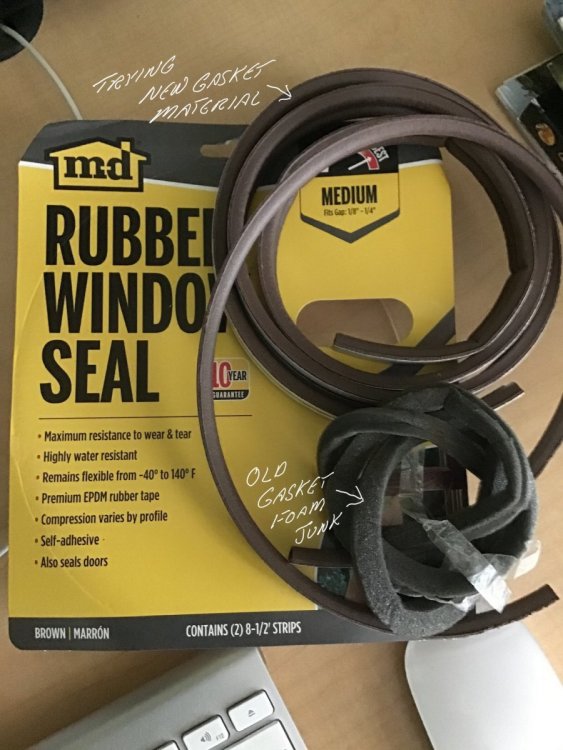

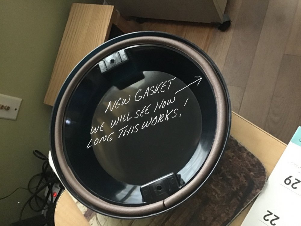

Yukon Posted August 21, 2020 Author Posted August 21, 2020 Figured out the bathroom fan failure was due to the sealing gasket Getting caught in the motor fan blade which intern burned out the fan motor. With Jason’s help . I was able to purchase a new motor from Amazon. All work is performed via outside by removing the cover. If you are not good on a ladder you may want to have someone do it. I am going to try a new type of gasket and see how that works. As usual poor quality and workmanship comes hone to roost. Oliver just installs the units and has nothing to do with the construction of the fan units. 2

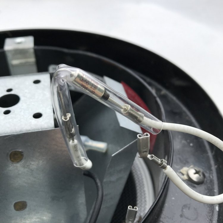

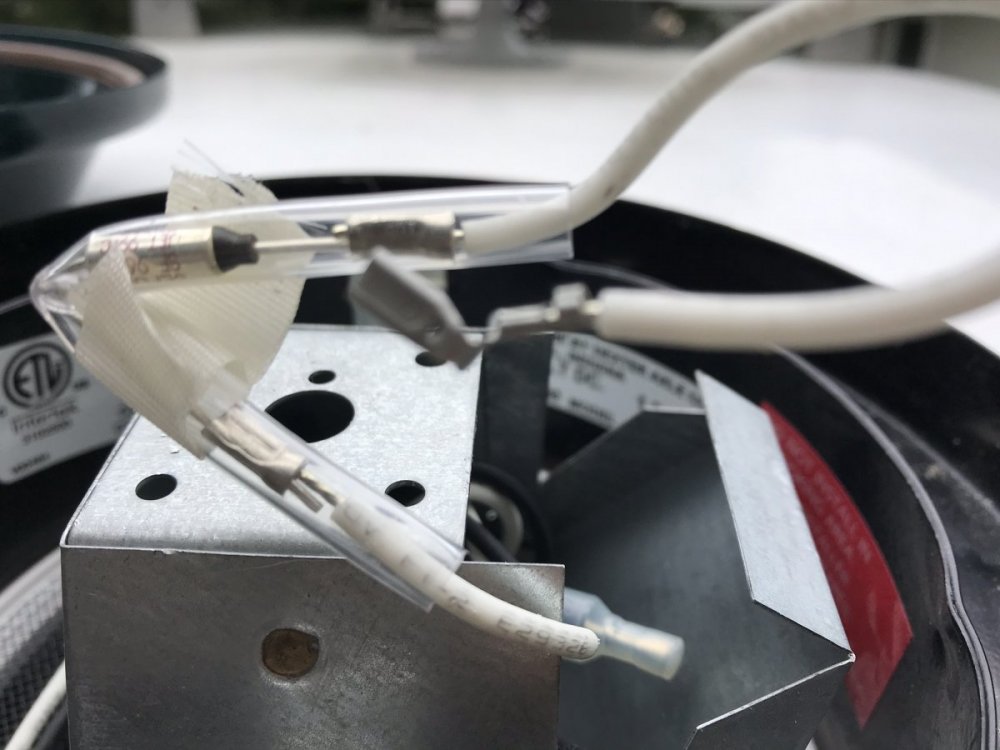

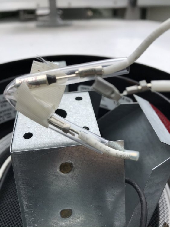

Yukon Posted August 22, 2020 Author Posted August 22, 2020 Ok just took pics of so called thermal fuse, cannot tell if it’s blown, can anyone else? One other thing do not, I will repeat this, do not lose the cover screws , as they cannot be replaced at Ace hardware, they called them specially screws.
bhncb Posted August 22, 2020 Posted August 22, 2020 14 minutes ago, Yukon said: cannot tell if it’s blown, There won't be anything obvious to the eye. You'll need to test it with an ohmmeter or continuity tester of some kind. A 9v battery and test light will work. The motor can be tested with the battery as well.
Yukon Posted August 22, 2020 Author Posted August 22, 2020 Ok thanks for that, out of my pay grade. Does it look like the old style or new.?
bhncb Posted August 22, 2020 Posted August 22, 2020 (edited) 2 hours ago, John E Davies said: Does the original foam seal fail from wind turbulence from leaving the fan cover raised while towing? The wind turbulence from the fan blade blew mine loose. The seal is adhered to the lid with double-sealstick cellophane tape. In the heat of the sun it doesn't take long. Edited August 22, 2020 by bhncb 1
bhncb Posted August 22, 2020 Posted August 22, 2020 1 minute ago, Yukon said: Ok thanks for that, out of my pay grade. Does it look like the old style or new.? That's the older (better) style.

Yukon Posted August 22, 2020 Author Posted August 22, 2020 How about removing the internal thermal fuse completely, it’s only a 25.00 junk part. Or maybe a safety issue?
bhncb Posted August 22, 2020 Posted August 22, 2020 1 minute ago, Yukon said: How about removing the internal thermal fuse completely, it’s only a 25.00 junk part. Or maybe a safety issue? Can't recommend that. However remote, a malfunction could cause the motor to overheat and start melting the wiring. The fuse could be replaced but you'd have to find the appropriate one and use high-temp parallel crimps. Not worth the effort or cost.

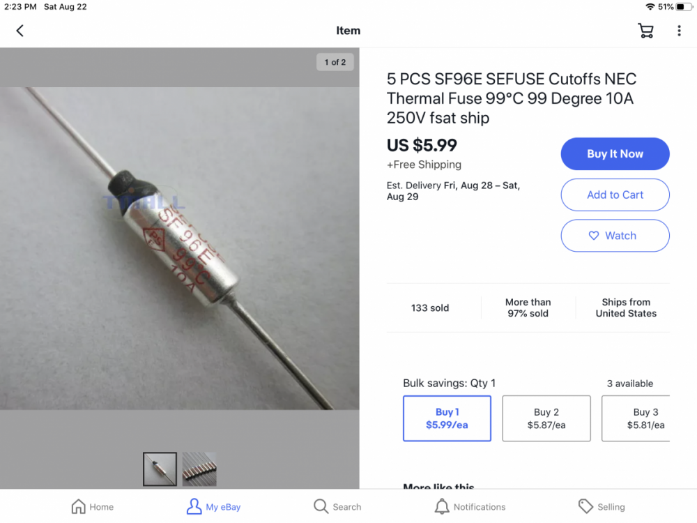

Yukon Posted August 22, 2020 Author Posted August 22, 2020 Update, 9V has the motor spinning, it must be the thermal fuse, ordered from Amazon. Hopefully not switch.
