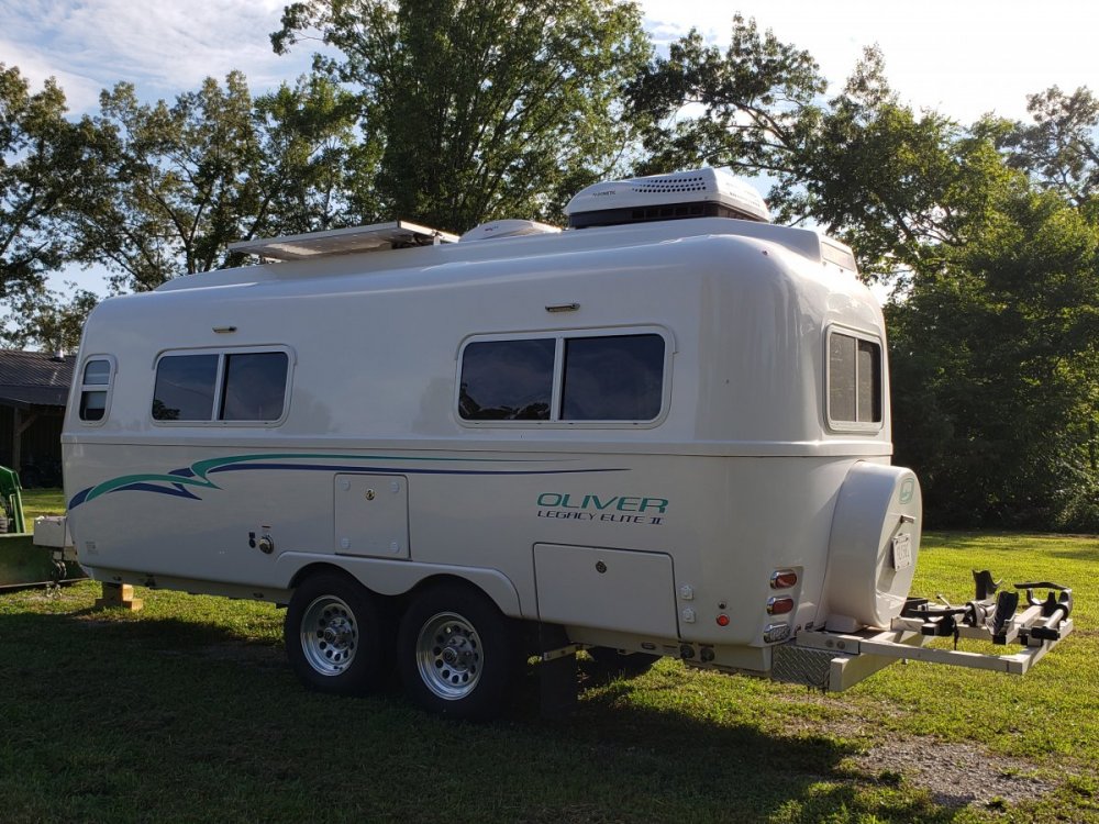

The one I have is the square platform, which was copied from the one that ScubaRx made for himself.  I bought a rhino rack basket that fits on it about perfectly so it functions as extra storage.
This is the only photo I can find that shows it, sort of...

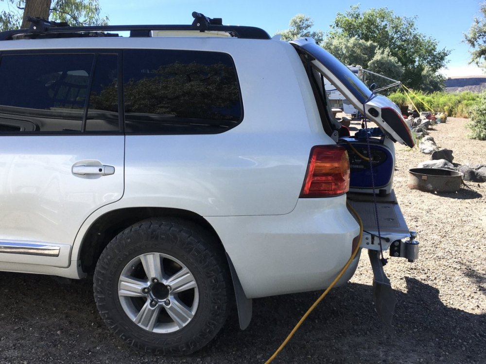

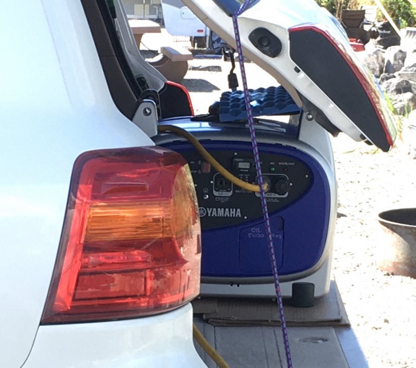

What is your truck? I always carry the Yamaha 2400 in the back of the 200, no problems, no petroleum smells, no oil leaks. I keep all gas cans outside, always. To run it I lay it on the ground near the coupler, or if I only need it for a little while, I will pull it out 8 “ onto the tailgate and run it in place. I reposition it this way so the upper hatch cannot possible close all the way on it while it is operating. Carrying a generator inside a passenger compartment is not the best idea, but it can be done with care.

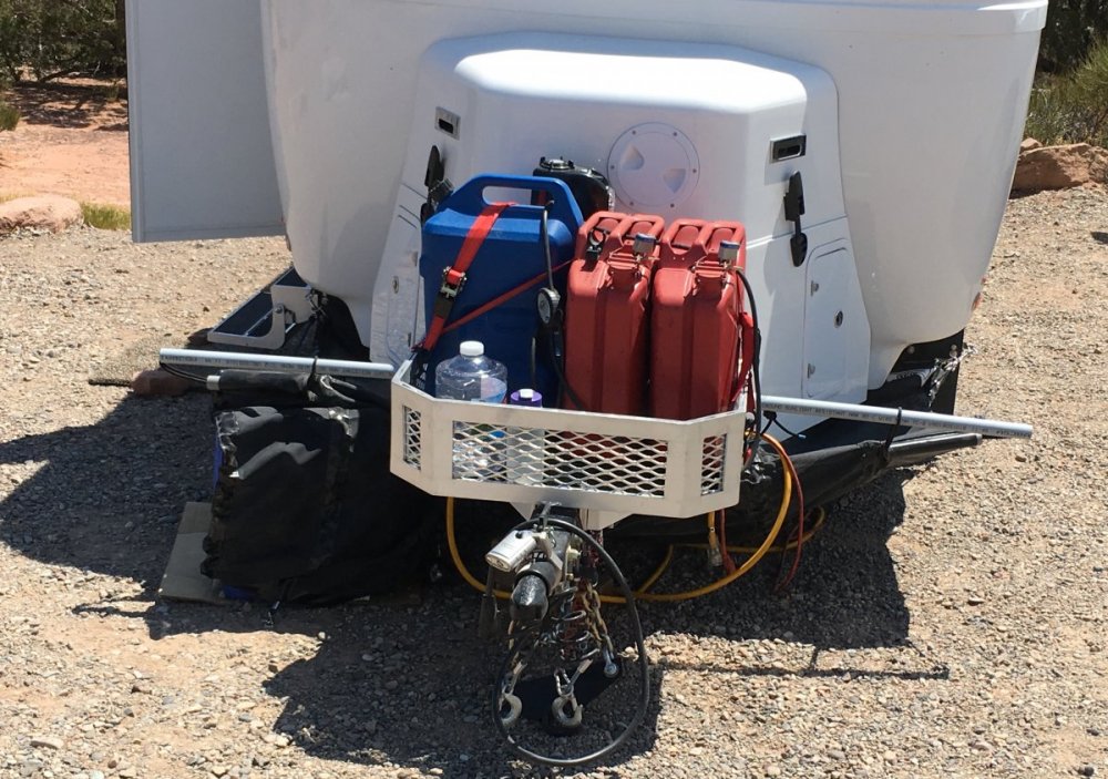

The original 2' SQUARE ALUMINUM  rack. I currently have a Yakama bike rack mounted on it. In the future there will be an aluminum box, with the bike rack mounted on top of the front opening box.

I do not want or feel the need for a propane conversion. I always carry 10 gallons of gas on the back of the Ollie on the relocated factory Ollie rack - BTW this reduces my tongue weight to under 500 pounds, when those jerry cans are full. So I never worry about having gas for the generator, and I can refuel the 200 using a fast flow syphon pump if I want to top up at the campsite before I head into the boonies. Or I can easily refill the gennie tank the same way. It was easier when the tray was up front, but it isn't a big deal now.
I removed the third row seats and stored them away the day I got the 200 home, and I recently put down a nice Toyota rubber mat for a Heritage Edition since the OEM mat has those cutouts for the seat mounts. I added a stainless loop at the right rear seat back bolt, to allow me to run a Python cable through that hole and through the Yamaha, so it can't wander off. Unfortunately, all the other stuff inside the truck could wander off, so it is not advisable to run the gennie this way unless you are entirely alone, or you can watch the proceedings through the window for bad guys. Here it is, running - you do NOT want to completely trap a running generator inside the truck.:

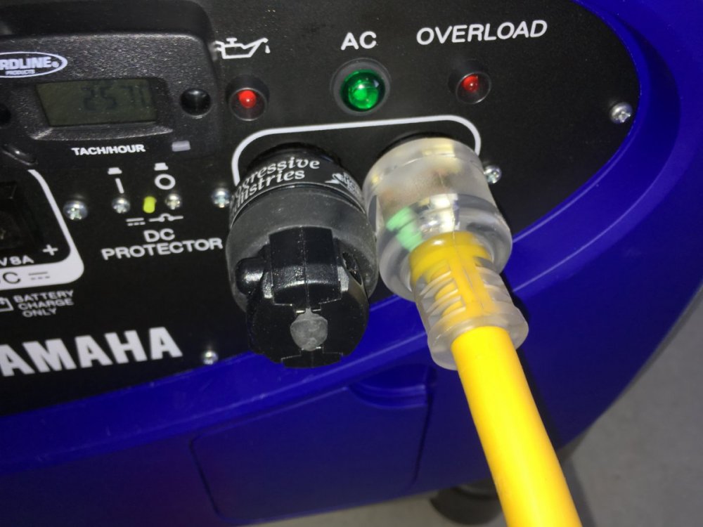

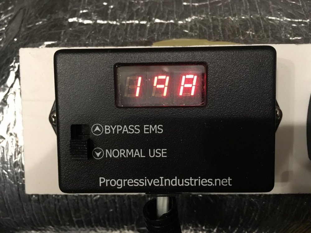

The Yamaha is a brute, I normally see close to 20 amps without issues and it runs my Air Command AC without a soft start kit, using a super heavy duty 10AWG 15 amp cord:

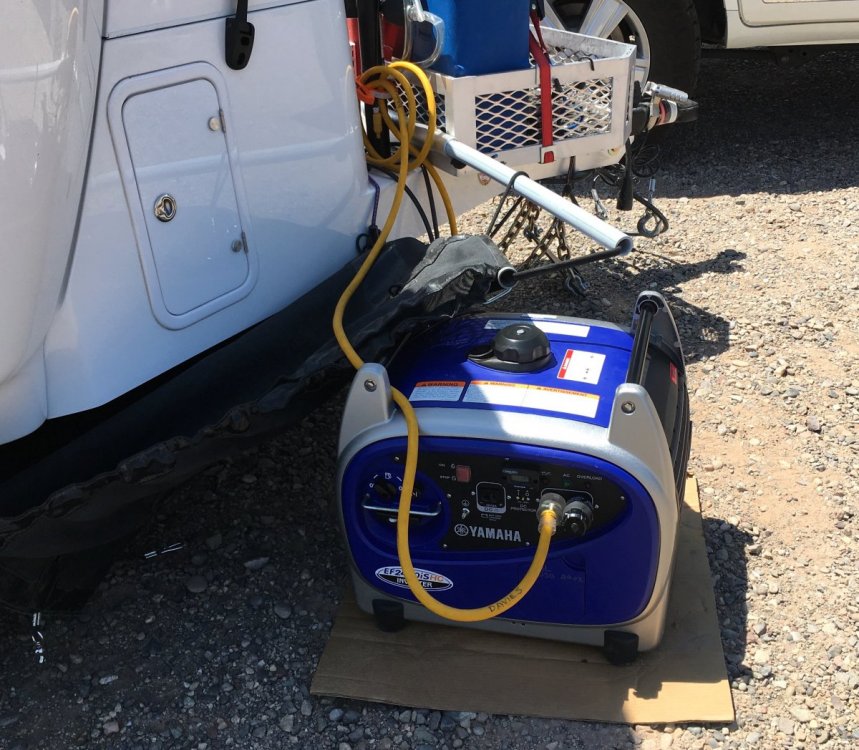

When running it on the ground, I lock it to the tongue:
Ands when switched off I hide it behind the Stone Stomper mesh, after it has cooled:. This shows the tray before I moved it around back:

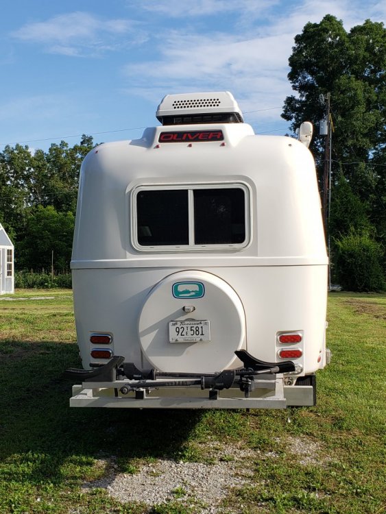

We have a 1up rack and hate to give it up.  So, we are hoping it will fit between the pickup and the trailer using a dual receiver adapter.  We are not getting the aluminum storage basket.
