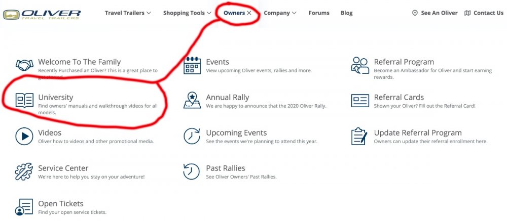

You should consider finding the 2020 Elite II manuals in the Oliver University portion of the Oliver Web Page under the Owners Tab.
You can then pre-study for pickup and also look at the details that you may need to boondock successfully.
