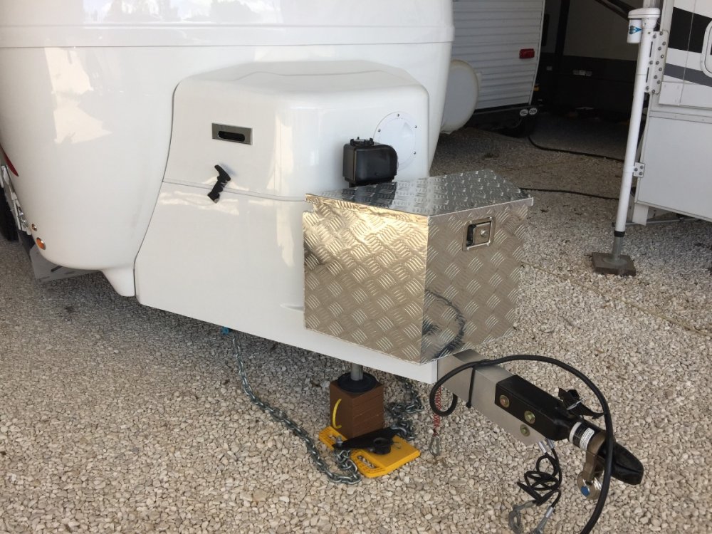

Also shopping for a generator that will fit in Ollie "basket" option (or in whatever one buys to cover the back of a Ram 1500 Rebel securely) and
A tongue basket increases your tongue weight. I'd skip it.
Any idea what the basket weighs?
2019 Toyota Land Cruiser
2021 Oliver Elite II, Hull #748
Im not really sure.. the old style basket probably weighed 50 or 60 lbs. My guess. Your rep could tell uou.
The new one is probably 8 or 10 pounds more.  The big thing is, what will you carry in it , and its weight, and why?
One of my friends got one, carried stuff in it for a year or two, then decided it was inconvenient for anything but chocks and blocks. Sometimes a bit of firewood.
You certainly have weight allowance for it, in the 10 to 15 per cent rule, but my personal opinion is it's awkward, kind of unattractive,  and gets in the way. I  use the tongue, while camped, to hold a 5 gallon water jug.
Good news is, you can always add one, later, if you truly find it necessary.  In 13 seasons,  we haven't found a good reason to add one.

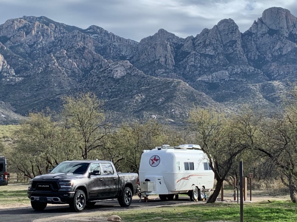

I am attaching a pic of it parked next to my nabe's SUV, which my Rebel looks like it could eat -- as a snack. Snarf!
Your rebel could probably eat my 2005 Silverado as a snack. Lol.
Actually the old style one is not nearly that heavy. I did not weigh mine, but it is way, way lighter than a full 5 gallon jerry can, which is around 42 pounds. I guess the tray weight to be about 20-25 pounds.
There is hardly anything extra underneath the bottom plate which is 1/8” thick, just some brackets.
I do agree that you should not put any additional weight on the tongue unless there is no other place for it. Lighter is better in many ways, and the LE2 does not show any signs of twitchiness when it has a light tongue weight. I can’t personally comment on the LE.

Another good reason to skip the front tray.
