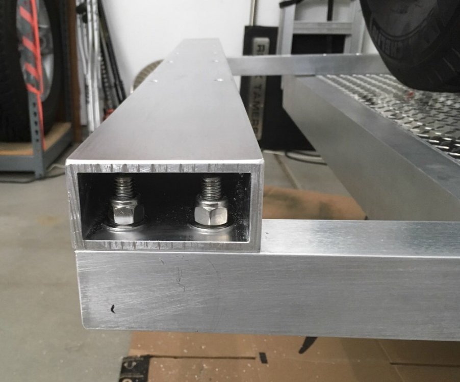

John E Davies Posted November 6, 2020 Posted November 6, 2020 (edited) That is a 2”x5” wide beam, you can tell because of the size of the adjacent supports, which are square 2”x2” outside diameter tubes. In comparison, here is a 2”x4” beam, I used that size for my rear rack. I would have gone wider if I could have found the material locally. I don’t see any issues with mounting that steel receiver to the Ollie beam, though I do suggest you replace the unknown hardware with stainless and self locking nuts. And do use an insulator of some kind, as well as silver antiseize compound on the threads. It sure would be nice if you could find a stainless steel receiver, that painted plain steel one will always be a little disappointing, and prone to dribbling rust streaks onto your rack. In your shoes, I would try to find a fabrication shop that would custom build me a stainless one with a flange, like this: That would never rust or need repainting, and it would look 100% absolutely sexy cool.....! Finally, there is no need to sandwich the outside of the beam so that the hardware is visible, you can drill large holes underneath the beam to allow access to the nuts. This is plenty strong for your application, and much cleaner looking than external ubolts or through bolts. More pics here: .... https://olivertraveltrailers.com/forums/topic/3263-how-to-move-the-factory-cargo-tray-to-a-rear-rack/ If my memory is correct, Pete “Bugeyedriver” had a very cool stainless bike rack custom fabricated, I think it had a welded up receiver. PM him and ask for pics and advice. .... https://olivertraveltrailers.com/forums/profile/17-bugeyedriver/ Good luck, start a complete thread on your project with pictures please. John Davies Spokane WA Edited November 7, 2020 by John E Davies 1 SOLD 07/23 "Mouse": 2017 Legacy Elite II Two Beds, Hull Number 218, See my HOW TO threads: Tow Vehicle: 2013 Land Cruiser 200, 32” LT tires, airbags, Safari snorkel, Maggiolina Grand Tour 360 Carbon RTT.
Jairon Posted November 7, 2020 Author Posted November 7, 2020 Thanks for the dimensions, John. Your frame looks better than the one from the Oliver factory 😜 I was hoping to find some solution that I could home game, even if it looks ugly. I've asked my sales rep if I could purchase the rack without the receiver bolted on. Assuming they get back to me and are OK with my request, I'll need to find some type of solution. Thanks again for the insights. 1 2019 Toyota Land Cruiser 2021 Oliver Elite II, Hull #748

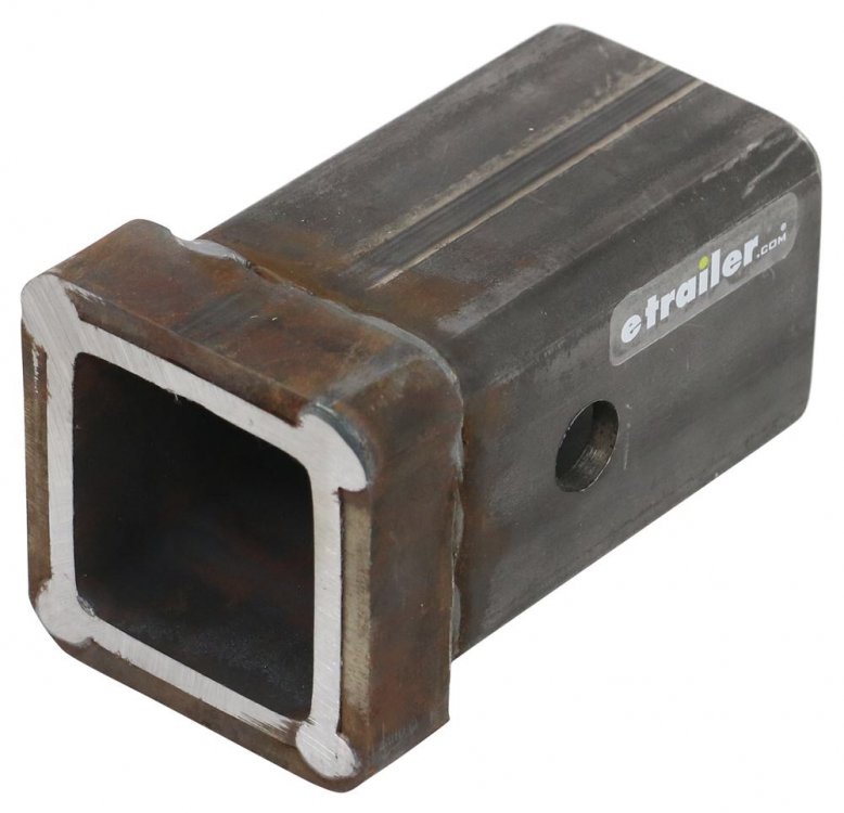

Jairon Posted November 7, 2020 Author Posted November 7, 2020 (edited) Another option when flipped upside down: https://www.amazon.com/Buyers-Products-SBH2-Receiver-Opening/dp/B007CVH6SO/ Another higher priced option: https://www.amazon.com/Ranch-Hand-RHU001BLB-Receiver-Tube/dp/B00C7OKVTC Edited November 8, 2020 by Jairon 1 2019 Toyota Land Cruiser 2021 Oliver Elite II, Hull #748

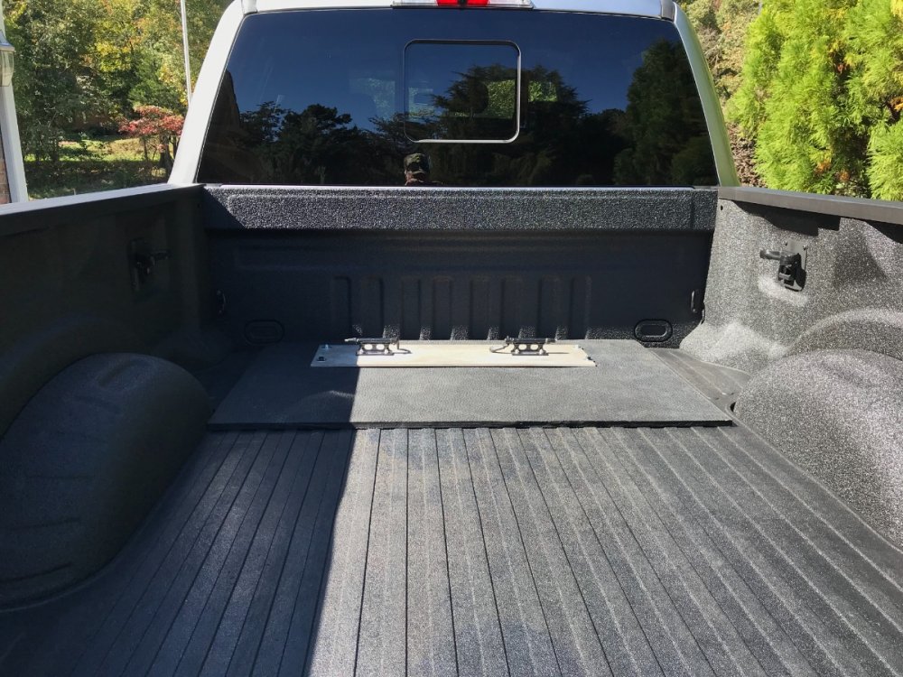

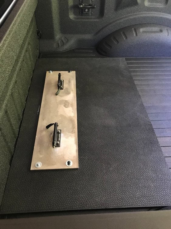

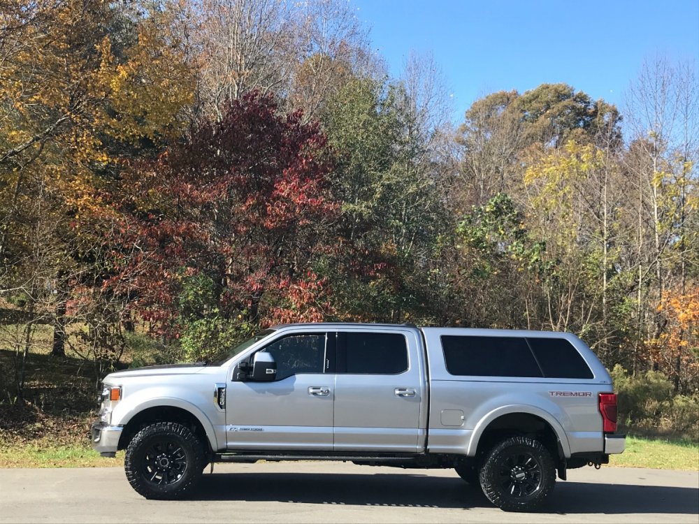

Patriot Posted November 9, 2020 Posted November 9, 2020 (edited) Here is what we use, as we are avid cyclists. So keeping it fairly simple and straight forward, we added a topper to our TV keeping our bikes clean, dry, and out of view of prying eyes. A bike rack on the rear of the Oliver would require us to remove the bikes and then reload them into our TV to go ride a bike trail or tour a local town or sight see, not logical. Naturally if your TV is an SUV or Van this is not an option then your left with hanging bikes off the back of your Ollie, just not something we care to do. We can easily pack our bicycles, Gen, Yeti Tundra cooler and all camp set up gear with room to spare. Edited November 9, 2020 by Patriot Spelling 2 2020 OLEII - Hull #634 aka- “XPLOR” 2021 F350 6.7 liter Diesel Lariat Ultimate Tremor aka - “Beast of Burden” Truma Aventa 13.5 AC, Alcan 5 leaf pack, Alcan HD shackles & HD wet bolts, 5200lb never lube axles.XPEL 10 mil PPF front both front corners, 30 lb LP tanks, Sea Biscuit Front Cargo Storage box. ⚡️⚡️11/2025- Lithium upgrade to XPLOR - (2) Epoch 300ah Lithium batteries, Victron 3000W MultiPlus-II, Victron GX Touch 70, Victron Cerbo GX, Victron Smart Solar MPPT, Victron Smart Shunt, Victron Orion XS 1400 DC-DC charger, RV Soft Start. Zamp 90W suit case solar panel for 420W of solar.⚡️⚡️ North Carolina
