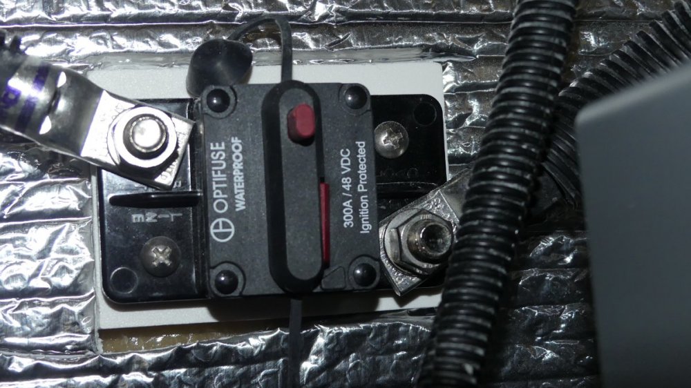

I'm preparing to do the reset but want to confirm that I have the correct breaker (located under the street side bed on the wall of the battery compartment)
Jason said "200A" but this is 300A.
Is this correct: Push the red button to disconnect; the red lever on the bottom to the left of the button will pop out; push the lever back in to reset?
I hope this resolves the problem with the remote panel not functioning.

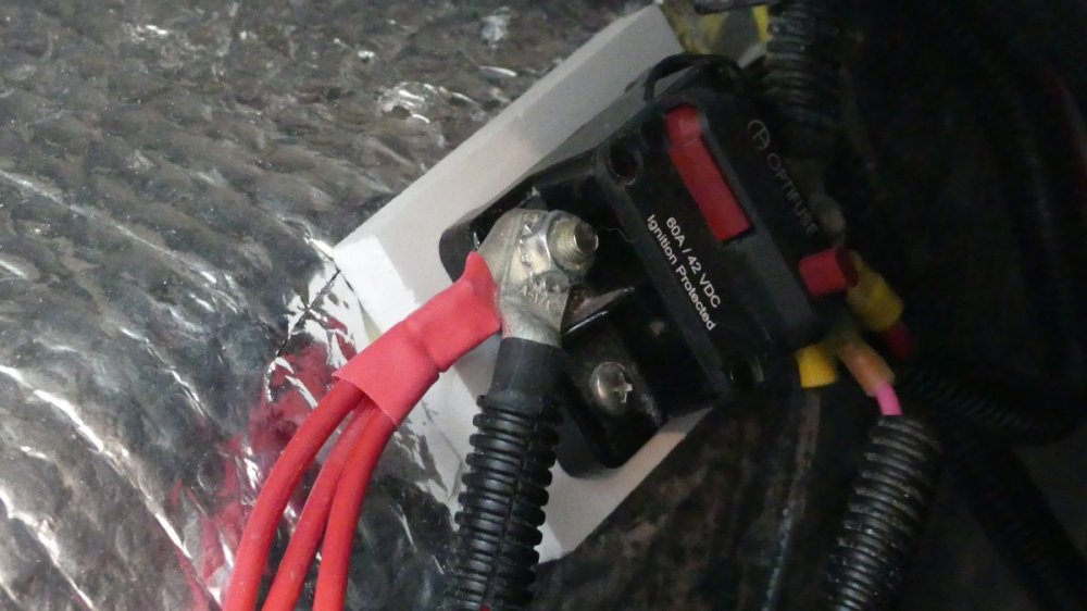

Also: there is another similar breaker switch (60A) attached to the top of the wheel well.  Can someone tell me what this is for?
That second breaker (bottom pix) is the main 60A Breaker for all the 12v loads for the trailer.
Some leads run over to the DC power panel with 12V fuses for various circuits like Lights, Fans etc.
There are a few of the lines to the right side of the 60A breaker are for things like the Propane Detector.
