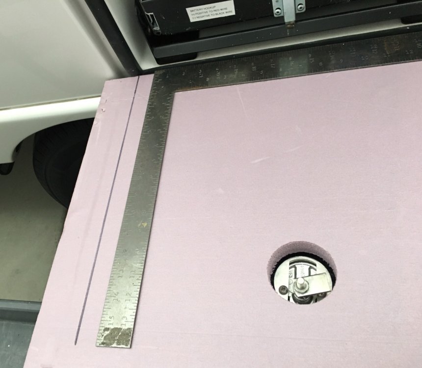

Keep in mind that open cell foam (like a sponge), or a towel, or anythjng that breathes, will provide very little insulation. The foam used around water pipes is fine.....The idea is to block the airflow and associated heat transfer, so a closed cell foam (semi rigid) will always have a much better R value. The metallic bubble insulation that Oliver uses is R1.
I haven’t finished this yet, but I am making door insulation panels from 1” R5 rigid foam board. The battery compartment door had zero insulation and eight 1” vent holes, so it will really make that compartment less drafty, for my new lithium batteries. I am not sure how it will turn out, I may scrap the idea - here is an early pic.
