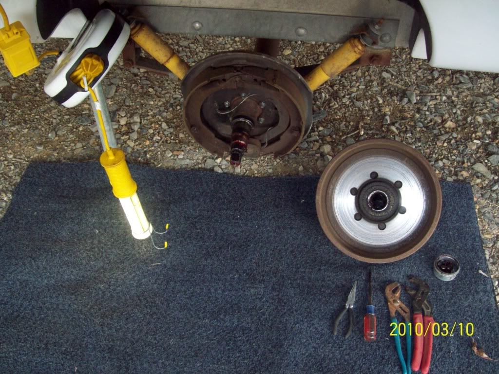

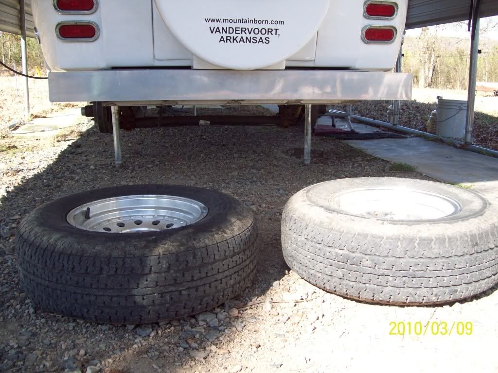

Update on our axle status. We now have the 5200 pound rated axle and are doing our bearing and brake checks now, just before starting another year of travels. We check our bearings "slack" without removing the wheel or tire, on a regular basis. We also add grease on or about the regularly reccommended check period of time. Thus forcing the old grease out where we can check it for magnetic particulants,and grease discoloration, a good barometer of bearing wear and heat build up.
Using this system we have handily exceded the reccommended check up times. We are "opening up" this axle's hubs for the first time to take a look. Since this is the third axle under our Ollie ( all upgrades, no malfunction ), and I havn't kept any kind of records, I arrive at miles towed by aproximate mileage of the various trips added togather. Which were:

With one side done so far, it is going very well. After cleaning, inspecting and repacking, I went back togather. I noted no excessive wear or scoring, but the castle nut did tighten one notch further, I think.
I'll have pix soon.
