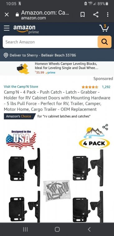

If the drawer latch looks like this you may be able to replace it with a stronger pull.  They widely available in 3 lb. to 10 lb. pulls.  The service department may be of help.

Thanks, Mike. You've posted that before, and I forgot about it. This time, I  put the 5 lb latches in my amazon cart before I  forget again.
Got a call from Oliver yesterday. There are also 15 and 20 pound latches. The drawer by itself is 7 pounds (I weighed it today), so just a few items in the drawer puts it over 10 pounds.
