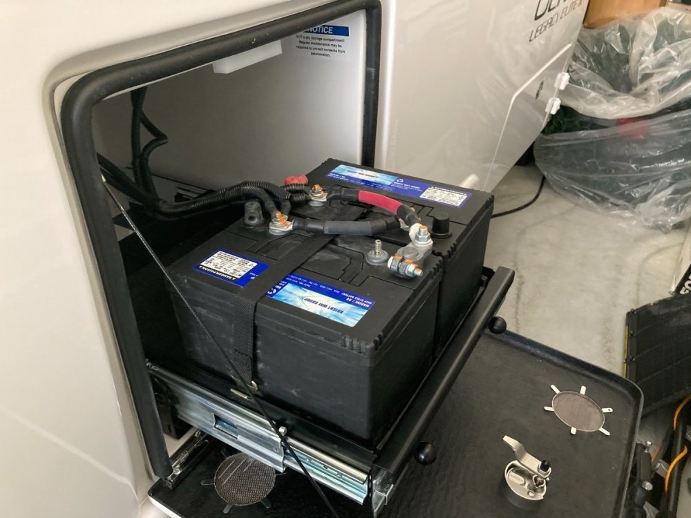

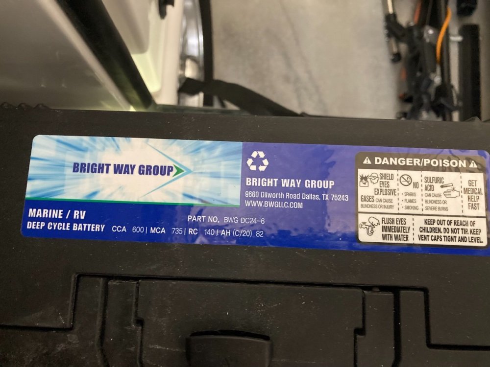

Chukarhunter Posted August 17, 2021 Posted August 17, 2021 My 2021 LEII came with 4 of the Brightway flooded batteries. They fit snug but easily in the tray with enough room for thin padding on the sides. 1 1 Steve and Lornie LE II Standard Hull #657 2004 4Runner 4.7 L V8 Oregon
ChrisMI Posted August 18, 2021 Posted August 18, 2021 3 hours ago, Chukarhunter said: My 2021 LEII came with 4 of the Brightway flooded batteries. They fit snug but easily in the tray with enough room for thin padding on the sides. It looks like 82AH from the pic above so 328 total AH for flooded, 440 for agm, 390 and 630 for lithium.
