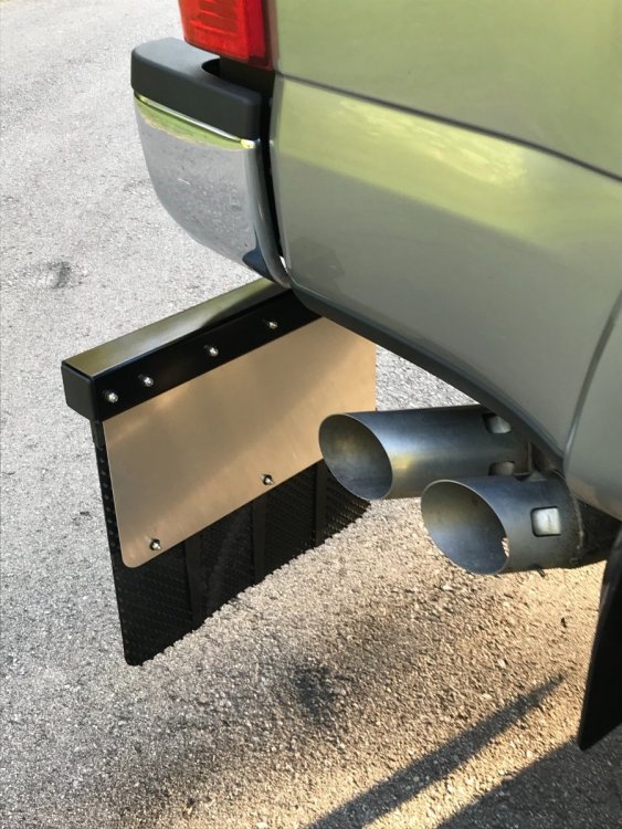

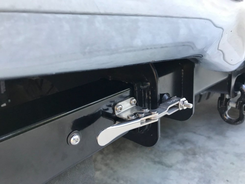

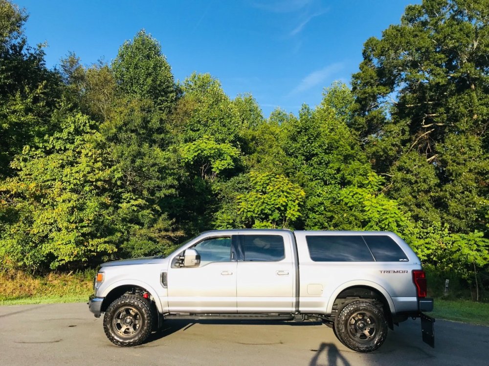

In an effort to reduce any nicks or dings to the front of our Ollie we had 10 mil XPEL paint protection installed on the front corners, dog house etc. I also recently custom ordered a set of these “rock flaps” for our F250 Tremor TV from a fabrication shop called livelymachine.com. I just was not overly impressed by the other brand of rock tamers or rock stoppers that mount to the hitch for a number of reasons. These rock flaps mount up underneath the bumper directly into the receiver left and right side square openings on our F250 Tremor.  A really nice fit and finish and very well made with aluminum powder coated tubing and all stainless hardware. Once mounted they are not going anywhere.

Very nice and sturdy Rock Flaps!
Great work!
Thanks Bill, appreciate it.
Along with the XPEL 10 mil paint protection on the front of our Oliver, I  have done all I can at this point to protect it.

Update on my rock stoppers. I had livelymachine send a set of SS plates and SS mounting hardware to preclude any upsailing from the flaps at highway speed. Very pleased with how clean the front of our Ollie looked after our trip. These are providing the protection I had hoped for.

I would be a little cautious, they actually should sail back at an angle. The Rock Tamers I have (hanging on my wall gathering dust for four years) are a very similar design, the Australian instructions say they should be rotated to give a static angle of say 20 to 30 degrees at the top of the flaps, so that they will sail at a 45 degree angle at highway speeds. That way stones will be deflected down to the ground instead of bouncing straight back onto your truck bumper and bodywork….. The USA instructions are completely silent about this, and most Rock Tamers I have seen here are installed dead vertical. It is just something to be aware of and to keep an eye on, it may not be an issue with yours. But if you see gravel lying on top of your bumper, and tail light or tailgate paint chips, that is why….
https://www.clearviewaccessories.com.au/wp-content/uploads/2019/03/RT_MANUAL.pdf
Plus if you are towing on gravel, or fresh chipseal, and you pass over a deep dip, they may hit the surface and throw up a ginormous rooster tail of gravel right onto your Ollie. That unfortunate characteristic is unavoidable with this design, it is what it is. You need to go with a completely different design like a Stone Stomper to avoid that. Which BTW is also effective against  Wood Bison  manure from the highway (Yukon Territory).
Notice how much cleaner (relatively speaking) the A frame of the Ollie is, in relation to the truck, flaps and the cloth mesh, which very effectively keeps all the “chaos” at ground level, as well as off the rear hatch and glass. In pouring rain at 60 mph the back glass stays practically dry… 😳

The SS plates and hardware are a fine finishing touch on the rock flaps, great job!

I am very impressed to see those toggle clamps being used in this application, they are very excellent! Do you know if they are stainless? I used a pair of a slightly different style, with a hook on one end, to secure the hard lid on an aluminum utility trailer. You can adjust the screw as parts wear, to keep everything tight and noise free. I used to have problems opening the trailer lid after driving on dusty roads, the clamps would clog up. I had to dump water from a water bottle on them to flush the grit from the joints. Are yours effective at keeping the flap support bars free from motion? Does Lively Machine sell replacement clamps or extra rubber feet? It might be smart to order extras for your spares kit, they do wear and can fail.
