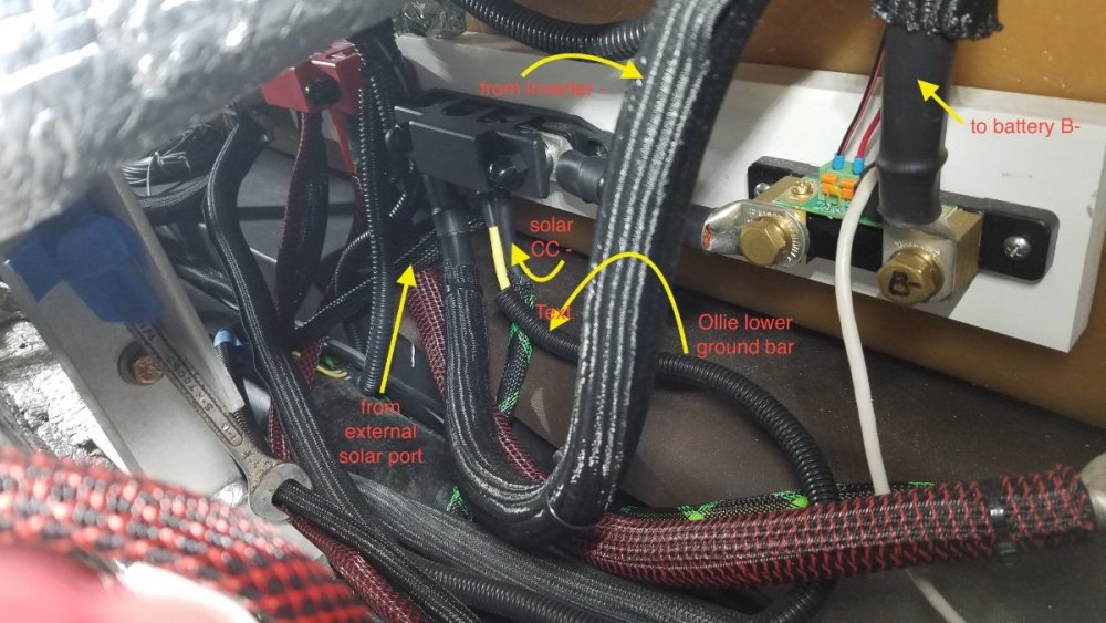

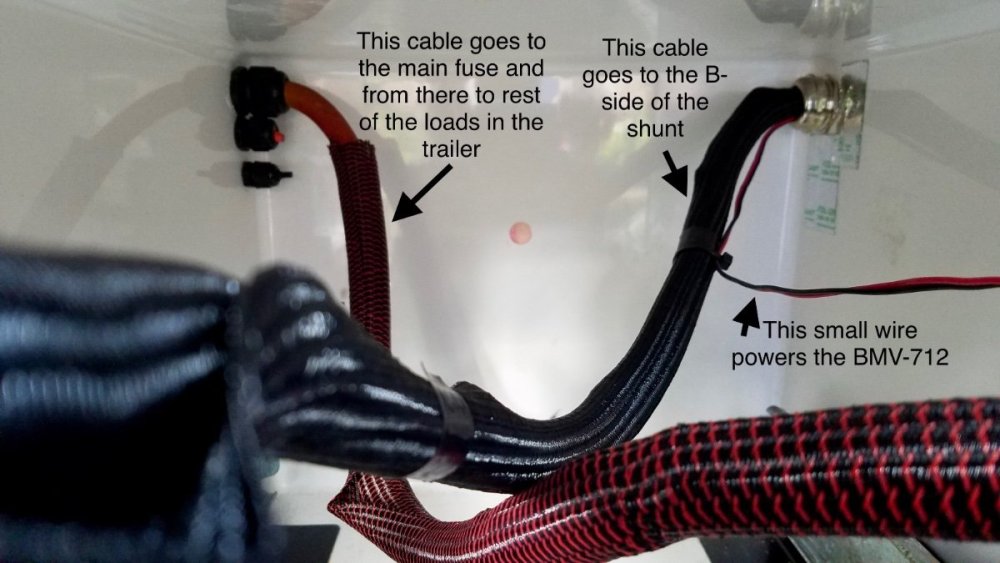

I have looked at your pictures and of course they created more questions.  So I am going to try a different approach and show you some of my installation.  This is a view of the battery box after I removed all other wiring so you can compare yours to mine and move any negative wires to the load side of the shunt.
dog house battery box
This picture is of the Victron shunt and the negative bus bar I installed.
I am not sure what “quirky readings” really means in your case.
This YouTube video will explain the BMV-712 installation better than I can.
PM me if you what to talk about this.

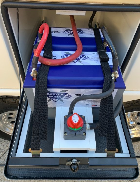

Hey Spike
i noticed that you said that your RV tech put the battleborn batteries on their end; could you post a photo of what that looks like, especially how you worked out the cables on the batteries. Thanks.
David #366
Kim and David Thompson Nomads' Nest 2018 LE2 #366 2018 Toyota Tundra, 4x4, 5.7L
1 hour ago, thompsonkd said:
Hey Spike
David #366
@Minnesota Oli did a nice install a while back…Link
