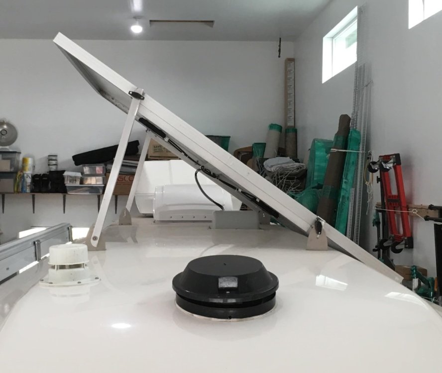

John E Davies Posted October 26, 2021 Posted October 26, 2021 If you have a single awning: Tilt the solar array up, with the low side away from the streetside awning, the snow won’t stay up there, it will end up in a heap on the ground… If you have two awnings, it won’t work well, though you might be able to achieve a few degrees of tilt. If you can orient the trailer so the panel is facing to the south or west, that is even better, the sun will melt any ice easier and it will charge like crazy. https://olivertraveltrailers.com/forums/topic/2791-how-to-solar-panel-extension-arms/ Being able to tilt the panel very high makes working up top orders of magnitude easier - a good reason to not buy that second awning….. John Davies Spokane WA 1 SOLD 07/23 "Mouse": 2017 Legacy Elite II Two Beds, Hull Number 218, See my HOW TO threads: Tow Vehicle: 2013 Land Cruiser 200, 32” LT tires, airbags, Safari snorkel, Maggiolina Grand Tour 360 Carbon RTT.
Steph and Dud B Posted October 26, 2021 Author Posted October 26, 2021 17 hours ago, John E Davies said: Being able to tilt the panel very high makes working up top orders of magnitude easier - a good reason to not buy that second awning….. John Davies That's pretty cool. Those look bigger than the stock solar panels. To be honest, we were planning to get the second awning to have more windows open in the rain, but I was getting concerned about getting snow off with two awnings. Undecided again... Stephanie and Dudley from CT. 2022 LE2, Hull #1150: Eggcelsior. Tow vehicle: 2016 GMC Sierra 6.0 gas dually 4x4. Our Oliver journey: Steph and Dud B's RV Screed Where we've been RVing since 1999:

John E Davies Posted October 26, 2021 Posted October 26, 2021 2 hours ago, Steph and Dud B said: That's pretty cool. Those look bigger than the stock solar panels. Thanks, they may seem to be a little bigger, that is just a result of the iPhone lens distortion. John Davies Spokane WA SOLD 07/23 "Mouse": 2017 Legacy Elite II Two Beds, Hull Number 218, See my HOW TO threads: Tow Vehicle: 2013 Land Cruiser 200, 32” LT tires, airbags, Safari snorkel, Maggiolina Grand Tour 360 Carbon RTT.

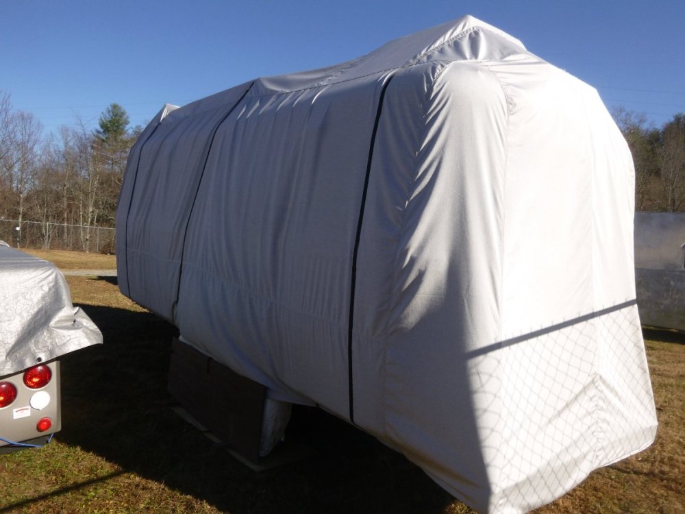

Moderators topgun2 Posted October 28, 2021 Moderators Posted October 28, 2021 Unless you are planning on living in a VERY unusual place in VA, I would not be concerned with any of the normal amounts of snow that generally are received in the State. Since I store my Elite II at a storage facility that does not have covered spaces, I use a CalMark fabric cover to help keep the sun and dirt off the camper during storage. Certainly most places in VA get more snow than we do even though I live in the mountains of western NC. In six years there has never been enough snow (largest was about 12 inches) that I've even thought about it. And, what snow we get is gone within a day or so. Bill 2023 Ford F150 Lariat 3.5EB FX4 Max Towing, Max Payload, 2016 Oliver Elite II - Hull #117 "Twist" Near Asheville, NC
