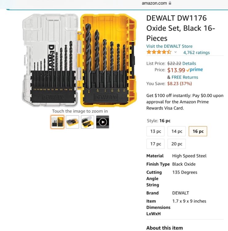

John E Davies Posted October 31, 2021 Share Posted October 31, 2021 Drilling is very simple, just get a bit the same exact size as your pin, do NOT go larger! That is not needed and will just make things too loose, the tight fit is needed for the ball to work correctly… There may be a slight misalignment or burr, and a bit the exactly same size as the pin will clean that up nicely. make sure the other pin is installed and lift up very slightly on the bumper to center the holes. My pins are 3/8”, double check yours, but I expect that is correct. A 3/8” bit will be found in most basic drill bit sets. If you don’t already have one, this set is quite nice for emergencies and fits in a galley drawer neatly. I also carry a Dewalt cordless drill and 1/2” impact driver when travelling, but that may be too anal for you. 😬 If you drill the holes with that bit and the pin still doesn’t go in, then you should replace it. There is either something wrong with the ball detent or it might be bent. You could try straightening a bent one using a bench vise and mallet, but there isn’t much you can do if the ball is messed up. John Davies Spokane WA 3 SOLD 07/23 "Mouse": 2017 Legacy Elite II Two Beds, Hull Number 218, See my HOW TO threads: Tow Vehicle: 2013 Land Cruiser 200, 32” LT tires, airbags, Safari snorkel, Maggiolina Grand Tour 360 Carbon RTT. Link to comment Share on other sites More sharing options...
