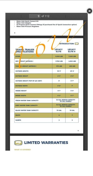

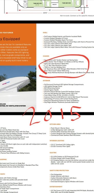

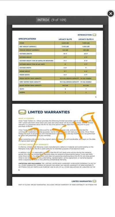

Moderators SeaDawg Posted January 11, 2022 Moderators Share Posted January 11, 2022 I've seen people use that solution, not here, but on other forums, @jim sroka. If it's only for off season storage, it's a lot cheaper than rebuilding a garage. More work, each season, but, well... I haven't seen the height spec change since 2015, on the Oliver specs, so I'm actually wondering how accurate they may be. We lost at least 4" when we removed the useless kingdome and the superhigh old Dometic. Changing out the fan is pretty easy. I'd recommend the FanTastic vent, that closes in rain, with a humidity sensor. Also wondering if the original (2009) Elite II units ran on 15" rims, with st tires. We still run st 15s on our elite. That could offer a few inches, all the time. @ScubaRx might know. I don't. 1 2008 Ram 1500 4 × 4 2008 Oliver Elite, Hull #12 Florida and Western North Carolina, or wherever the truck goes.... 400 watts solar. DC compressor fridge. No inverter. 2 x 105 ah agm batteries . Life is good. Link to comment Share on other sites More sharing options...
