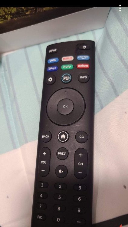

Tina Nelson Posted January 30, 2022 Posted January 30, 2022 We picked up 1/24/2022. We just tried the cable for the first time and no go. We connected the cable outside from shore to cable on outside. Our Vizio remote DOES NOT have a menu button to find cable. Is there something else we need to to do connect cable inside? We tried to find videos on the website, but couldn't find and nothing on YouTube. Any help would be appreciated.

Moderators mossemi Posted January 30, 2022 Moderators Posted January 30, 2022 Since I do not know the model number of your tv or remote, I’ll throw this out there. Mossey How do I get my Vizio TV to scan for channels? How to rescan for antenna channels on your Vizio TV Press the INPUT button on your remote to view your current input source. ... If the TV input is not selected, press INPUT until the TV input mode is selected. Open the on-screen menu and select TV or Tuner option. ... Highlight Tuner Mode and select the correct option: 1 Mike and Krunch Lutz, FL 2017 LEII #193 “the dog house”
Moderators SeaDawg Posted January 30, 2022 Moderators Posted January 30, 2022 @mossemi, I saw her post on Facebook. She doesn't have a "tv" input, which is what I use for my mom's vizio with no cable box. Her choices are "watch free," hdmi1, hdmi2, and streaming. I'd personally start with watch free, since that's likely tv. Then work my way through the hdmi choices. She has no menu button, either, but channel scan probably comes up when you change input, using the left/right, up/down functions around the ok button. At least, I would think so. I took a screenshot of her fb photo of her remote. I rarely watch TV, but I'm the designated person to fix mom's when she messes up the buttons and settings, or settings are lost in a power outage. We have a similar Samsung remote, but it does have a menu button. Too complicated. So, any of you who actually have the newer smart vizio have any suggestions for these new owners? I think @mossemi and I have probably offered what we can... for what it's worth. 2 2008 Ram 1500 4 × 4 2008 Oliver Elite, Hull #12 Florida and Western North Carolina, or wherever the truck goes.... 400 watts solar. DC compressor fridge. No inverter. 2 x 105 ah agm batteries . Life is good.

Steph and Dud B Posted January 30, 2022 Posted January 30, 2022 According to the OTT video posted above, the gear button gets her to Settings/menu. 1 1 Stephanie and Dudley from CT. 2022 LE2, Hull #1150: Eggcelsior. Tow vehicle: 2016 GMC Sierra 6.0 gas dually 4x4. Our Oliver journey: Steph and Dud B's RV Screed Where we've been RVing since 1999:
LCTraveler Posted January 31, 2022 Posted January 31, 2022 I’m going off memory but I believe it is the gear button. That will give you a display with find channels. It is definitely not the easiest remote to use. Pam TV 2018 F150 3.5 liter eco-boost with max tow package, hull #836 “LC”
