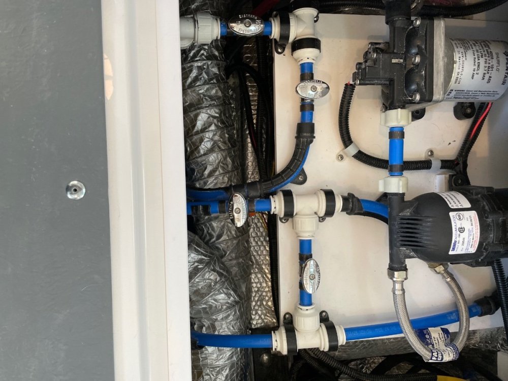

VBistro Posted April 3, 2022 Share Posted April 3, 2022 Hi there. Searched here and can’t find an answer. just dewinterized Ollie and set about doing a system sanitization after all lines were flushed of antifreeze. Here’s where we’re at: Water tank full, hot water tank bypassed, valves in normal configuration, drain valve closed. When we flip the water pump to on, it runs forever and never pressurized the system to the point where anything will run from any faucet - not even spitting g water/air. Has run for several 3-5 minute periods. Does it just need more time? (We first noticed this when the system would not pull a bleach solution into the fresh water tank while in boondocking mode, so used a hand pump to get that solution in, and then switched to normal mode, hoping that would work better. ) we’ve also attempted putting nose up and nose down to see if that could help dislodge any air in the lines, all to no avail. any suggestions? photo, just because MaryBeth Boulder, CO 2022 Elite II #953 TV: 2021 Ford Expedition Max Platinum, Max Tow Package Link to comment Share on other sites More sharing options...
VBistro Posted April 3, 2022 Author Share Posted April 3, 2022 1 minute ago, VBistro said: Hi there. Searched here and can’t find an answer. just dewinterized Ollie and set about doing a system sanitization after all lines were flushed of antifreeze. Here’s where we’re at: Water tank full, hot water tank bypassed, valves in normal configuration, drain valve closed. When we flip the water pump to on, it runs forever and never pressurized the system to the point where anything will run from any faucet - not even spitting g water/air. Has run for several 3-5 minute periods. Does it just need more time? (We first noticed this when the system would not pull a bleach solution into the fresh water tank while in boondocking mode, so used a hand pump to get that solution in, and then switched to normal mode, hoping that would work better. ) we’ve also attempted putting nose up and nose down to see if that could help dislodge any air in the lines, all to no avail. any suggestions? photo, just because We’ve also tried to “prime” the system by running city water through the lines before trying the pump. City water works just fine, but when we switch to the pump….nothing. we’ve also removed the inline filter at the pump, and that was totally clean. the only thing we haven’t tried is removing the pump I let and manually “filling” the pump. Mostly because of the awkward configuration - hard to reach and fill. MaryBeth Boulder, CO 2022 Elite II #953 TV: 2021 Ford Expedition Max Platinum, Max Tow Package Link to comment Share on other sites More sharing options...
John E Davies Posted April 3, 2022 Share Posted April 3, 2022 It sounds like an internal failure of the pump, like a bad one-way check valve. Try removing the inlet filter bowl, filling it with water and putting it back on. If that won't prime it, you will have to remove it and either open it up out get a replacement. One good thing, the pump is super easy to work on in an Ollie.... John Davies Spokane WA 2 SOLD 07/23 "Mouse": 2017 Legacy Elite II Two Beds, Hull Number 218, See my HOW TO threads: Tow Vehicle: 2013 Land Cruiser 200, 32” LT tires, airbags, Safari snorkel, Maggiolina Grand Tour 360 Carbon RTT. Link to comment Share on other sites More sharing options...

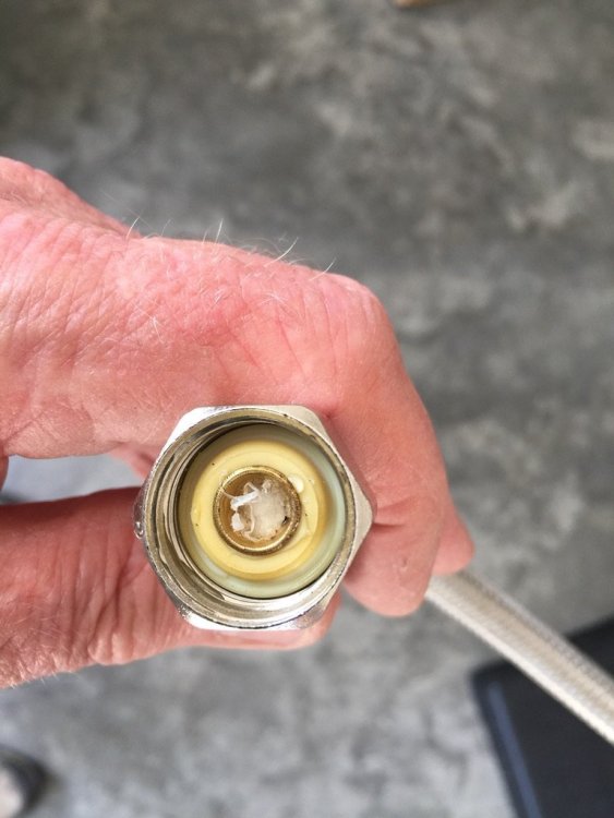

bhncb Posted April 3, 2022 Share Posted April 3, 2022 Just out of your picture at the top, there is a flex line between that tee fitting and the pump inlet strainer. Disconnect this line from the tee and check for a blockage in the end. It may be a ball of plastic shavings like this: 1 4 Link to comment Share on other sites More sharing options...
