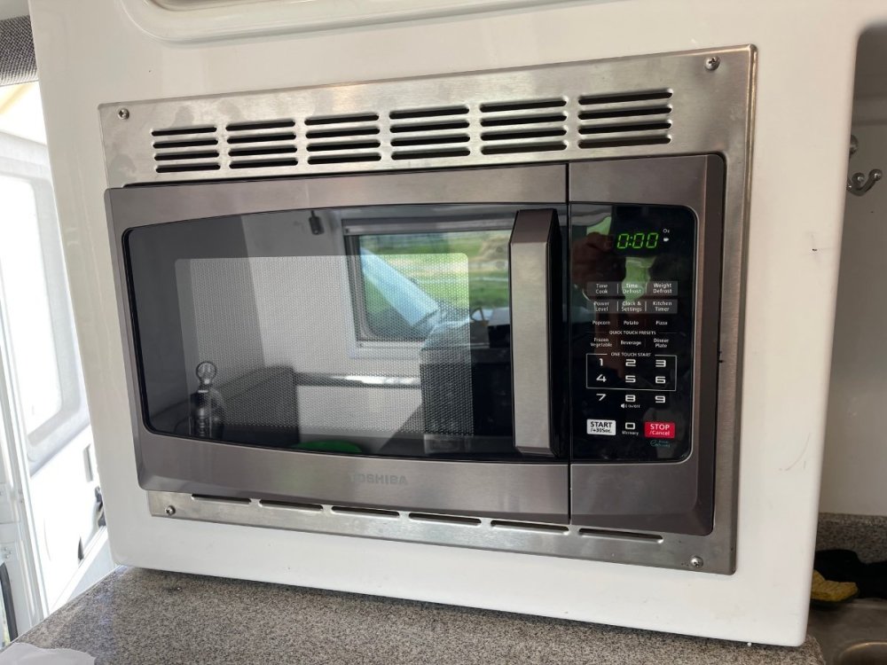

Imelda Posted May 6, 2022 Posted May 6, 2022 Help, I posted before my microwave quit working so I got a Toshiba replacement, same size, same wattage etc. The problem I have is removing the old microwave. See pic. I cannot pull the power cord plug through the over head cabinet. Anyone have any ideas? I don't want to cut the power cord (even though the microwave is not working) because I will have same the problem pushing the new microwave power cord through to the outlet in the cabinet above. I could take the cover of the microwave and disconnect the power cord and pull it through for the bad microwave and then again for the new one. Anyone got any suggestions? I wonder how did the Oliver people get the power plug through in the first place. 1
Moderators topgun2 Posted May 6, 2022 Moderators Posted May 6, 2022 WOW - you are really trying to test my memory! It has been a couple of years since I had the microwave out and in - but - as I remember it - I pulled the rubber mat out of the cabinet above the microwave, got the plug through the hole on the inside of the microwave cabinet and then gently pulling on the cord while moving the cord back and forth, I found that there was one spot that allowed me to get that plug up into the upper cabinet. Note - I did not have to force it but it was snug. In reversing the process I basically took a wire coat hanger, again through the hole in the microwave cabinet, up through the "slot", wrapped the new microwave cord and coat hanger together and brought the cord back down into the microwave cabinet. Hopefully that will get you where you need to be. Bill 4 2023 Ford F150 Lariat 3.5EB FX4 Max Towing, Max Payload, 2016 Oliver Elite II - Hull #117 "Twist" Near Asheville, NC
Imelda Posted May 6, 2022 Author Posted May 6, 2022 Thank you Bill. I finally figured it out. There was a another electrical line (black conduit) along with a yellow one running back there blocking the access hole so when lifted them both up with a screw driver I was able to wiggle power cord out and get the new microwave power cord in. see attached pic. I used a piece of string tied to the plug to pull it through. I got the new microwave in now. It's working but I haven't got the trim back on yet. Fingers crossed. 5
Imelda Posted May 7, 2022 Author Posted May 7, 2022 Success, I got the new microwave in. 😃 I replaced the High Point one with a Toshiba EM925A5A-BS That was a lot cheaper than High point. It is the same size and wattage and I was able to use the existing trim, screws etc. from the Non functioning High point. 8
