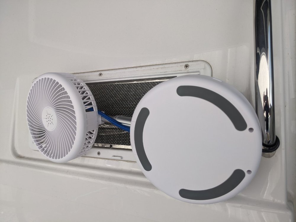

Here's my quick hack to get hot air away from the fridge. Big thanks to Katjo for turning me onto this fan from her fantastic series of videos. Love them! Anyway, the fan charges up with a USB, then runs on its own internal battery. I hung it onto the outside of the trailer with a bungee. I really felt the hot air coming out. Today it was only 90 degrees so it was just a test run for when I'm back in the desert again in 100 degree weather.

So clever! Thank you for the kind words about my videos.❤️

This modification, the Fridge Defend, seems like a complete no brainer. Seems like the sort of device that should be standard on all RV fridges. Thanks for your posts (here and elsewhere). It's definitely on my list for this fall.
