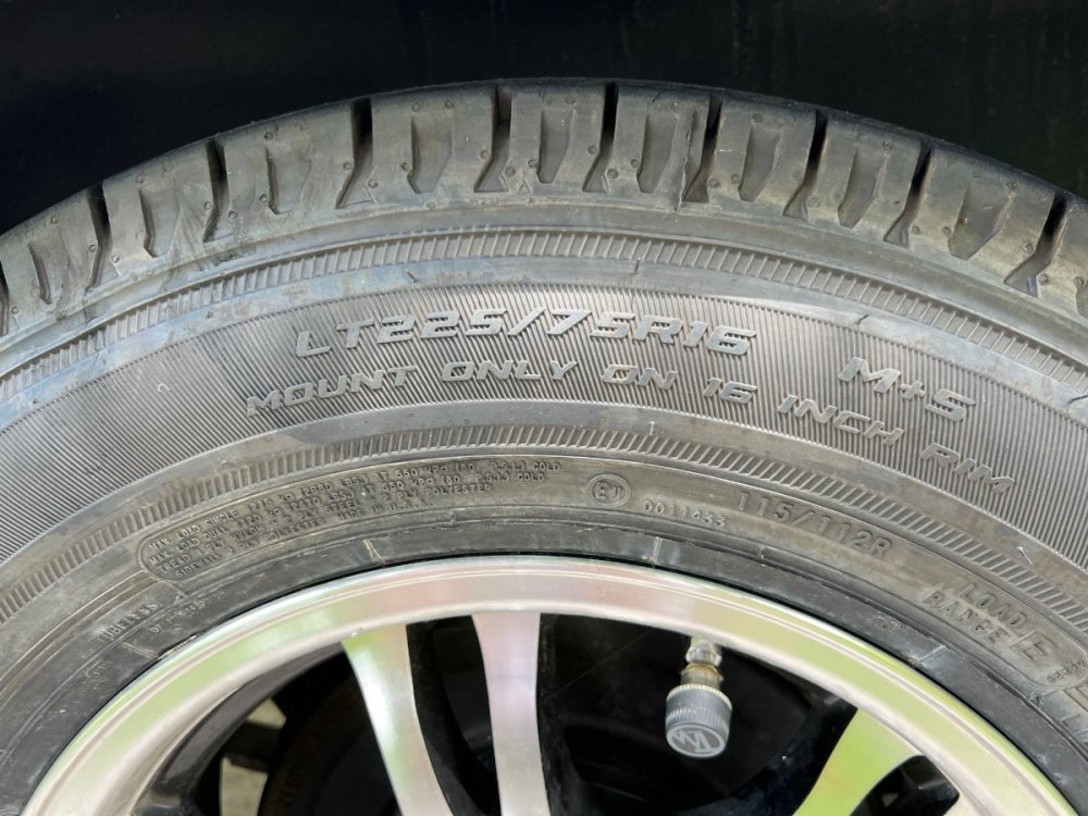

Our LEII, Hull 990, was delivered in mid-February, 2022.  It is equipped with CooperLT225 /75R16 Cooper Discoverer HT3 tires:
Also, none of the wheels & tires were balanced at delivery.  I recently took the trailer to a local Discount Tire location and had all five wheels/tires balanced and chrome steel valve stems installed on all wheels.  The cost was just $112.06, with tax.  Each wheel required a significant amount of weights to achieve dynamic balance.
On several occasions, when checking tire pressure, the cores of the original rubber valve stems would stick open, allowing air to escape.  On some of those occasions, I was able to use a pocket knife to probe the core and get it to reseat and close.  The chrome steel valve stems provide a much more substantial mount for the TireMinder TPMS sensors on each wheel.

Thanks for the info. So Oliver is using the HT3's. I guess I was wrong again.

I checked my 2021 on pickup, all 4 were balanced.   It seems some slip through.   This has come up before, Oliver will reimburse the owner for the balancing, but it’s still a hassle.  Also, just to confirm, 2019 & later are using Cooper Discoverer HT3  LT 225/75R/16 tires.
