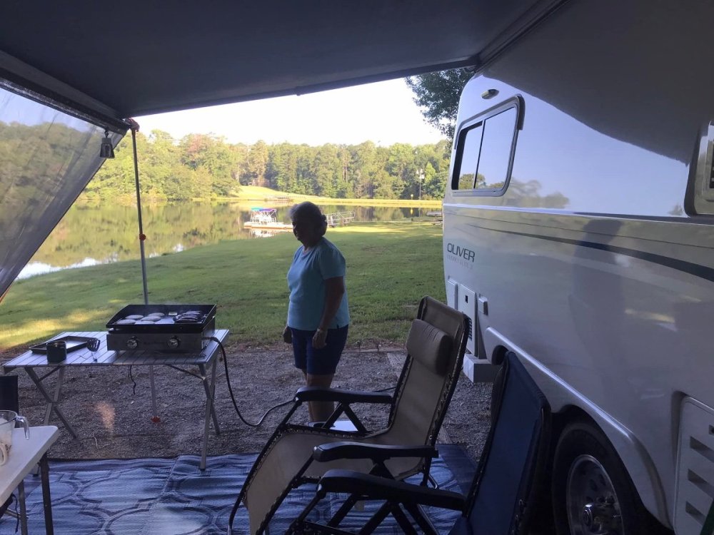

It depends.  I don’t know what awning Oliver is using right now.  My Fiamma awning has two slots that I use for my sunshade and sometimes lights.  My shade slides in very easily (short top section of 12”) then the big part zips onto the section connected to the awning.  I got my sunshade at Quartzsite at the big tent show.  There are similar shades on Amazon. I think the slot is called a Keder Rail.  You might ask your sales rep if the awnings they are using not have one.  Mike

I should add that we do have the manual Fiamma with support legs.  I can stake them down and with the sunshade staked low to moderate winds don’t create a problem.

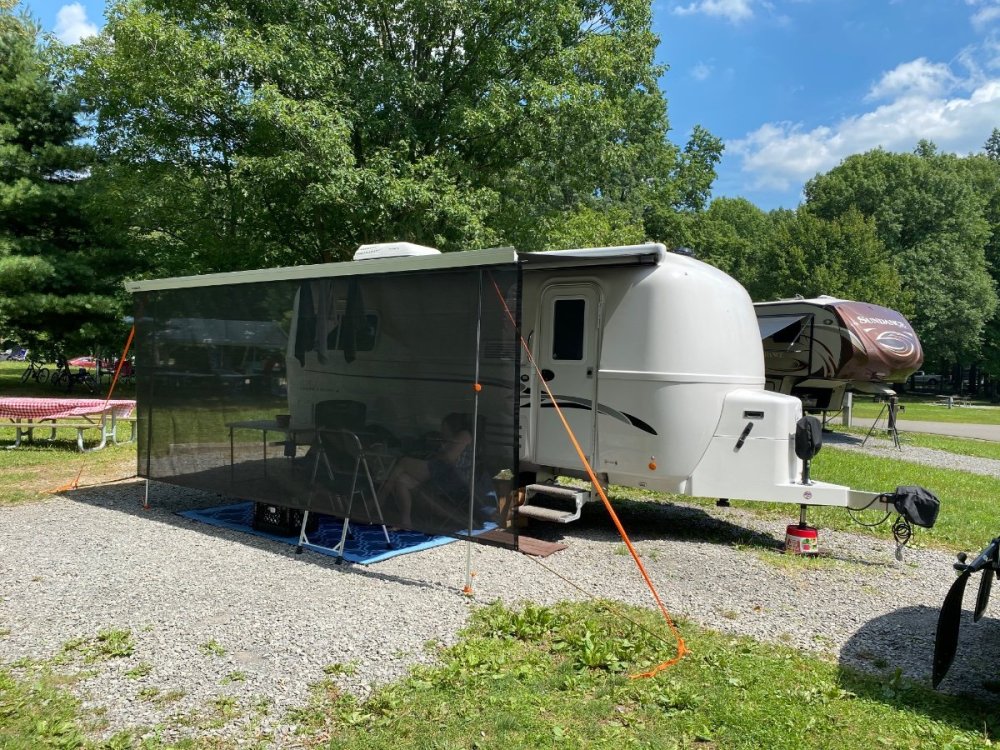

We have a shade screen but only use it on absolutely dead calm days (rarely).  We have the power Dometic awning, and as John mentioned above, you don’t want the awning trying to auto retract when the wind comes up if the awning is staked to the ground.  So when we do use the shade and have the awning staked down, I shut off the awning power at the switch on the interior cabin control panel.  And I keep a close watch on wind conditions, and take off the screen and the staked support poles at anything stronger than a mouse fart gust of wind.  The outer aluminum extrusion of the Dometic awning does have a slot running the full length that the awning rod slides into (see second photo).
