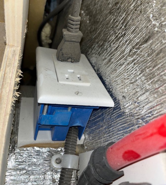

SteveCr Posted September 6, 2022 Share Posted September 6, 2022 8 minutes ago, Coach and JoJo said: How do I access the Norcold power cord? Remove the drawers? Recent LE2 .....Yes...and a cover panel on the wall. Fuses under the dinette. Are you trying to run it on DC or AC? Verify your mode setting, battery SOC etc 1 Link to comment Share on other sites More sharing options...
Rivernerd Posted September 6, 2022 Share Posted September 6, 2022 28 minutes ago, Coach and JoJo said: How do I access the Norcold power cord? Remove the drawers? Yes, remove the drawers under the galley sink. I believe the refrigerator is plugged into its own duplex receptacle in the area under the sink. The solution might be as simple as plugging the cord back into the receptacle, then replacing the drawers. That fridge receptacle is not on the same circuit as the rest of the 120V receptacles; the rest are GFCI protected, while the fridge receptacle is not. So, it is also possible that the circuit breaker for just the fridge receptacle circuit has tripped. If the fridge plug is not the issue, then I recommend you check the 120V circuit breaker panel under the front dinette seat to see if there is a tripped breaker in that circuit. Good luck! 3 Hull #1291 Central Idaho 2022 Elite II Tow Vehicle: 2019 Tundra Double Cab 4x4, 5.7L with tow package Link to comment Share on other sites More sharing options...
John E Davies Posted September 6, 2022 Share Posted September 6, 2022 Removing the drwaers is easy if you do not over-think it 😬 It is easier if they are empty of any heavy objects. https://olivertraveltrailers.com/forums/topic/6734-how-to-drawers-remove-and-reinstall-your-galley-and-end-table-drawers-fix-loose-or-stripped-screws-and-glue-the-bottoms-for-extra-strength/ The fridge power cord is at the bottom front area of the access opening between the outer hull and the back of the cabinet (after you remove its four screws). Mine looked like,this: Good luck. John Davies Spokane WA 1 4 SOLD 07/23 "Mouse": 2017 Legacy Elite II Two Beds, Hull Number 218, See my HOW TO threads: Tow Vehicle: 2013 Land Cruiser 200, 32” LT tires, airbags, Safari snorkel, Maggiolina Grand Tour 360 Carbon RTT. Link to comment Share on other sites More sharing options...
Rivernerd Posted September 6, 2022 Share Posted September 6, 2022 Many thanks to John Davies for including instructions on drawer removal, and removal of the access panel behind the drawers. The Oliver video linked below includes instructions on removal of the access panel, and shows where the fridge plugs into the receptacle behind that access panel. Legacy Elite II Drawer Removal & Components Hope this helps. 3 Hull #1291 Central Idaho 2022 Elite II Tow Vehicle: 2019 Tundra Double Cab 4x4, 5.7L with tow package Link to comment Share on other sites More sharing options...

Coach and JoJo Posted September 20, 2022 Author Share Posted September 20, 2022 PLUG had worked loose due to zip tie slipping off the plug. It had not been pulled tight. I have a 2022 Elite II. The plug is located under the wooden service panel on the bottom drawer. It is not located behind the drawers but under the drawers! 5 Link to comment Share on other sites More sharing options...
John E Davies Posted September 20, 2022 Share Posted September 20, 2022 1 hour ago, Coach and JoJo said: PLUG had worked loose due to zip tie slipping off the plug. It had not been pulled tight. I have a 2022 Elite II. The plug is located under the wooden service panel on the bottom drawer. It is not located behind the drawers but under the drawers! Do you have a picture of this new location? So it is NOT directly below the water lines? If so that is very good news. I am sorry the plug slipped out, what tire pressure are you running? Too high makes all sorts of odd things happen from shaking the hull violently. John Davies Spokane WA 4 SOLD 07/23 "Mouse": 2017 Legacy Elite II Two Beds, Hull Number 218, See my HOW TO threads: Tow Vehicle: 2013 Land Cruiser 200, 32” LT tires, airbags, Safari snorkel, Maggiolina Grand Tour 360 Carbon RTT. Link to comment Share on other sites More sharing options...
Coach and JoJo Posted September 21, 2022 Author Share Posted September 21, 2022 21 hours ago, John E Davies said: Do you have a picture of this new location? So it is NOT directly below the water lines? If so that is very good news. I am sorry the plug slipped out, what tire pressure are you running? Too high makes all sorts of odd things happen from shaking the hull violently. John Davies Spokane WA I run tires at 60 lbs. The major cause was the zip tie was not tight. The plug is located in a wooden service panel under the bottom drawer...VERY EASY ACCESS 3 Link to comment Share on other sites More sharing options...
John E Davies Posted September 21, 2022 Share Posted September 21, 2022 Thanks, I wonder when Oliver started putting it under the drawer? It is definitely a dryer spot, or at least, less likely to get soaked if a pipe fails. John Davies Spokane WA SOLD 07/23 "Mouse": 2017 Legacy Elite II Two Beds, Hull Number 218, See my HOW TO threads: Tow Vehicle: 2013 Land Cruiser 200, 32” LT tires, airbags, Safari snorkel, Maggiolina Grand Tour 360 Carbon RTT. Link to comment Share on other sites More sharing options...
