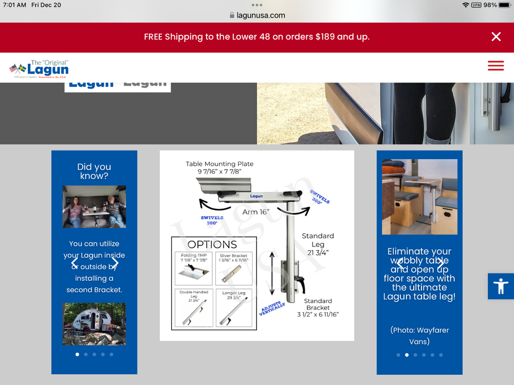

Alternatively, Oliver uses the Original Lagun table support, visit lagunusa.com for more information.
