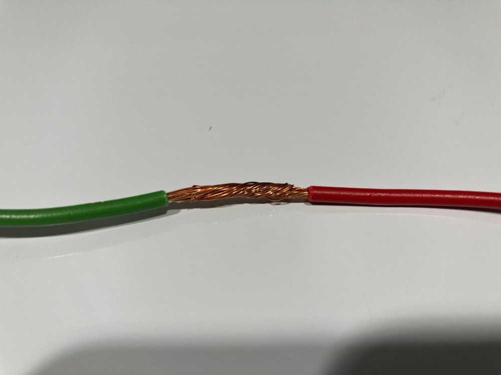

John E Davies Posted August 10, 2023 Share Posted August 10, 2023 40 minutes ago, Geronimo John said: My recollection is that the thermister changes resistance based upon temperature. The mother board of the unit is set up to interpert resistance and map it to a temperature setting and unit response. If we cut the wires to the thermister and extend them, that would change the overall resistance of the thermister and original wire resistance as seen by the mother board. Would that cause other issues? You can extend any thermostor/aka temp sensor a reasonable distance, just use HIGH quality connections (solder and heat shrink) and use an equal or heavier gauge (smaller number) wires. Then no worries - you won’t see any significant resistance increase. Especially for a sensor that has a range of 15,000 to 30000 ohms like the Zamp solar one!. Adding a few ohms to those figures is irrelevant. NO, NOPE, NO WAY: If you do anything in terms of splicing or repairing, always test the sensor before and then after the operation, in equal environmental conditions.. https://olivertraveltrailers.com/forums/topic/4205-how-to-check-your-zamp-battery-temperature-sensor-for-proper-operation/ John Davies Spokane WA 5 SOLD 07/23 "Mouse": 2017 Legacy Elite II Two Beds, Hull Number 218, See my HOW TO threads: Tow Vehicle: 2013 Land Cruiser 200, 32” LT tires, airbags, Safari snorkel, Maggiolina Grand Tour 360 Carbon RTT. Link to comment Share on other sites More sharing options...
Geronimo John Posted August 11, 2023 Share Posted August 11, 2023 On 8/10/2023 at 10:24 AM, John E Davies said: You can extend any thermostor/aka temp sensor a reasonable distance, just use HIGH quality connections (solder and heat shrink) and use an equal or heavier gauge (smaller number) wires. Then no worries - you won’t see any significant resistance increase. Especially for a sensor that has a range of 15,000 to 30000 ohms like the Zamp solar one!. Adding a few ohms to those figures is irrelevant. John D. Thank you for the above response. Great to know that there is a path forward. GJ 3 TV: 2019 F-150 SuperCrew Lariat, 3.5L EcoBoost, Max Tow, FX-4, Rear Locker OLLIE: 2018 OE2 Hull 342, Twin Bed. OLLIE DIY’s: Timken Bearings, BB LiFePO4's, Victron 712 Smart, 350 Amp Master Switch, Houghton 3400, Victron Orion DC - DC, 3000-Watt Renogy Inverter, P.D. 60-amp Converter, Frig Dual Exhaust Fans, Kitchen Drawer Straps. TV DIY’s: 2 5/16" Anderson System, Nitto recon’s, Firestone Rear Air Bags, Bilstein 5100’s, Mud Flaps & Weather Tech all, installed Ham Radio (WH6JPR). Link to comment Share on other sites More sharing options...

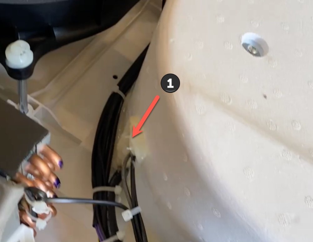

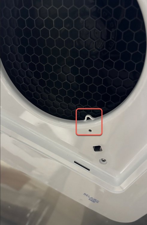

Geronimo John Posted August 11, 2023 Share Posted August 11, 2023 On 8/6/2023 at 11:51 AM, GSMBear said: Unfortunately, it's a little misleading about how to get wires from the exposed portion of the rooftop unit into the sealed portion that can be seen by looking up from the inside when the plenum is removed. GSM Bear: The thermister wires pass from the control board and then down into the Return Air path "tube" (inside the 14 X 14 roof penetration). For a non-ducted system it can be seen from the cabin with removal of the inside air distribution panel. I suspect that splicing in a long section of wire (As presented by John Davies above) at the roof penetration level in the 14 x 14 penetration would leasily give you a path between your two hulls for mounting of the sensor inside the cabin. GJ TV: 2019 F-150 SuperCrew Lariat, 3.5L EcoBoost, Max Tow, FX-4, Rear Locker OLLIE: 2018 OE2 Hull 342, Twin Bed. OLLIE DIY’s: Timken Bearings, BB LiFePO4's, Victron 712 Smart, 350 Amp Master Switch, Houghton 3400, Victron Orion DC - DC, 3000-Watt Renogy Inverter, P.D. 60-amp Converter, Frig Dual Exhaust Fans, Kitchen Drawer Straps. TV DIY’s: 2 5/16" Anderson System, Nitto recon’s, Firestone Rear Air Bags, Bilstein 5100’s, Mud Flaps & Weather Tech all, installed Ham Radio (WH6JPR). Link to comment Share on other sites More sharing options...
GSMBear Posted August 16, 2023 Share Posted August 16, 2023 On 8/11/2023 at 5:29 PM, Geronimo John said: The thermister wires pass from the control board and then down into the Return Air path "tube" (inside the 14 X 14 roof penetration). For a non-ducted system it can be seen from the cabin with removal of the inside air distribution panel. Yes, but. . . I have seen the thermistor by looking up into the return air duct after removing the inside plenum. There's a short section of wire that leads to an exit path on the STREET side of the unit. And you would think this would exit into the rooftop section on the STREET side making a replacement a simple task. However, my experience is this: From on top of the roof, the lead wire from the control board enters the protected/sealed area under the Styrofoam on the CURB side of the unit. From there, it appears to travel to the STREET side of the unit in a way that I think can only be accessed by unsealing the Styrofoam and removing it. A task I'm not keen on doing. When I attempted to feed a new thermistor into the access hole on the STREET side of the rooftop unit, it never appeared on the inside when looking up into the return air duct. Where that lead wire went, I have no idea. I'm guessing it got all bunched up on something. (If someone else has done this, I wanna hear from you!) In the attached pictures, marker #1 is the entry path to the sealed area on the CURB side while marker #2 is an entry path on the STREET side. My findings might be wrong, and I hope they are. But I gave up on the task because the unit is new and apart from the roughly 4 degree temperature change for cycling, I have it working well. I'm definitely in agreement with John's remarks about soldering an equivalent gauge wire to the thermistor to extend it. The problem is, without the ability to easily feed the wire from the rooftop section to the interior section (the issue described above), there isn't enough slack wire to get it to an easily workable area with a soldering iron. It's pretty tight quarters up in the return air duct. My brother has some experience with this and I'm planning to wait for a return visit from him to explore it more. 3 Link to comment Share on other sites More sharing options...
Geronimo John Posted August 21, 2023 Share Posted August 21, 2023 On 8/16/2023 at 5:34 AM, GSMBear said: I'm definitely in agreement with John's remarks about soldering an equivalent gauge wire to the thermistor to extend it. The problem is, without the ability to easily feed the wire from the rooftop section to the interior section (the issue described above), there isn't enough slack wire to get it to an easily workable area with a soldering iron. It's pretty tight quarters up in the return air duct First my assumption is that we are using the former Dometic thermostat wires to control the gas heater and have done so using a new thermostat at the location of the old Domet stat. That said: Your assessment matches what I observed. That path is not worth the effort. HOWEVER: I believe that the thermistor wires end up at the control board. My suggestion is to disconnect or intercept them at the control board and then connect a new one (with a much longer lead) in its place and locate the new thermistor in a place that better represents the cabin temperature. GJ 1 TV: 2019 F-150 SuperCrew Lariat, 3.5L EcoBoost, Max Tow, FX-4, Rear Locker OLLIE: 2018 OE2 Hull 342, Twin Bed. OLLIE DIY’s: Timken Bearings, BB LiFePO4's, Victron 712 Smart, 350 Amp Master Switch, Houghton 3400, Victron Orion DC - DC, 3000-Watt Renogy Inverter, P.D. 60-amp Converter, Frig Dual Exhaust Fans, Kitchen Drawer Straps. TV DIY’s: 2 5/16" Anderson System, Nitto recon’s, Firestone Rear Air Bags, Bilstein 5100’s, Mud Flaps & Weather Tech all, installed Ham Radio (WH6JPR). Link to comment Share on other sites More sharing options...
GSMBear Posted August 21, 2023 Share Posted August 21, 2023 6 hours ago, Geronimo John said: I believe that the thermistor wires end up at the control board. My suggestion is to disconnect or intercept them at the control board and then connect a new one (with a much longer lead) in its place and locate the new thermistor in a place that better represents the cabin temperature. Hi John -- yes, the thermistor wires end up on a 2-pin connector on the control board on the curb side of the rooftop unit. The problem is getting a replacement thermistor wire from the outdoor/exposed area of the rooftop unit into the interior/sealed section that is accessible from inside the RV looking up into the unit after removing the ceiling plenum. In the pictures from the post directly above, the thermistor wire goes from the control board and enters the sealed Styrofoam area at marker #1. However -- and this is the part to really understand -- that thermistor wire does not appear anywhere from inside the RV looking up until it comes out of the area by marker #2. How that wire gets through the sealed area from marker #1 to maker #2 (on the inside) is not clear to me. I think I would have to unseal the Styrofoam section to see and follow that path and I'm not keen on doing that. I already have a new thermistor and I tried feeding it through the entry point at marker #2 and it never showed up inside the RV. Where it went, I don't know. But I'm not convinced that's the path to use. To make matters worse, there appears to be some cable ties (a reflection of a good quality build, IMO) that would prevent me from splicing wire from the outdoor rooftop side (where I have good access and can use a soldering iron easily) and gently pulling it though whatever path it takes. So it's a bit of a pickle, to say the least. Link to comment Share on other sites More sharing options...

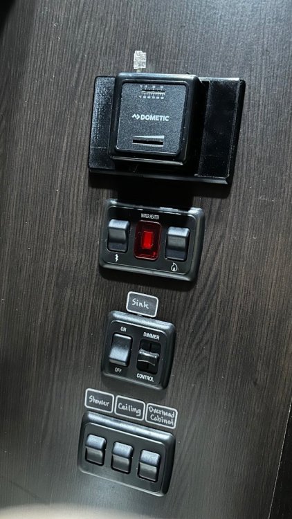

GSMBear Posted August 24, 2023 Share Posted August 24, 2023 4 hours ago, John E Davies said: Do NOT use a mechanical thermostat, they are horrible and you will hate it! I hear ya! I have my expectations set very low for the mechanical thermostat but it's already purchased with a custom 3D printed backer plate to cover the factory holes from the Dometic CCC2. I will only need to use this when the temps get low enough that I need heat around the holding tanks. Apart from that, I'll use the heat pump or an electric space heater. 3 Link to comment Share on other sites More sharing options...

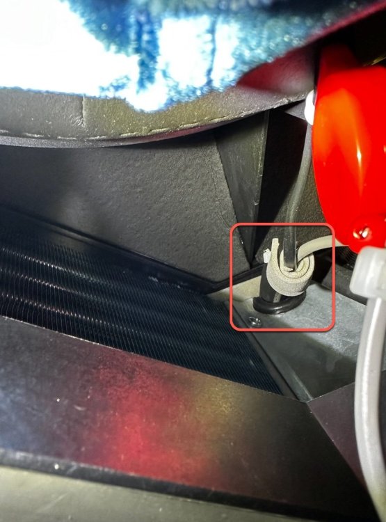

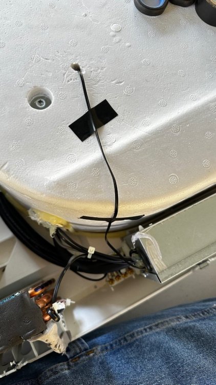

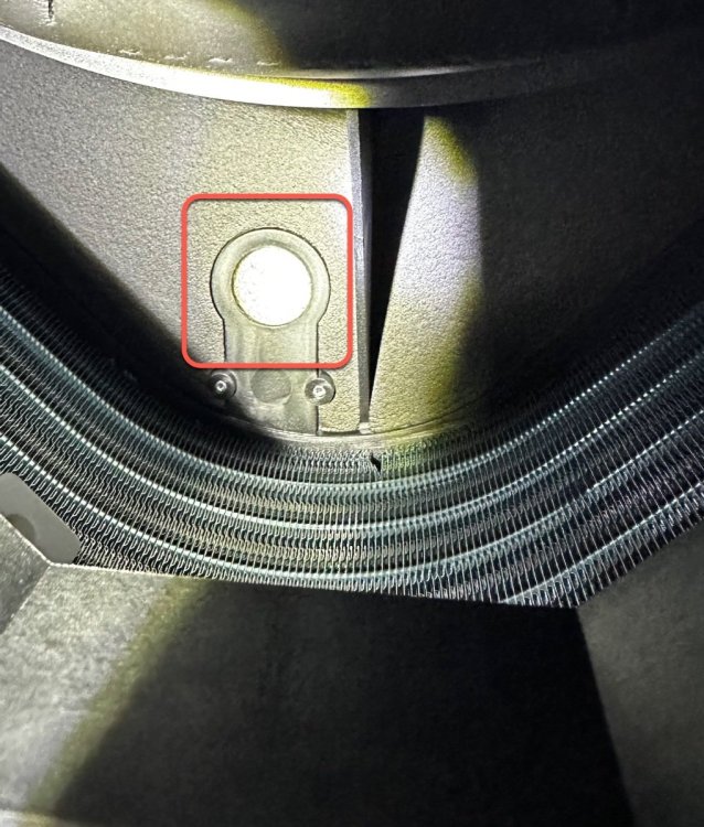

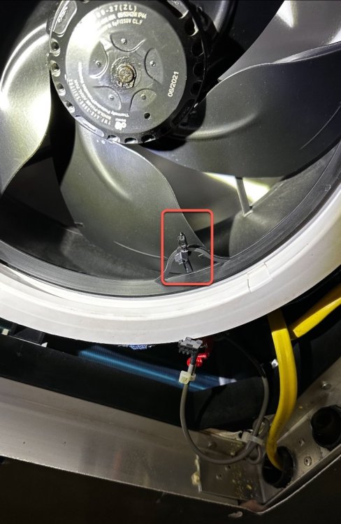

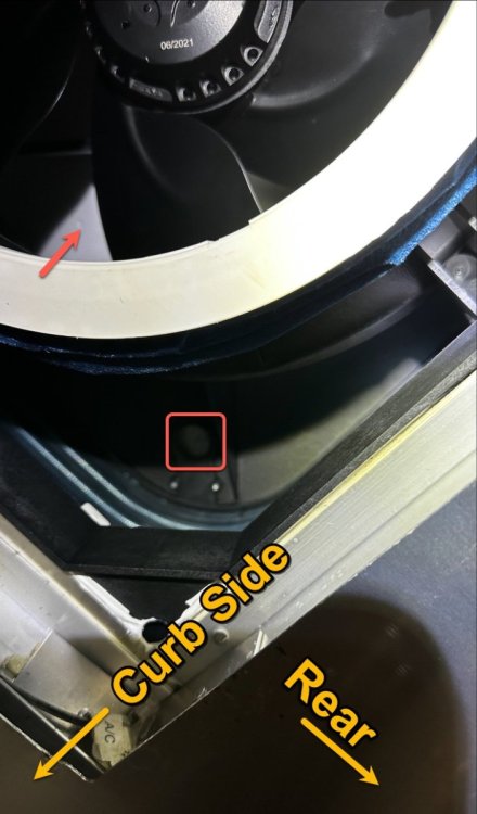

GSMBear Posted October 22, 2023 Share Posted October 22, 2023 Yes, the continuing saga of finding a way to add and relocate the temperature sensor to the Houghton/RecPro A3400 AC/Heat Pump. Some backstory: with engineering assistance from my brother, we added a relay to the interior fan so that it cycles with the compressor. This made a substantial improvement in the interior humidity issue while in AC mode with the manufacturer’s design. In fact, I’d say it eliminated the problem. But this solution introduced a new problem: Since cabin air isn’t constantly flowing over the temperature sensor mounted in the round return air chamber, there is an increased disparity in real cabin temperature versus the temperature observed by the sensor. This prevents a steady and comfortable cabin temperature. Relocating the temperature sensor to an external location away from direct air flow of the distribution box might solve this problem. But finding a path from the rooftop control board location to the interior cabin space has been a problem. And the existing sensor has no apparent slack in the wire as a means of extending it. Nor do I want to cut it. I removed the air distribution box today to examine the situation again and I think I might have found a path from the rooftop control board to the interior sealed area without breaching the seal — at least not much, anyway. The attached pictures, in order, show the (1) current location of the temperature sensor, (2) enter/exit path of the wires from the rooftop section to the interior section. I’m unable to get a wire pushed through this area to the visible area in the rooftop unit. I can get a wire to go a short distance through this area but it hits something and just bunches up. The situation is the same when approaching this from the rooftop side. The new idea is to make use of this thing (3) — whatever it is. I can poke my finger through the white covered hole in the middle. Another inch or two above that is the interior side of the white Styrofoam insulation that seals the interior system from the exterior system. I’m definitely opposed to removing this cover as it appears to be very well sealed by the manufacturer and I don’t want to disturb it. But I’m not too opposed to poking a very small diameter hole in it with a hot coat hanger or something similar. Any air gap around the new wire could be caulked and sealed. Picture (4) is poorly focused but it shows the access point inside the red square while the arrow points to the white Styrofoam box that seals the system. A small access hole melted into the foam straight up from the access point should lead right to the same corner in the rooftop section where the control board is. From there, I’d disconnect the factory sensor and add the new sensor with plenty of cable length. I’d then route the sensor through the attic space of my Airstream RV and out to the original location of the Dometic CCC2 thermostat that is no longer in the equation. (I’m not sure how complicated this part gets with an Oliver.) It might be a while before I actually tackle this. I’m interested in hearing from all y’all about what it is I might be missing though! (And, when I put the air distribution box back together, did I spot (5) the location of the temperature sensor in the version 1 model of this unit which would have placed it closer to the interior cabin air?) Link to comment Share on other sites More sharing options...
GSMBear Posted October 22, 2023 Share Posted October 22, 2023 Well, I just couldn’t stand it and had to give it a try. The access method described above worked as expected. The new thermistor, not so much. I’m disappointed, for sure. For testing, I just dangled the new thermistor directly down from the air distribution box which is centrally located in my RV. The thermistor was about waist level. In AC mode, it seemed to be a pretty good solution although I did not spend much time in this mode. The compressor did come on as expected and seemed to turn off much closer to the set point when measured by an external inexpensive indoor/outdoor thermometer at countertop level. In heat mode, the fan would never come on. I could hear the compressor turn on as well as the fan in the rooftop unit, but the interior fan that blows the warm air never came on. Heat was occurring in the coils because when I switched it from heat to fan-only mode, the fan did come on and the residual heat from the heat mode allowed for some warm air to come out. This puzzles me and I can’t help but wonder if the prior fan modification is in the equation somehow. That mod is described upstream in this thread. Prior to the new thermistor, I did notice a change in the fan behavior between AC and Heat modes: In AC mode, the fan cycles with the compressor only when the fan is in Auto mode. It remains on all the time if the fan is switched to medium or high mode (can’t recall about low speed). However, in Heat mode, the fan will cycle with the compressor no matter what speed the fan is set to, including auto. After the new thermistor, the fan would not come on at all no matter what fan setting I used. I returned the setup to what it was before I tinkered with it today and it’s back to running as expected in both AC and Heat modes. HVAC and resistors are by no means my area of expertise. I’d be interested to hear from those who know more on these subjects. For the record, the replacement thermistor I bought is a 10K NTC thermistor. That means absolutely nothing to me but there are gobs of these on Amazon with this specification and advertised as being suitable for mini-split systems which do both AC and heat. So I figured I’d start there. I can’t find any specs on the one Houghton uses. 2 1 Link to comment Share on other sites More sharing options...
katanapilot Posted October 22, 2023 Share Posted October 22, 2023 (edited) Wonder if the thermistor located in the unit needs to sense the warm air being generated by the heat pump before it will turn on the fan? I know when using the heat pump, the compressor runs for a bit before the fan turns on. By relocating the thermistor externally, you may have defeated the heat pumps ability to sense when warm air is being produced. Just a WAG. Edited October 22, 2023 by katanapilot added text for clarification 1 1 2020 Elite II Hull #628, Houghton Heat Pump, Victron install in progress... TV - 2011 Toyota Tundra Crew Max Platinum 4WD, Magnuson Supercharger, OME suspension Link to comment Share on other sites More sharing options...
GSMBear Posted October 23, 2023 Share Posted October 23, 2023 Ah, methinks you're onto something! Your remark about the heat pump not sensing that warmth is being produced made me look at the wiring diagram. I'm now pretty sure that I mistakenly unplugged the interior coil sensor instead of the room sensor. I know it was a yellow connector and the attached picture of the control board positions this one in the location of the interior coil sensor according to the schematic. This adds up! Without the interior coil sensor connected, the fan would continuously wait for the signal that the coils are warm enough to start blowing -- so the fan would never start! OK, so stupid mistake on my part but there's hope left. I will give it another try next weekend and report back. 1 Link to comment Share on other sites More sharing options...
