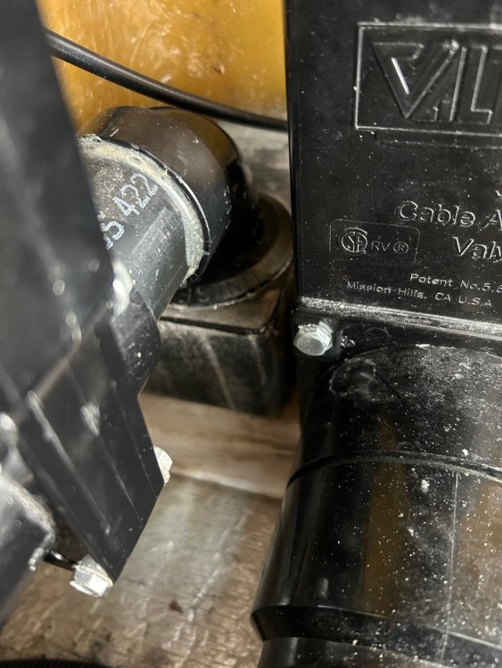

I cleaned the area on top of the tank, the rubber ring and the drain pipe end then mixed some epoxy and…, well it won’t be popping out anymore.
I neglected to take pictures, I was still on my first cup of coffee and was intent on getting it fixed.  I took one after I was done.

Here is the drain pipe epoxied to the rubber ring which is epoxied to the top of the gray tank.

UPDATE:  I opened a ticket with service and was told that the drain pipe is just inserted into the rubber grommet with no adhesive.  I asked if there were any issues with my repair (epoxy both the grommet and pipe to the tank) and was told there were no issues that they were aware of.
It might be a good periodic check to look under the dinette seat and ensure that the drain pipe is seated tightly into the rubber grommet on top of the gray tank.  Or, it looks like you could make a more permanent seal like I ended up doing.
I will say that it took about 90,000 miles and just under 7 years for my drain pipe to dislocate itself.  Mike
Mike, as you've evidently discovered, the drain pipe is indeed only a friction attachment. I agree that no harm was done with adding a little epoxy. My guess that in all the excitement of hitting the deer and probably then slamming on the brakes, the weight of the gray water inside the tank was enough to cause a slight shifting of the gray tank forward thereby dislodging the drain pipe from the top of the tank. The tanks are not strapped down. If they were it would be incredibly difficult to remove one out the rear bumper.
