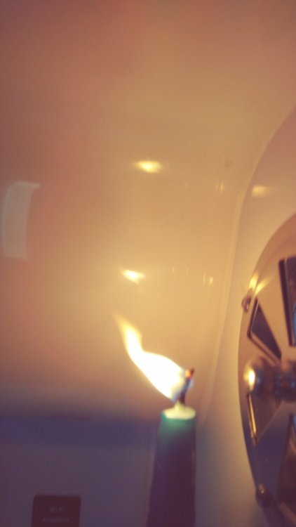

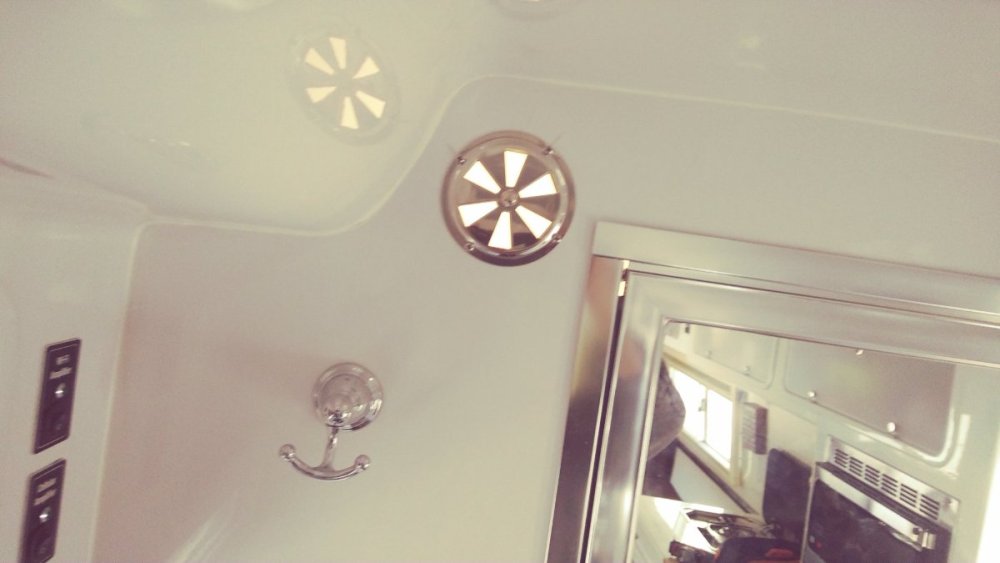

Mainiac Posted December 13, 2022 Posted December 13, 2022 A back awhile ago we installed a vent high up in the bathroom wall. We installed it up there so no shower water could get to it. It improved to air flow greatly from the bathroom register as there was no way for the air to get to the return vent, with the door closed. As you can see from the candle flame the air moves freely now. A bonus was that the bathroom vent no longer had to struggle to get air to vent if the window was closed. We do have the heat register under the standard vent almost completely closed... 2

Hokieman Posted December 13, 2022 Author Posted December 13, 2022 2 hours ago, Mainiac said: A back awhile ago we installed a vent high up in the bathroom wall. Yes I recall you posting this mod, and I like it, it’s on my potential mods list. In our case, a vent would be redundant most of the time, as the door is usually propped open except when we are in there. We have 2 Labrador Retrievers and their water bowl is kept in the shower pan as they are sloppy drinkers. We use a micro fiber towel to wipe up after them before we go in there. “Ramble” - 2021 Legacy Elite II #797; 2020 Ford F-250. Former owner of 2019 Oliver Legacy Elite #431. Blairsville, GA
