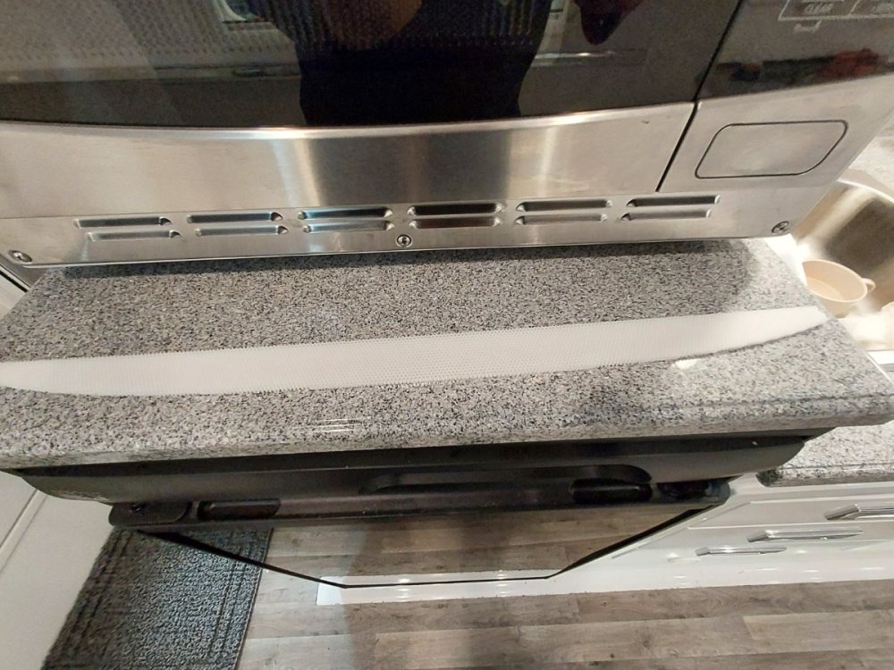

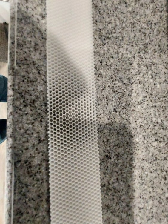

That said, attached are three photos showing:  (1) one of the two filters removed from our Truma Aventa air conditioner on the countertop above the fridge; (2) a close-up of the filter, so you can see the plastic honeycomb and (3) me washing a filter in our home kitchen sink.
Silly me for thinking they could be washed instead of replaced for $$$$$$$$$$$$$$$!978806321_TrumaACFilteronCountertop.thumb.jpg.8ae65a79e4a0a612019d66a01527eb87.jpg
2116549640_WashingTrumaACFilterinKitchenSink.thumb.jpg.a07237aa8f3721f20c169ff0dbe94331.jpg

17 minutes ago, Rivernerd said:
Who am I to dispute what Truma says about its products?
Looks like I will be washing our new Truma filter's.
Thanks for posting.
